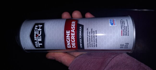

So my upper radiator hose completely blocks the belt area I want clean. So it needs to be removed. How much do I let the engine warm up and still be able to safely remove this hose? Should I let engine heat up with the radiator cap off so pressure doesn't build up making so I can't remove the hose? What would you suggest as a work around? I already have 3 cans of store brand engine degreaser. Will these work or are they safe for my application?

is this OK?

You should be able to wash around the hose without a problem. Water will wrap around it and rinse the oil off. I don't remove parts if at all possible.
