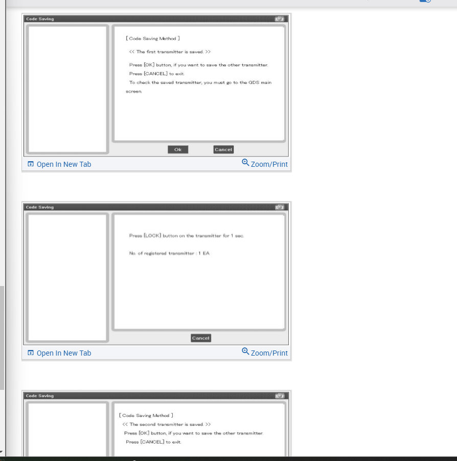

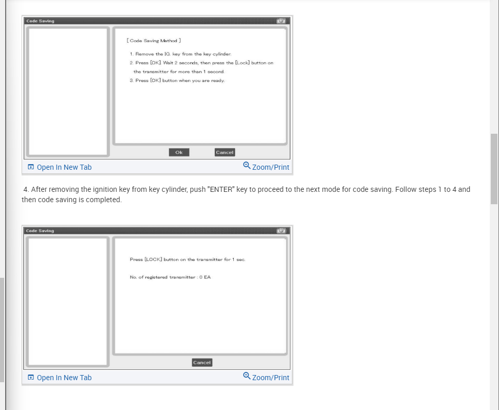

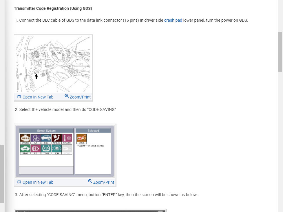

Unfortunately, we don't offer telephone services, only online assistance. It appears these fobs need to be programmed using a scan tool.
That is why it says on the listing that they have to be programmed by a dealer or locksmith.
It appears Kia does not have the same programming process as others and that is detailed in this guide:
https://www.2carpros.com/articles/how-to-re-program-a-key-remote-fob
I am attaching the procedure from the manual but as you can see, there is a scan tool needed because you have to register the code for the transmitter using this tool or an equivalent.
As for the operation of these specific FOBs it appears they will work with your vehicle but clearly, we don't sell them so I can't guarantee their operation.
Let me know what questions you have.

Sorry James. Just trying to assist you with the info that you would need. However, we don't have the ability to do this for you. We can only empower you with the info that you need to accomplish it and in this case that is to have a scan tool capable of doing the process I attached, or contact someone that can do this (locksmith, dealer).
You will have to locate a locksmith in your area that is capable of doing this for you. I would simply do a Google search in your area for locksmiths and call them to find out if they are capable of programming them for you.
Please let us know how you make out. Thanks
