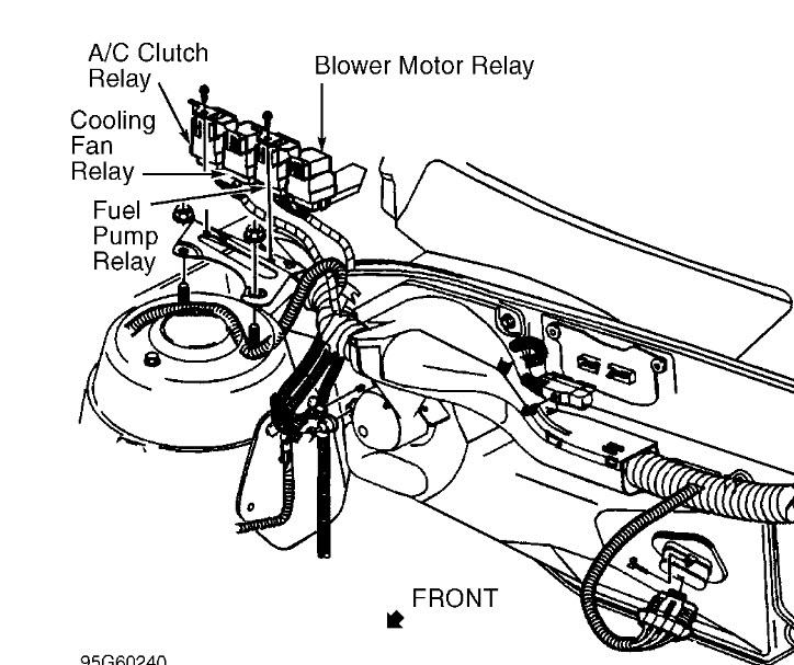

I need to know where my fans Plug-ins are located
1997 OLDSMOBILE CUTLASS
160,000 MILES
DANILYNN209
  • 7 POSTS
There's a flag hanging that goes to my cooling fans because it's not and coming on so my car will overheat if it's sitting in an Idol and I can see the plug but I do not know where it plugs in it I need a picture Just let you know I'm a female so I'm not a mechanic Thank you so much for any help

the fan may be bad is why it s disconnected so if it still doesn't work after plug in in then check fuse in underhood box and relay they will both be marked. we dont' have a picture but look on the two round things behind fan for the same type of plug in it will be there. fan relay pic enclosed.
