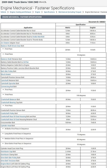

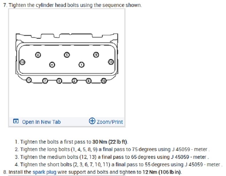

I need to know the tightening sequence for my cylinder head bolts?
2009 GMC SIERRA
200,000 MILES • 4.3L • V6 • 2WD • AUTOMATIC
SAMPLES98
I can’t find the tightening sequence for my specific make and model anywhere online. My engine has 13 bolts per head.

Let me know if you can't read the numbers in the fourth image. You can copy and paste it into a typing program such as MS Word, where it can be expanded, or I can put some larger callouts on it for you.
The special tool they're referring to is: J 45059 - Angle Meter. You may be able to borrow a comparable tool from an auto parts store that rents or borrows tools. Let me know if you don't know what they're referring to for the procedure.
