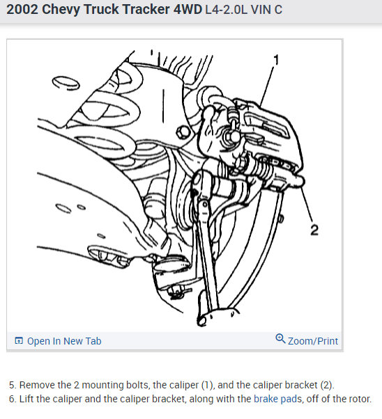

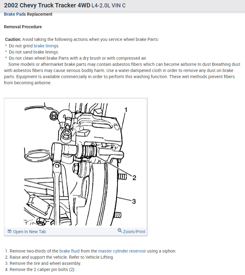

I need to know how to replace front brakes and rotors
2002 CHEVROLET TRACKER
175,000 MILES • 2.0L • 4 CYL • 4WD • AUTOMATIC
LAURIEED2002
MEMBER
1 POST
Do you have a video on how to change the pads and rotors on my vehicle? I appreciate your help and look forward to hearing from you soon.
Jun 23, 2014 at 11:43 AM
SQM
Experienced Mechanic
6,383 POSTS

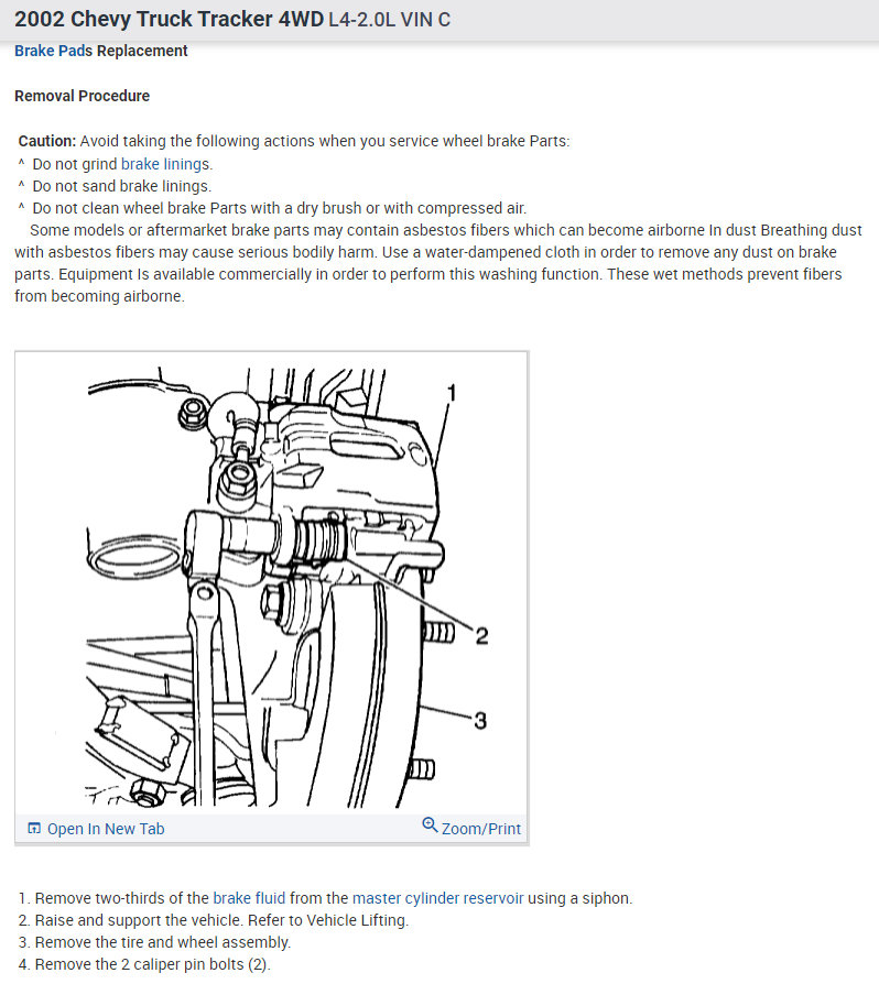

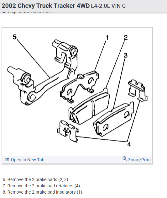

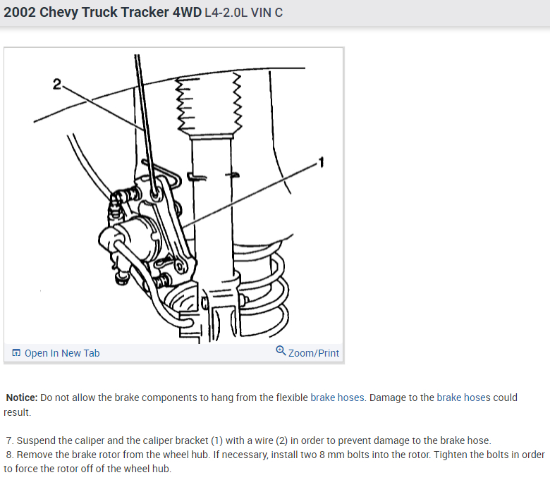

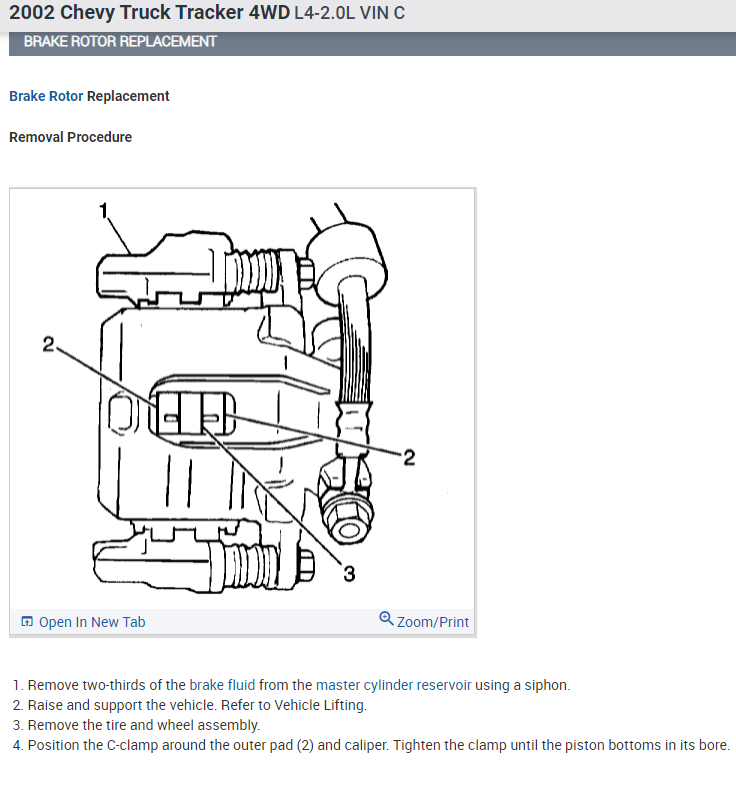

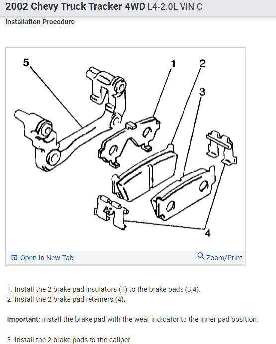

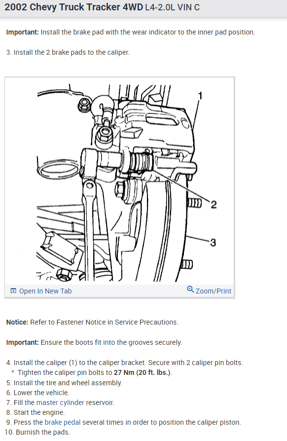

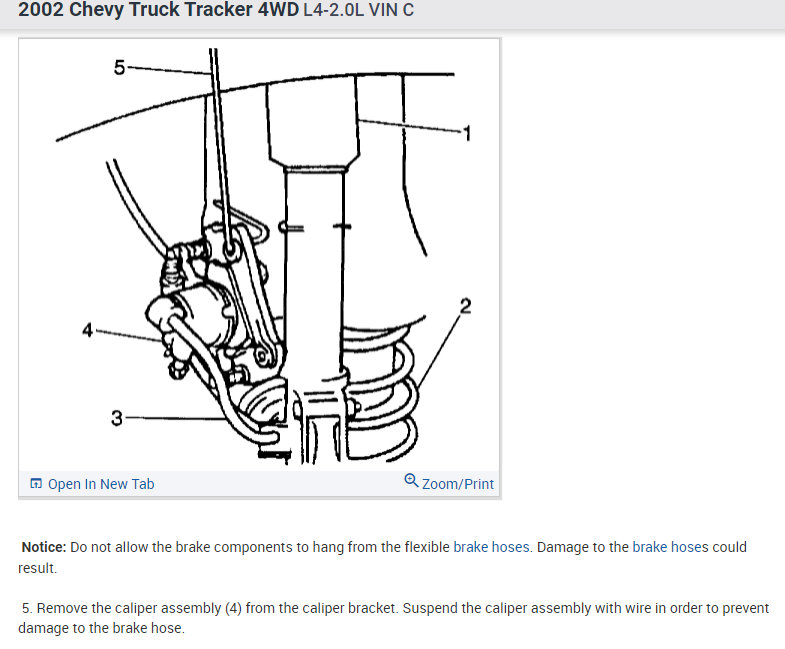

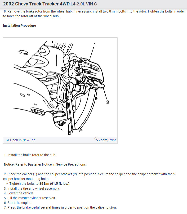

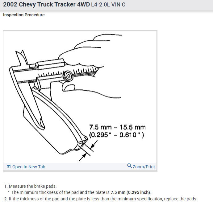

The brake pads and rotors can be replaced on this vehicle quite easily and in a relatively short period of time depending on your comfort level.
Here is a helpful vide on a typical brake replacement:
https://youtu.be/PAjUx1Rct4Q
I have attached the brake pads and rotors replacement procedure below.
