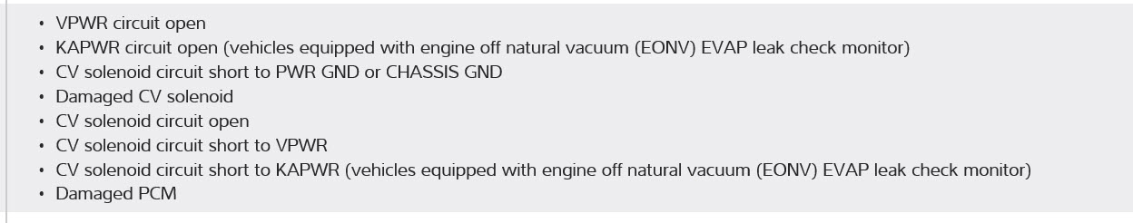

Good day,
My car has chassis number of (2FMDK36C17BA99379)
I scanned the car and I got an error of P0446,
Please, what is the meaning of this code and what part do I buy to fix this issue?
I will be waiting for your quick response,
Regards,
Tola
Aug 31, 2016 at 11:55 PM
HMAC300
  • 48,601 POSTS
this can be many things with the a lot of the problems being a wiring issue with different wires and connectors. see picture I do not think this will be a certain replace a part to fix this.
