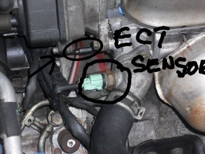

Can anyone help me identify this part? Borrowed a picture from someone else so I am not trying to identify the ECT sensor, but the other item circled.

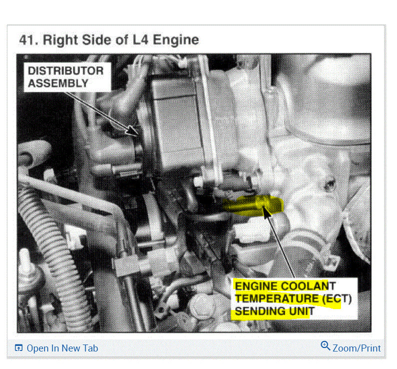

The smaller one in the rear is the ECT for the computer (see Pic 1). The larger one with a light blue connector is also a temperature sensor. That one is the cooling fan temperature switch. It is what is used to signal when the cooling fan needs to be turned on.
