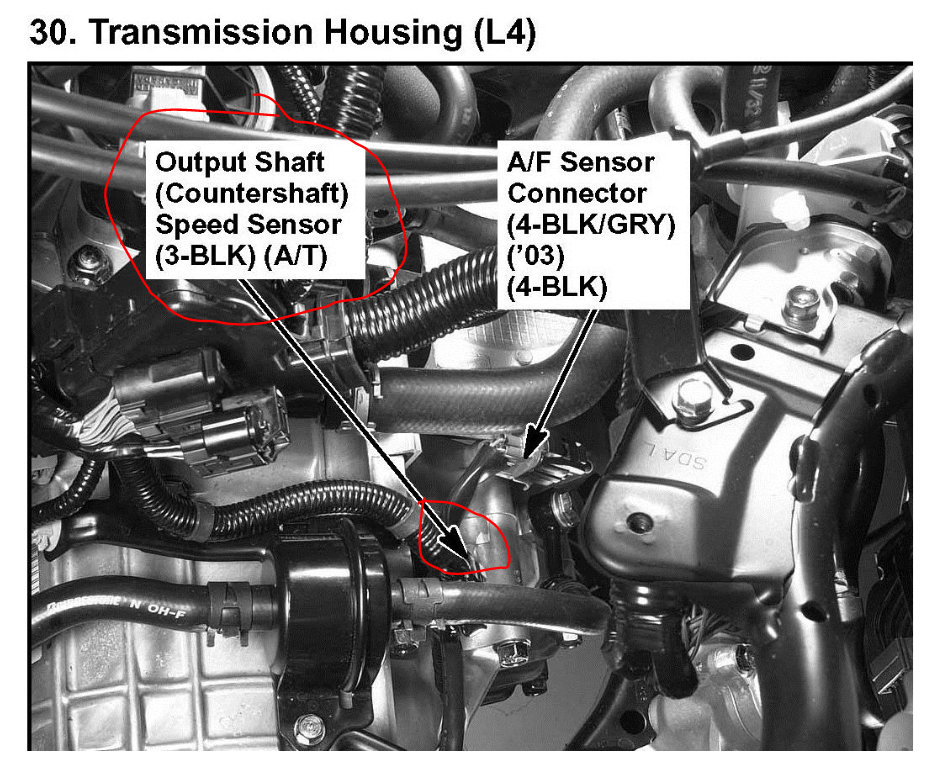

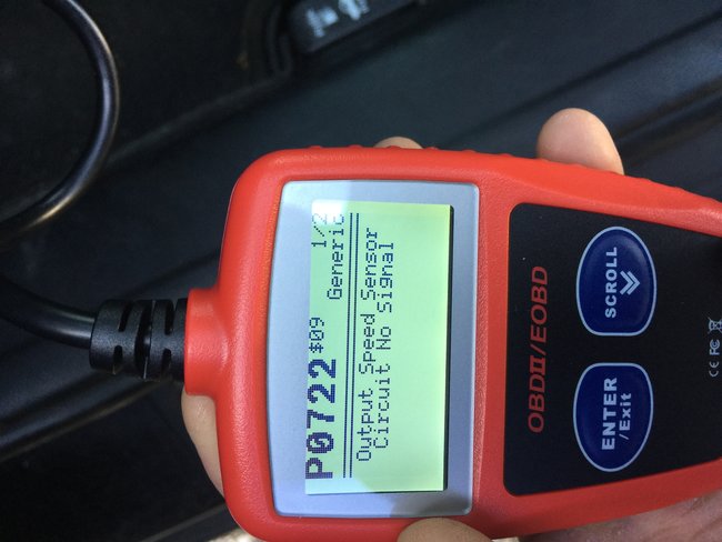

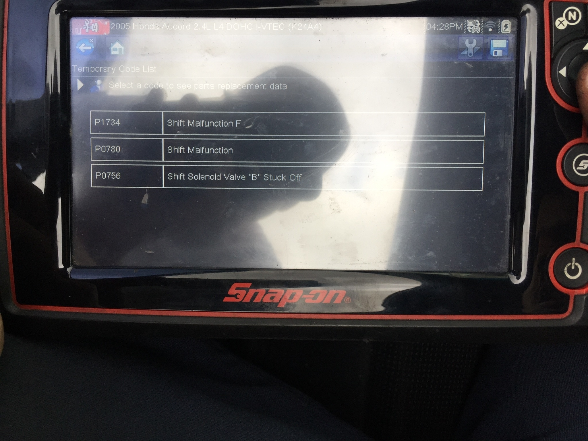

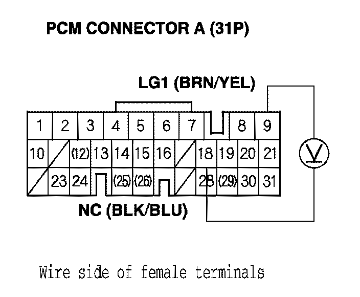

I first received a code of P1734, P0780, and P0756. So I went ahead and changed the shift solenoid valve B. And it ran for a little bit but when I got to around 35mph it wouldn’t go past and when I stopped it wouldn’t accelerate anymore. So I ran the code reader again but now all I’m getting is code P0722. So now I need to locate where my output speed sensor is so I can try to replace that and hopefully this time it will run. Thank you

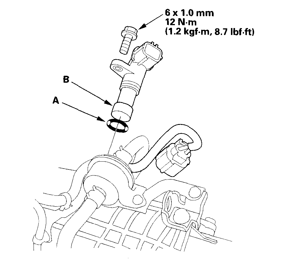

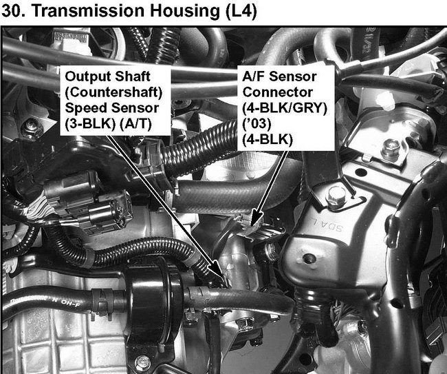

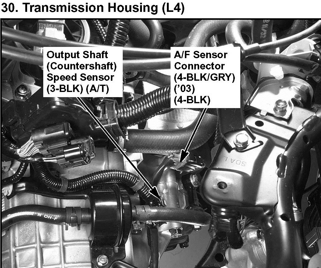

If you look at pic 1, it shows location. Here are the directions for removal and replacement. Pic 2 correlates with these directions.
2005 Honda Accord L4-2.4L
Output Shaft (Countershaft) Speed Sensor Replacement
Vehicle Powertrain Management Transmission Control Systems Sensors and Switches - Transmission and Drivetrain Sensors and Switches - A/T Transmission Speed Sensor Service and Repair Procedures Output Shaft (Countershaft) Speed Sensor Replacement
OUTPUT SHAFT (COUNTERSHAFT) SPEED SENSOR REPLACEMENT
pic 2
1. Disconnect the output shaft (countershaft) speed sensor connector, and remove the output shaft (countershaft) speed sensor.
2. Install the new O-ring (A) on the new output shaft (countershaft) speed sensor (B), then install the output shaft (countershaft) speed sensor in the transmission housing.
3. Check the connector for rust, dirt, or oil, and clean if necessary, then connect the connector securely.

I am going to add the diagnostics for the code you have. It is extensive, but thought I would add it in case you would rather check before replacing the sensor. The remaining pics correlate with these steps.

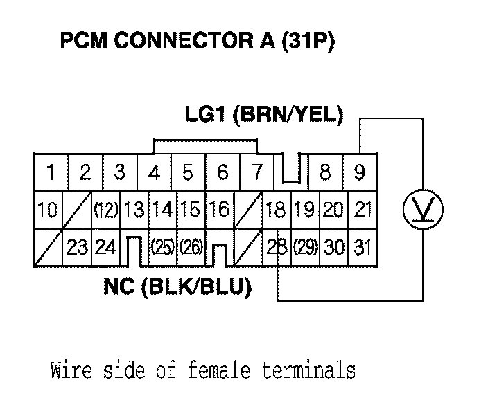

8. Jump the SCS line with the HDS.

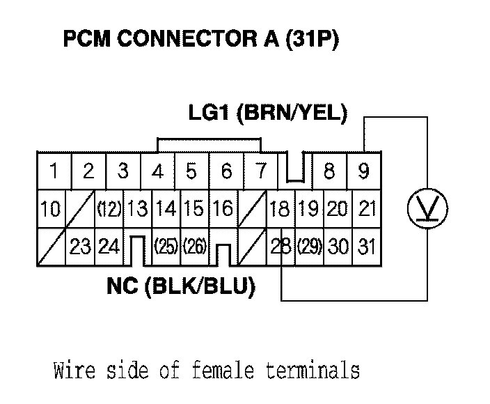

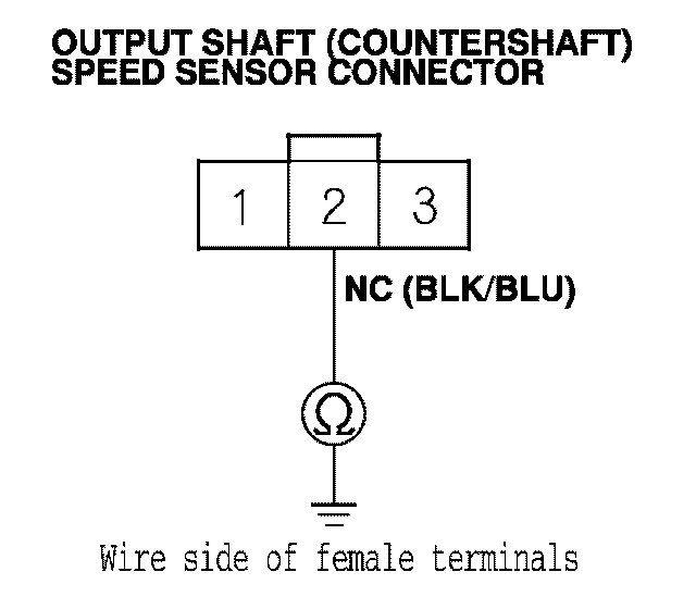

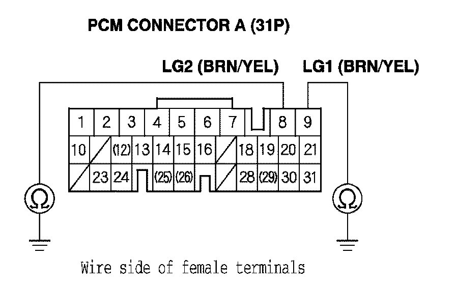

9. Disconnect PCM connector A (31P) and the output shaft (countershaft) speed sensor connector.
10. Check for continuity between PCM connector terminal A8 and body ground, and between PCM connector terminal A9 and body ground.
Is there continuity?
YES - Go to step 11.
NO - Repair open in the wires between PCM connector terminals A8, A9, and ground (G101), or repair poor ground (G101), then go to step 31.

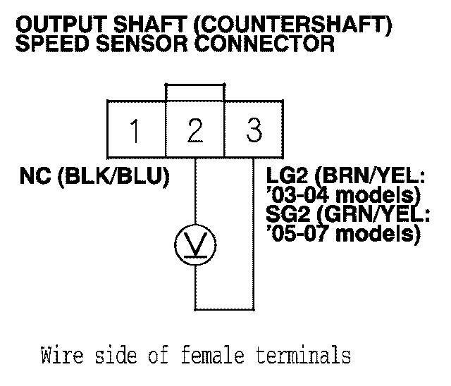

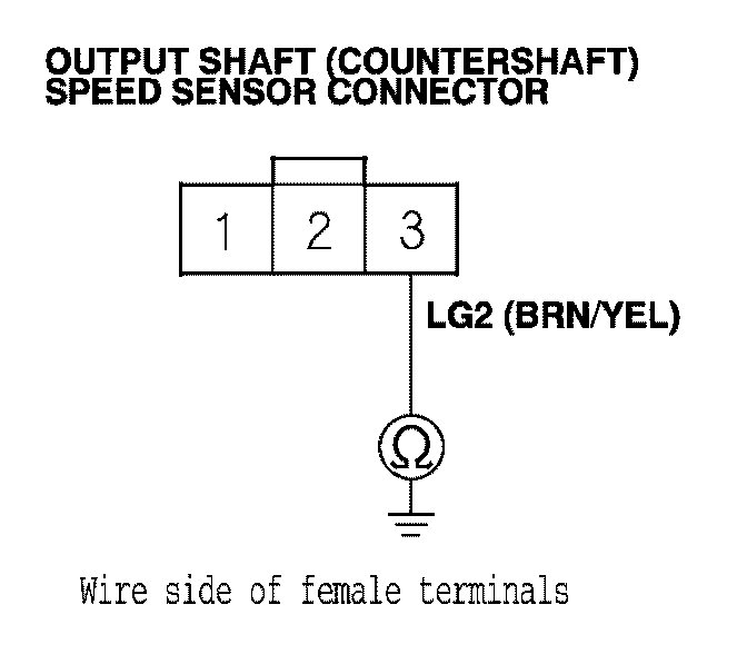

pic 3
11. Connect PCM connector A (31P).
12. Turn the ignition switch ON (II).

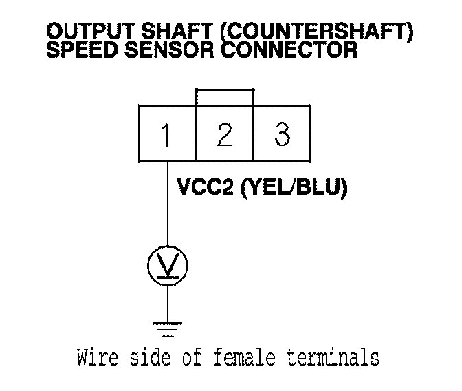

13. Measure voltage between output shaft (countershaft) speed sensor connector terminal No. 1 and body ground.
Is there about 5 V?
YES - Go to step 14.
NO - Go to step 26.

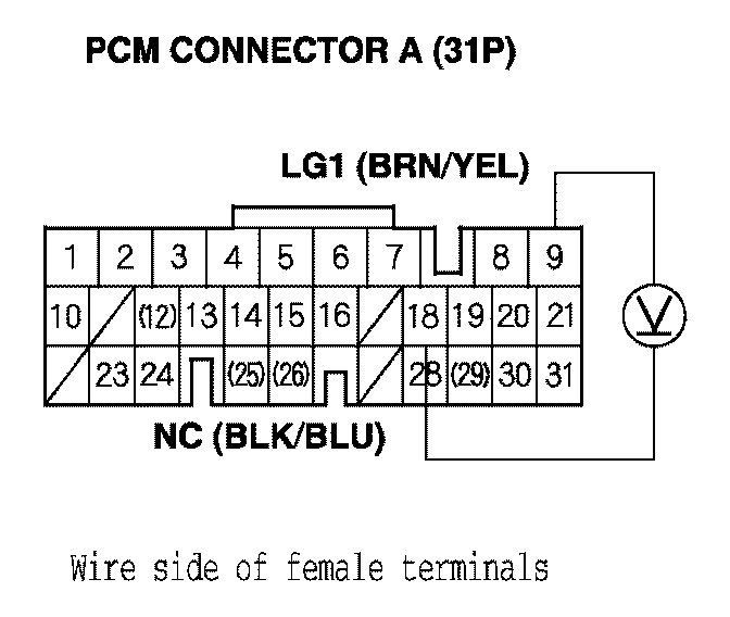

pic 4
14. Turn the ignition switch OFF.
15. Disconnect PCM connector A (31P).

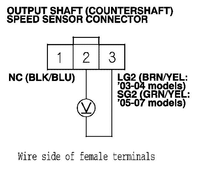

16. Check for continuity between output shaft (countershaft) speed sensor connector terminal No. 2 and body ground.
YES - Repair short to body ground in the wire between PCM connector terminal A18 and the output shaft (countershaft) speed sensor, then go to step 31.
NO - '03-04 models: Go to step 17, '05-07 models: Go to step 18.

17. Check for continuity between output shaft (countershaft) speed sensor connector terminal No. 3 and body ground.
YES - Go to step 19.
NO - Repair open in the wire between the output shaft (countershaft) speed sensor and ground (G101), repair poor ground (G101), then go to step 31.

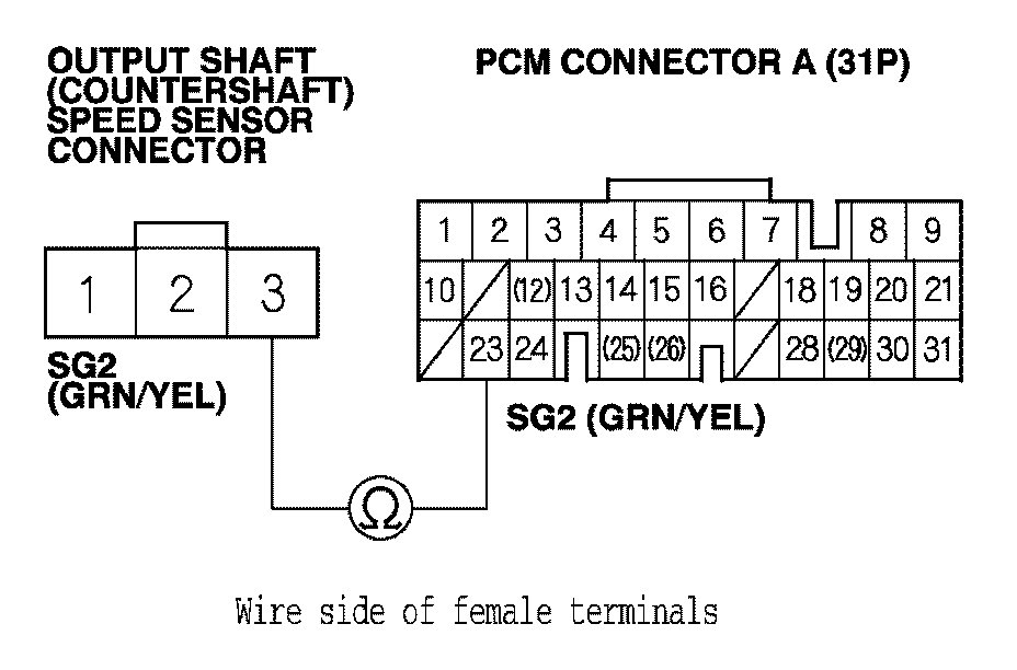

18. Check for continuity between output shaft (countershaft) speed sensor connector terminal No. 3 and PCM connector terminal A23.
NO - Repair open in the wire between the output shaft (countershaft) speed sensor and PCM connector terminal A23, then go to step 31.
pic 7
19. Connect PCM connector A (31P).
20. Turn the ignition switch ON (II).
21. Measure voltage between output shaft (countershaft) speed sensor connector terminals No. 2 and No. 3.
Is there about 5 V?
YES - Go to step 22.
NO - Go to step 30.
pic 8

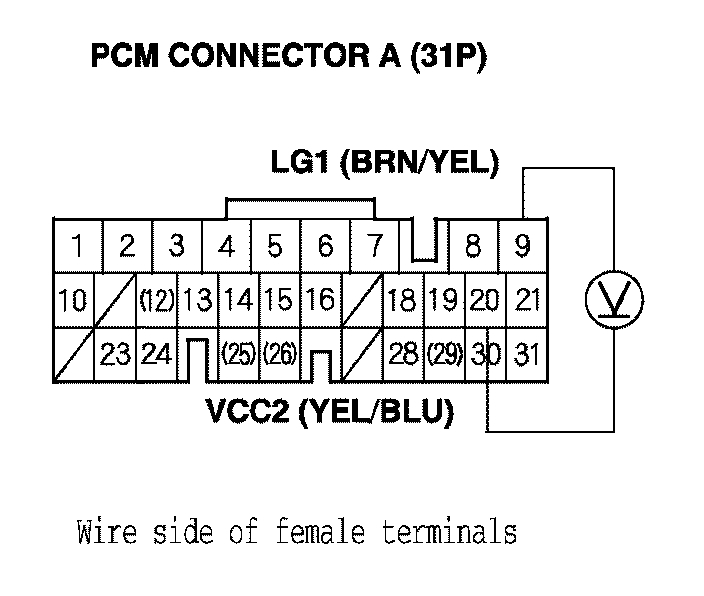

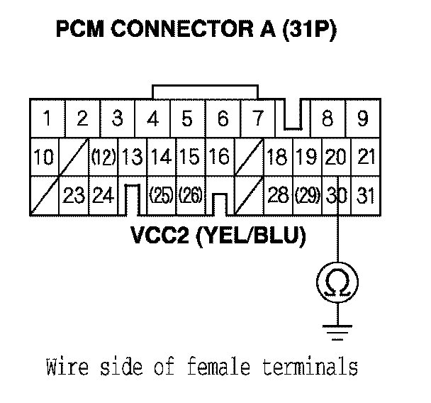

26. Measure voltage between PCM connector terminals A20 and A9.
Is there about 5 V?
YES - Repair open in the wire between PCM connector terminal A20 and the output shaft (countershaft) speed sensor, then go to step 31.
NO - Go to step 27.
pic 11
27. Turn the ignition switch OFF.
28. Disconnect PCM connector A (31P).
29. Check for continuity between PCM connector terminal A20 and body ground.
YES - Repair short to ground in the wire between PCM connector terminal A20 and the output shaft (countershaft) speed sensor, then go to step 31.
NO - Go to step 37.

The diagrams are not too great but I hope it helps.
