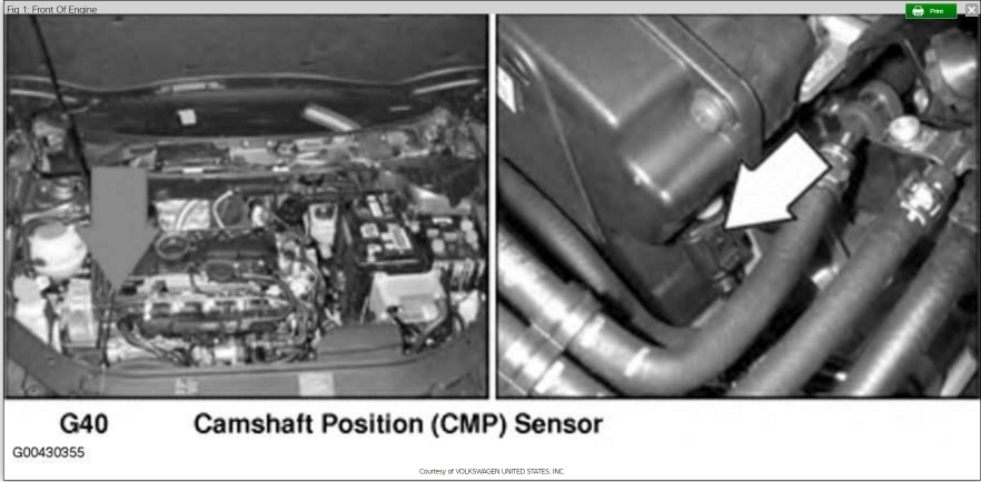

I need to find the location of the camshaft positioning sensor so I can change it. Already got the mechanic to tell me what part I needed and I bought it. Now I need to change it

Got you covered buddy, here you go. Please let us know how the repair goes so it can help others. Check out the diagrams (Below). Please let us know if you need anything else to get the problem fixed.
