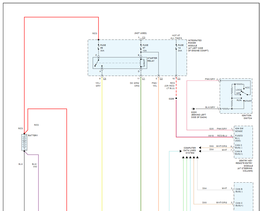

I need the wiring diagram for the ignition immobilizer?
186,000 MILES • 3.7L • V6 • 4WD • AUTOMATIC
_.NICK226._
  • 19 POSTS
Im trying to add push to start but I don't know which wire to connect to which.
Oct 2, 2025 at 1:13 AM
  • 55,684 POSTS

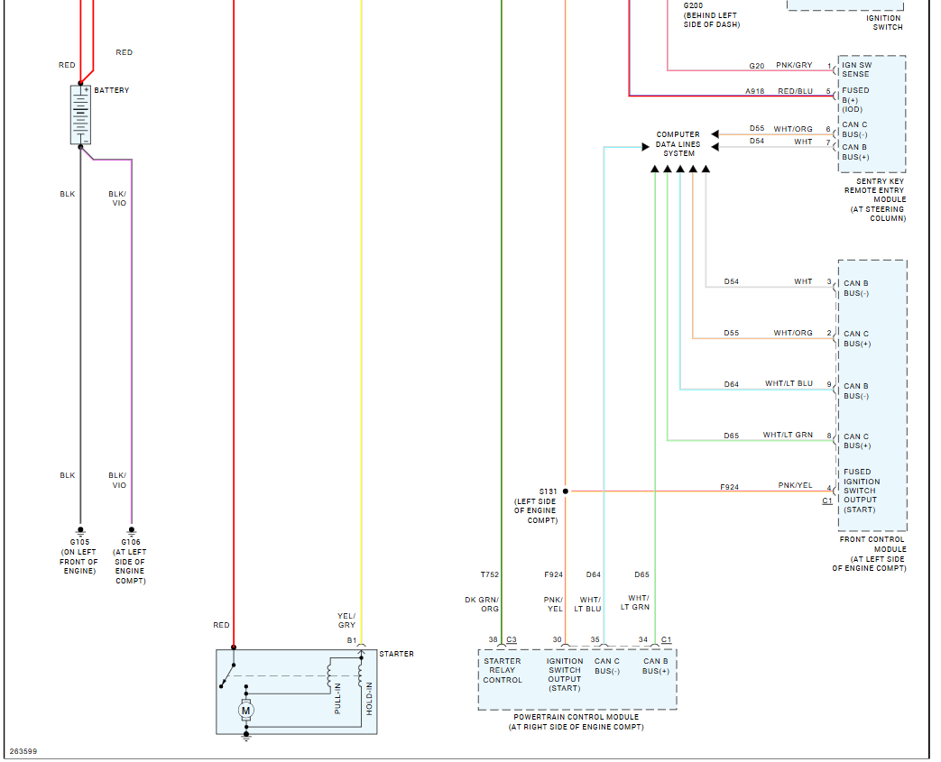

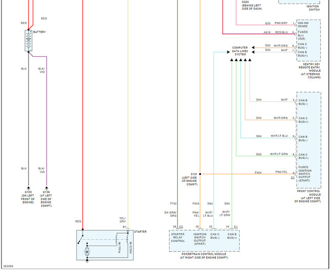

Here is the wiring diagram for the starter system and the security which are intergraded. Check out the images (below). Let us know how it goes.
