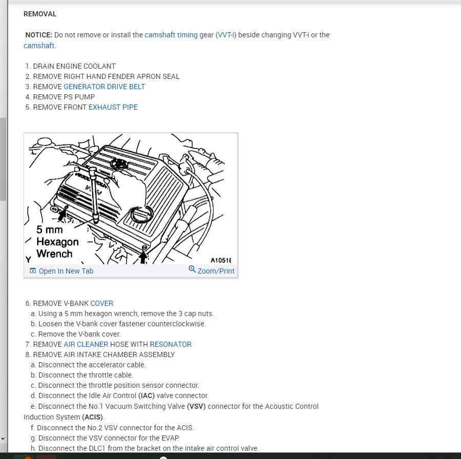

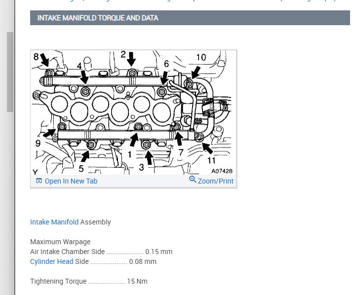

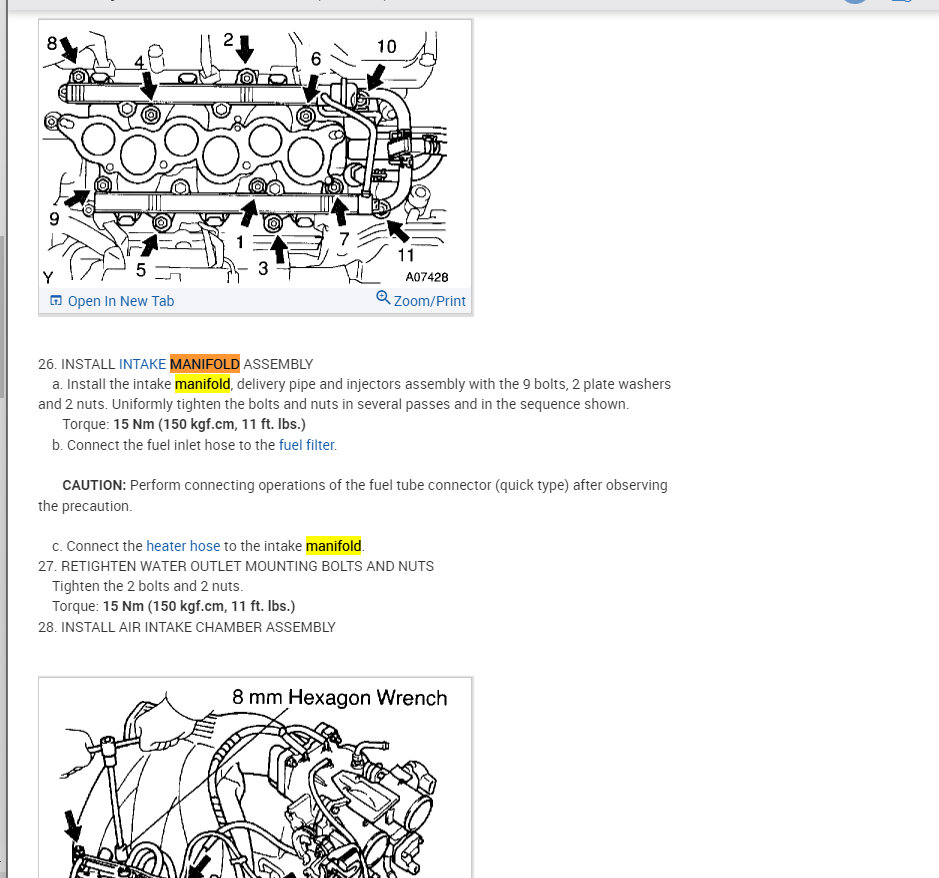

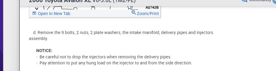

I have replaced knock sensors and valve cover gaskets on my car and now put back together. I need the torque specs and tightening sequence for proper re installation. Also, not sure on use of torque wrench with these.Could you also include intake manifold, plenum, and throttle body torque specs as well?
Thank you! Can you advise?
Sep 29, 2014 at 10:59 PM

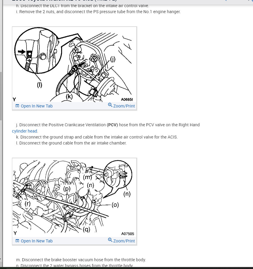

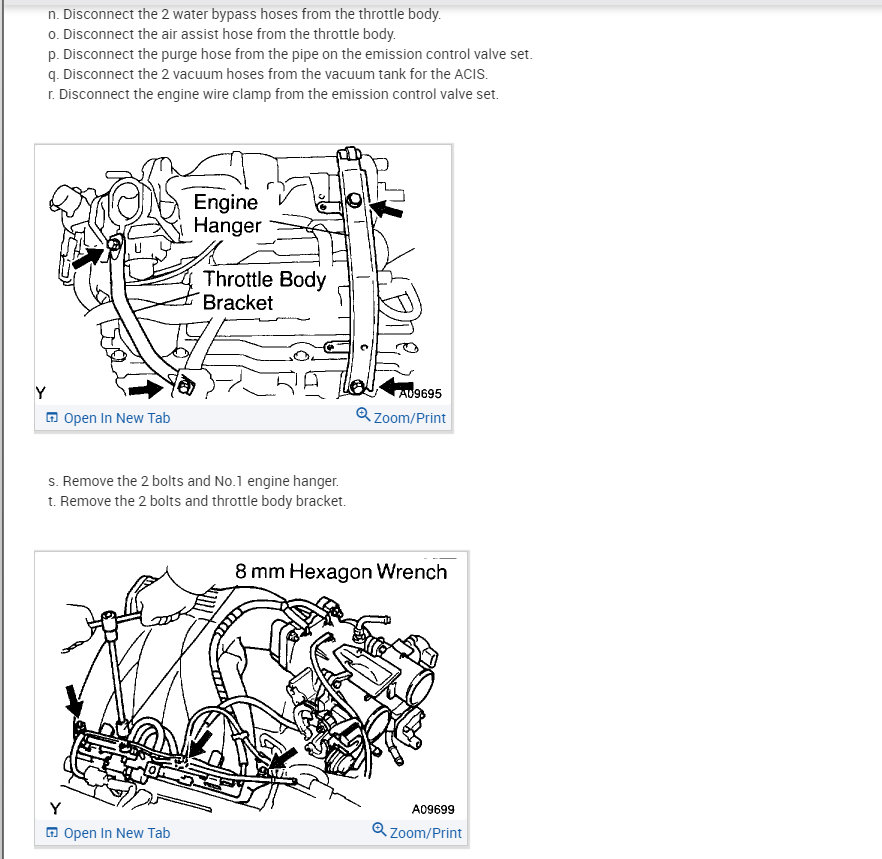

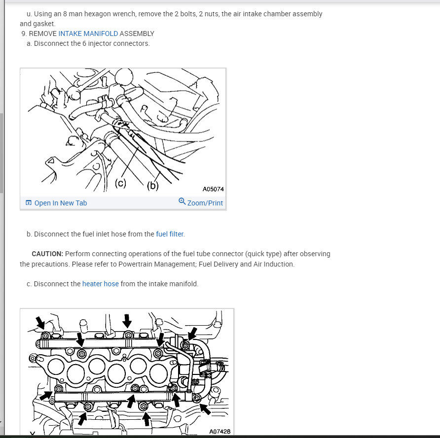

I am attaching the process below including the torque specs.
However, here is a guide that will help with doing this repair:
https://www.2carpros.com/articles/replace-valve-cover-gasket
Check out the images (Below). Please let us know what you find.
