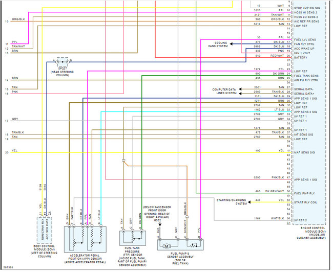

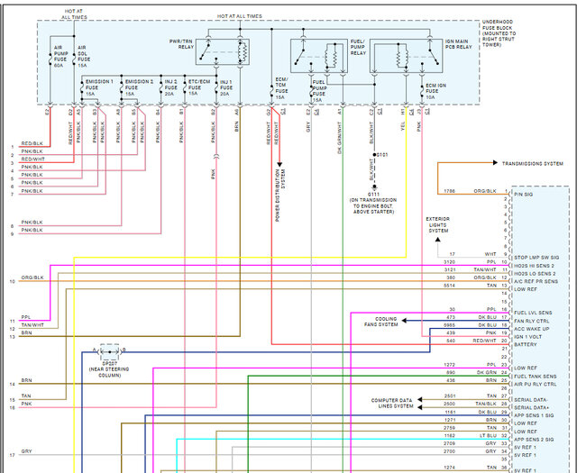

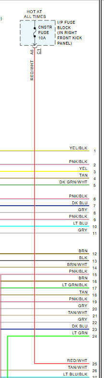

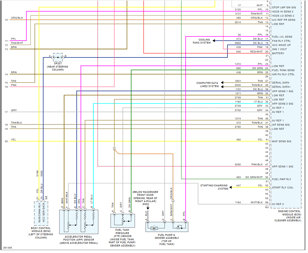

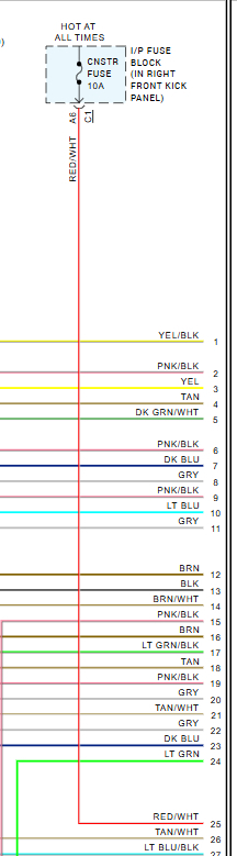

Can I get the pin out schematic fuse box to the ECM?
2007 CHEVROLET MONTE CARLO
180,000 MILES • 3.5L • V6 • 2WD • AUTOMATIC
SNAKEMAN5888
I need the pin out schematic for the connector from the fuse box to the ECM I have looked all over for this connector pinout and can't seem to find it anywhere.
Dec 28, 2024 at 5:33 AM
  • 54,840 POSTS
Is this what you are looking for? here are the wiring diagrams for the fuse panel to the PCM. Check out the images (below). Let us know if you need anything else.
