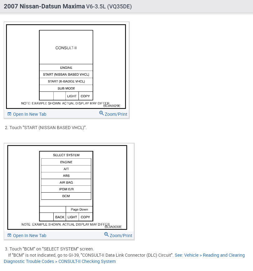

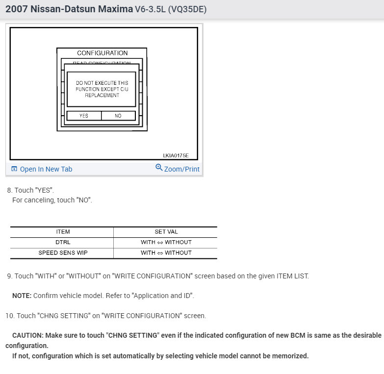

Dealership is saying the BCM is bad. The car will not come out of anti-theft mode. When you turn the key, the immobilizer isn't reading the key transponder, the car gets locked into a cycle. They got it out of the cycle, but the programming would not 'take'.
So, I need a replacement BCM, but I need the correct part number.
The VIN is 1N4BA41E37C823494.
Jun 10, 2022 at 2:32 AM
SQM
  • 6,383 POSTS

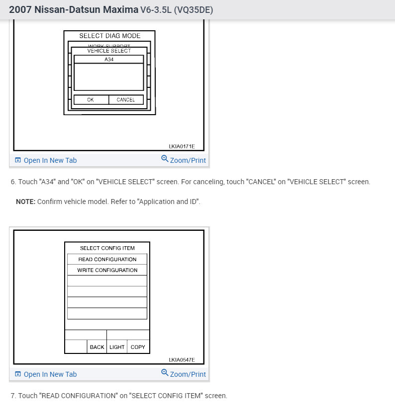

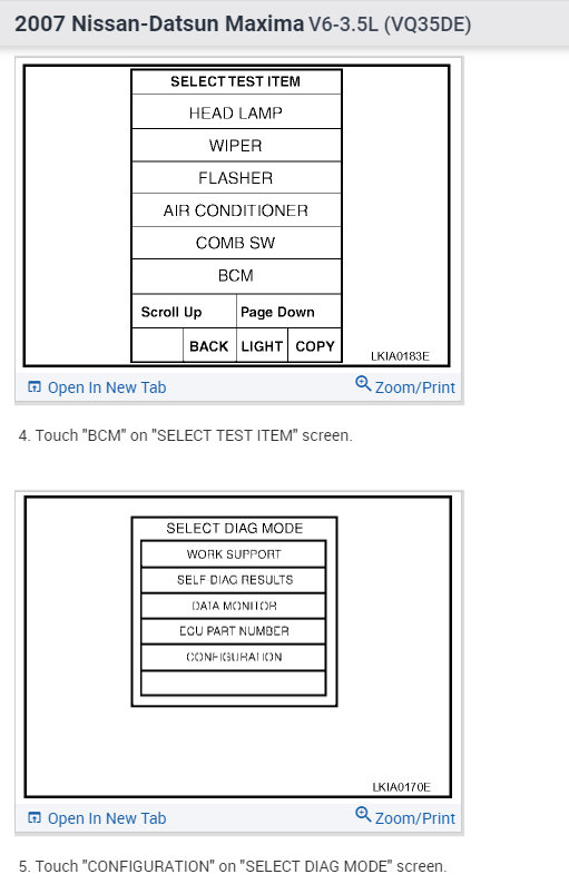

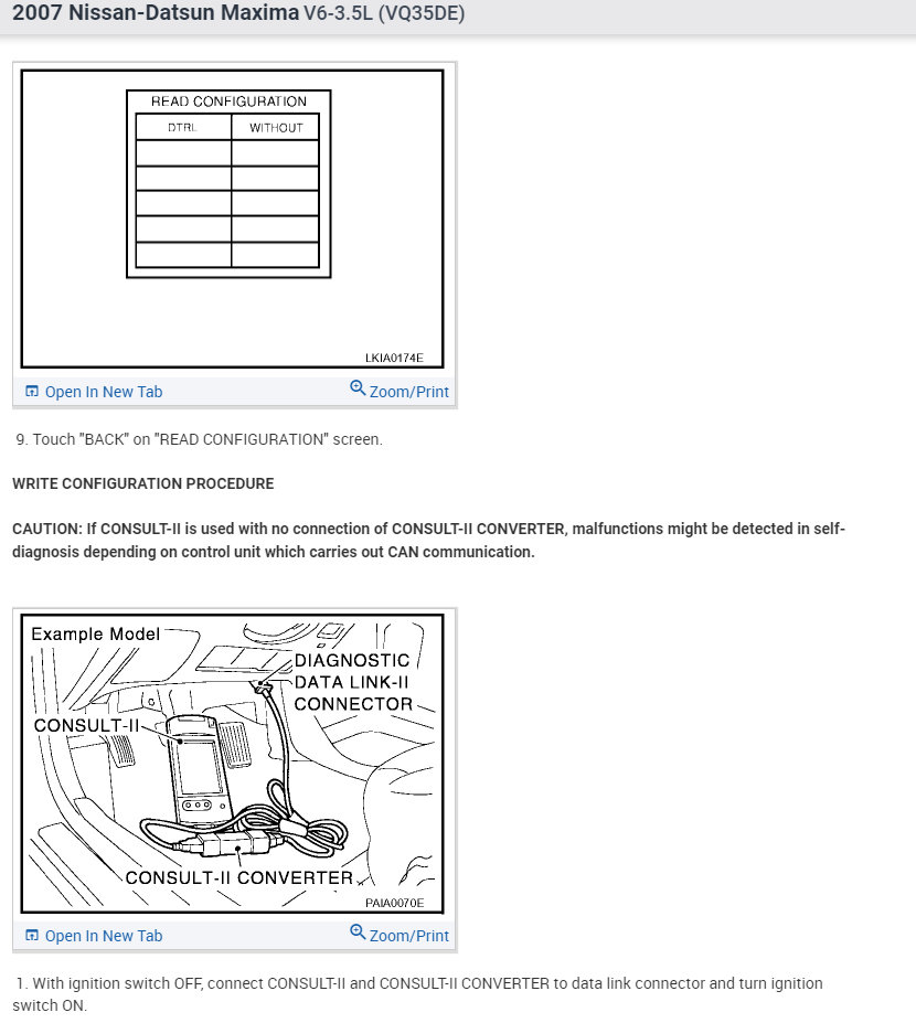

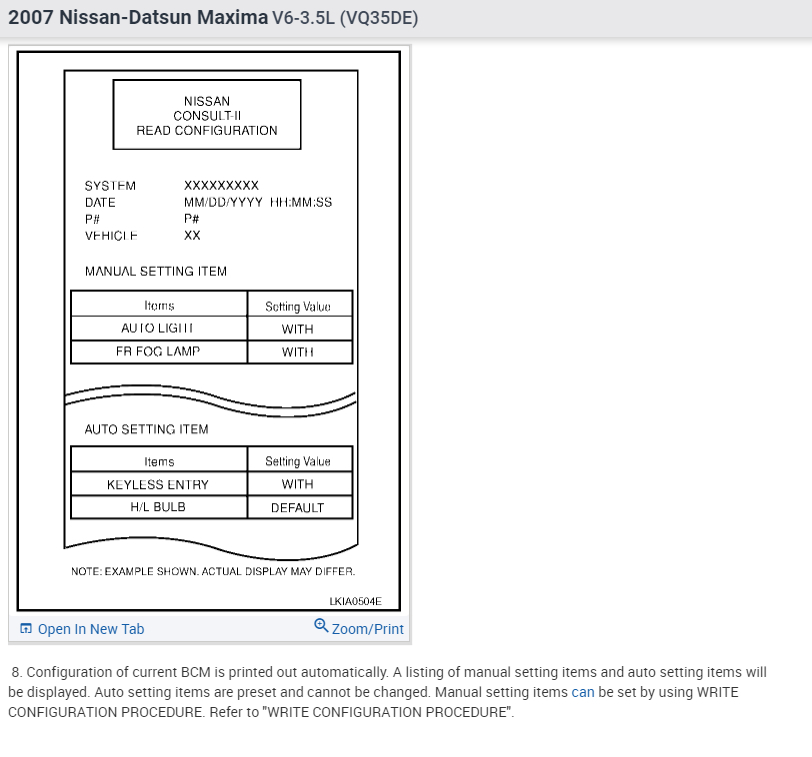

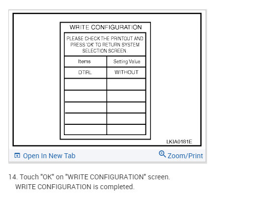

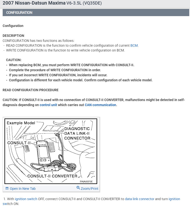

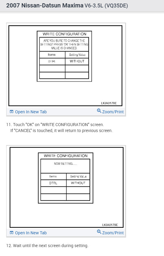

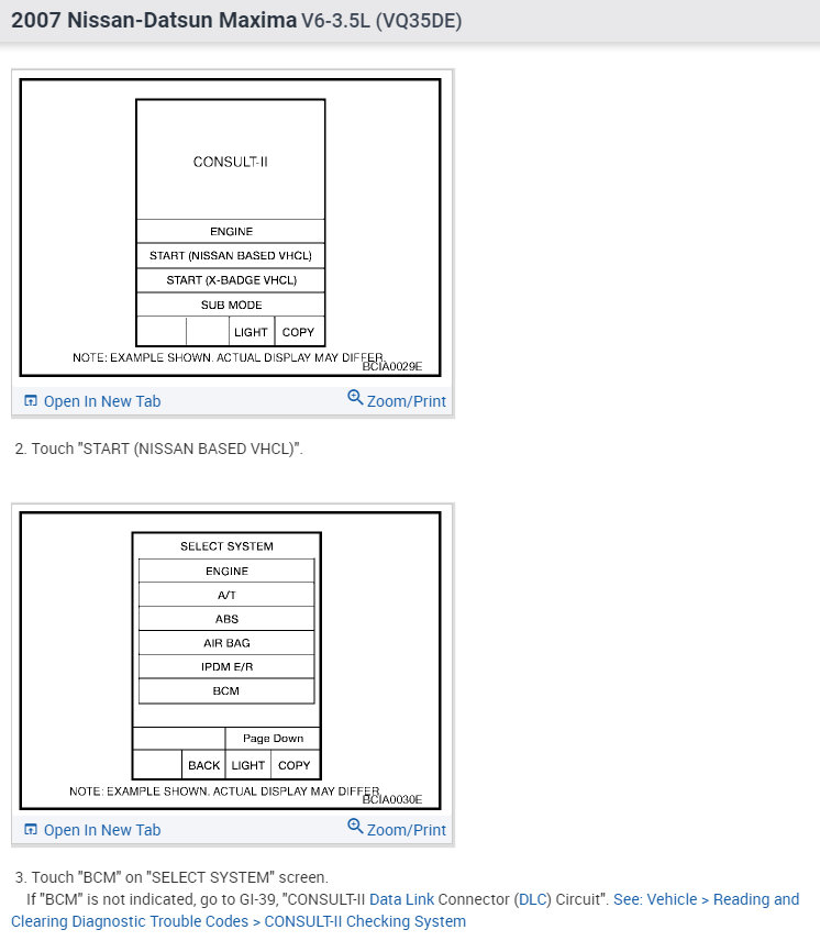

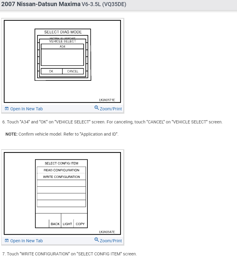

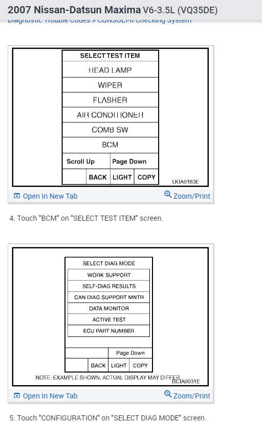

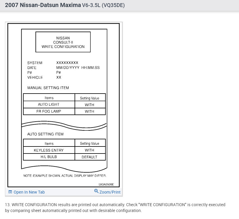

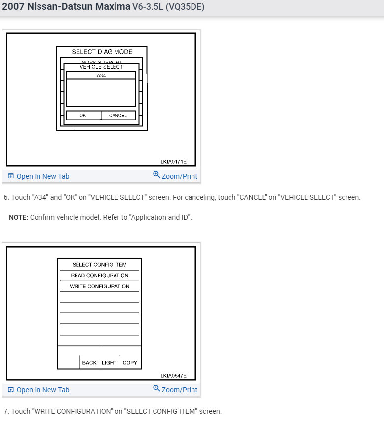

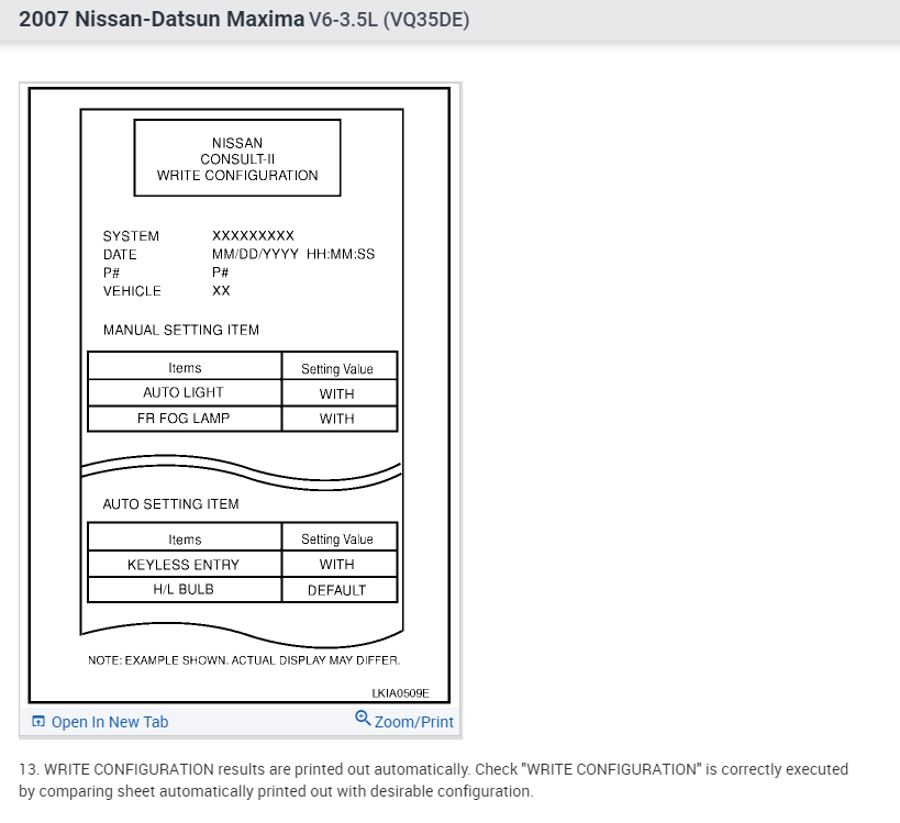

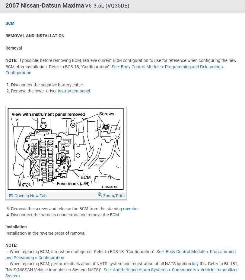

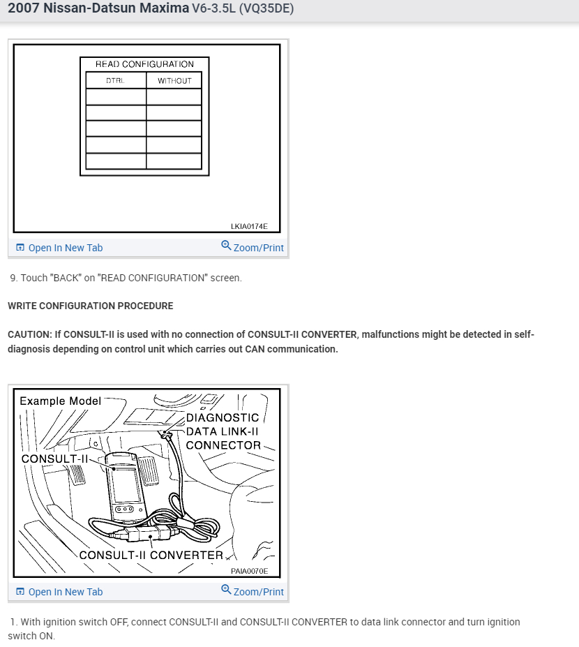

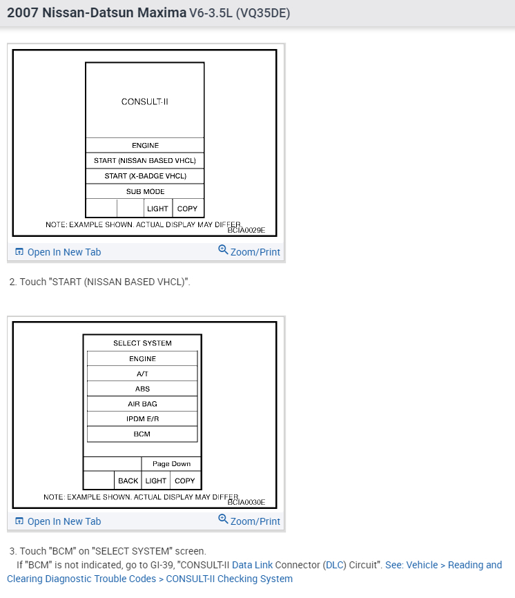

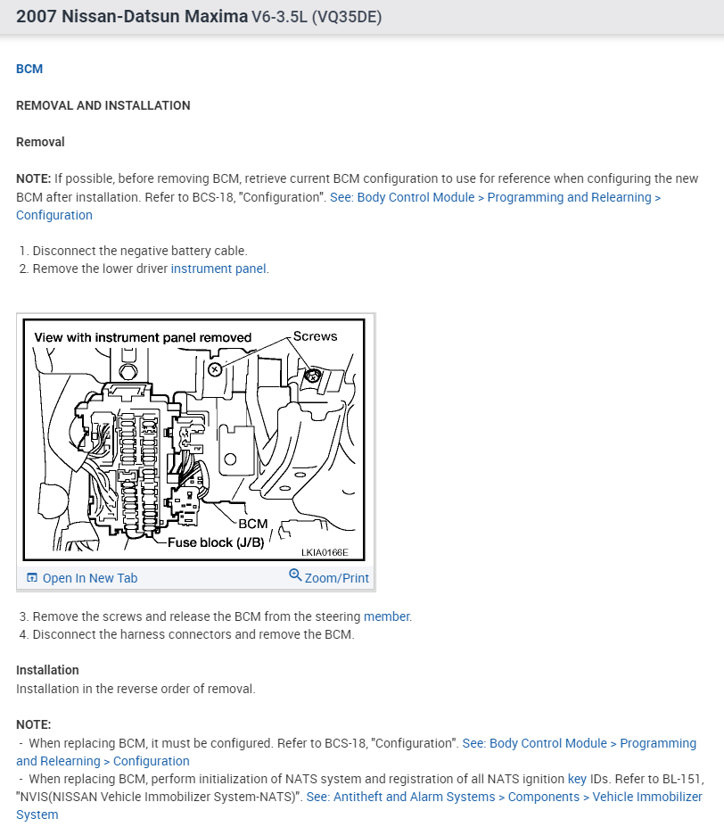

Depending on the manufacturing date, usually located on the driver side door, there are 2 BCM part numbers.
To 10/06 284B1ZK30A
From 10/06 284B1ZE50A

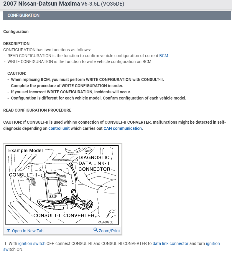

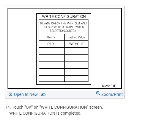

I have attached the BCM relearning process below for your reference.
Let me know of any questions.
