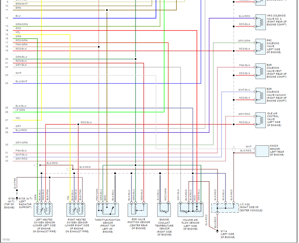

I am in desperate need of the said car's electrical wiring diagram, particularly the engine management diagram. One mechanic asked for my help to start a Ford Telstar TX5 V6 that was converted from being an automatic into a manual one by fitting a manual transmission gearbox.
At present, the car the car cranks but will not fire up. It has a distributor.
There is a lot of possibilities of why it does not start, which includes TCM blocking the ECM from receiving the start permit signal since the neutral safety switch is no longer there. It could be a poorly connected ground. It could be a disconnected sensor. It could be a faulty fuel management system, compression, etc...
I am aware that all the other things can tested, which is fine. I am very worried about the engine management wiring diagram since I do not have it.
Please help with that.

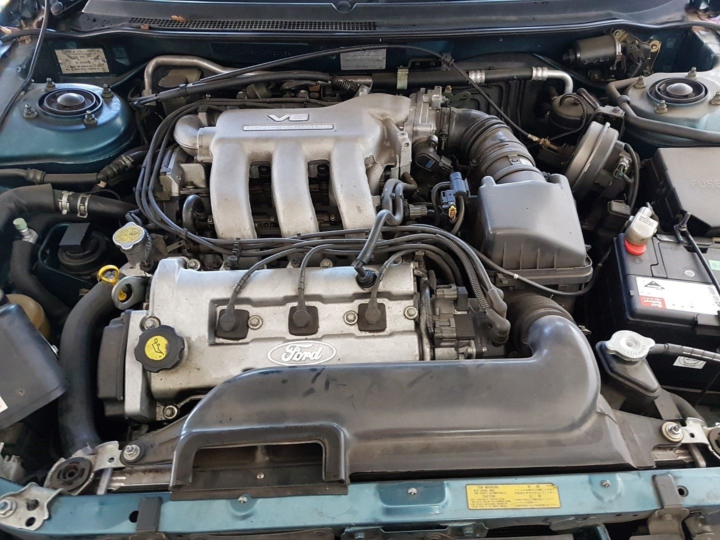

The engine looks like this...

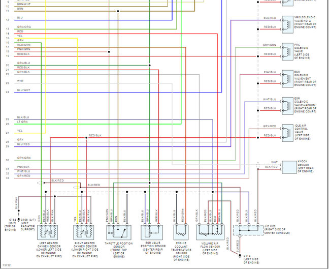

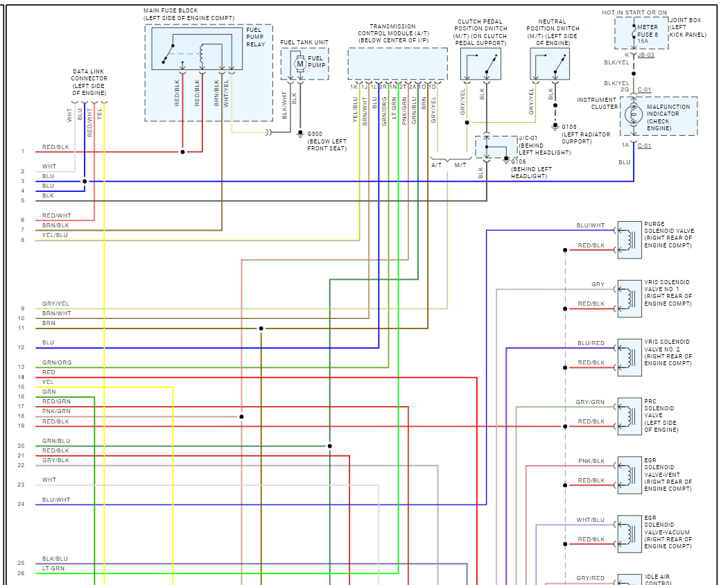

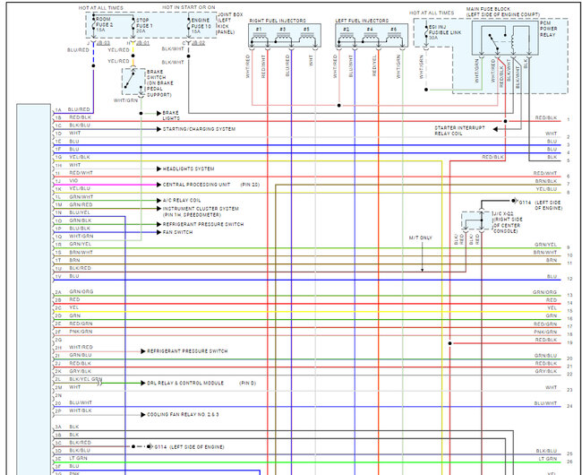

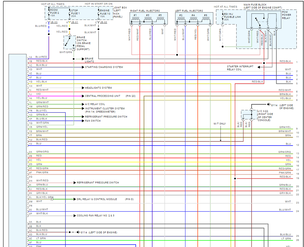

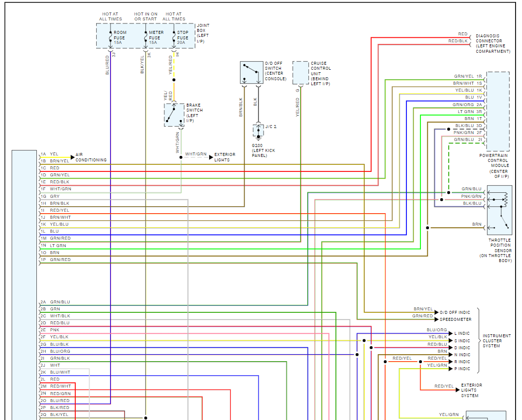

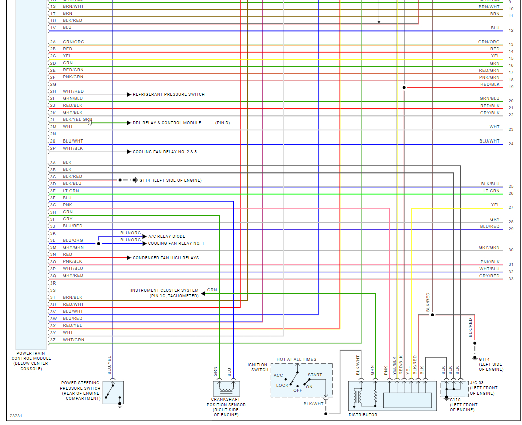

Okay, here are the engine wiring diagrams you have requested and a guide to help you check the wiring:
Check out the images (below). Let us know if you need anything else.

Do you have diagram for both automatic transmission and manual transmission? Remember that the car was converted from being an AX to a manual transmission and never started since.
What could it be?
Jun 19, 2024 at 1:38 PM
  • 55,433 POSTS

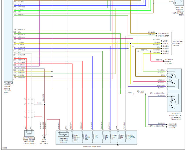

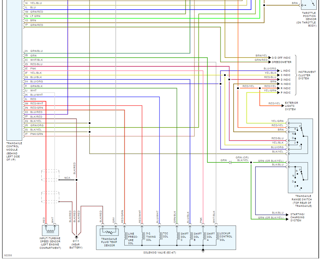

Sure, here are the transmission wiring diagrams for the automatic. Check out the images (below).
Jun 20, 2024 at 2:24 AM
SIZWE AMOS
  • 24 POSTS
Thank you again. Let me ask, so basically, I must rewire the car as a manual instead of an A/T. Now, what do we do about the transmission control module? Do I by-pass it by making 12Volts go into the Transmission control module as if the neutral safety switch has shifted into park or neutral?
How about the immobilizer?
Thanks
Jun 20, 2024 at 5:06 AM
  • 55,433 POSTS
You will need to make the connections between the PCM and TCM. I don't think you can fool the PCM with a manual transmission, but you never know, it will take some trial and error. The immobilizer should be okay.
