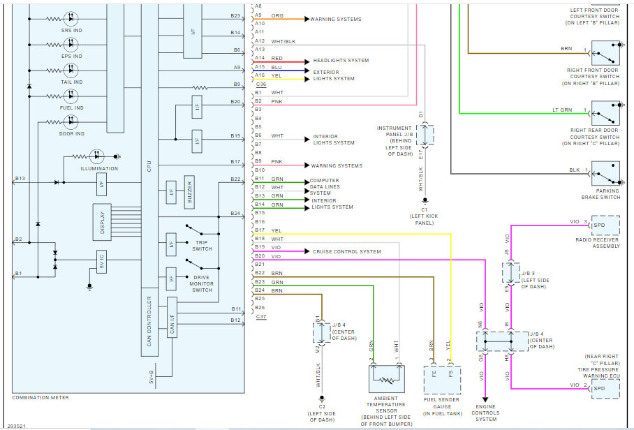

2008-2015 Scion xB. i need each wire i ask in a specific color:
Speedometer highlighted: blue
RPM: green
Power: red
Ground: brown
Thanks

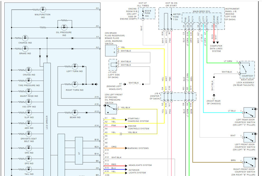

As far as the instrument cluster, I attached what I have. Take a look at it and let me know if it helps. Also, I had to cut the pic in two to make it readable. I did overlap the two so you can follow from one to the next.
Let me know if this helps.

Thank you, joe. Can you highlight them in the specific color i listed below? Thanks
I need these pins to be highlighted in the specific color i asked below, on the diagram you sent me.
Speedometer: blue
RPM: green
Power: red
Ground: brown
Thanks

Can you please clarify what you mean? Do you want us to change the wiring color?

Yes, and highlight them specifically. I want the speedometer pin(s) in the color blue, i want the RPM (pins) in green, i want the power pin(s) red, and grown pin(s) brown.

Our program will not allow us to, sorry. You can take the diagrams and put them into photoshop and do it yourself if needed.

Can you please tell me which pin is the RPM, power, speedometer and ground?

Grounds are brown and white and black.
Power is white.
The Speedometer and RPM signal is brought in through the Body ECU which will be the computer data lines, they don't tell us which ones do what.
