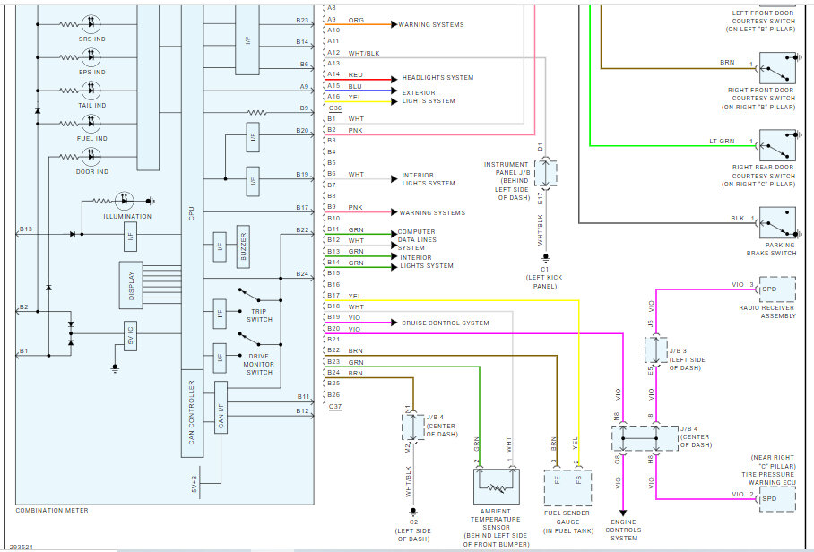

2008-2015 Scion xB. I need each wire I ask in a specific color:
Speedometer highlighted: blue
RPM: green
Power: red
Ground: brown
Thanks

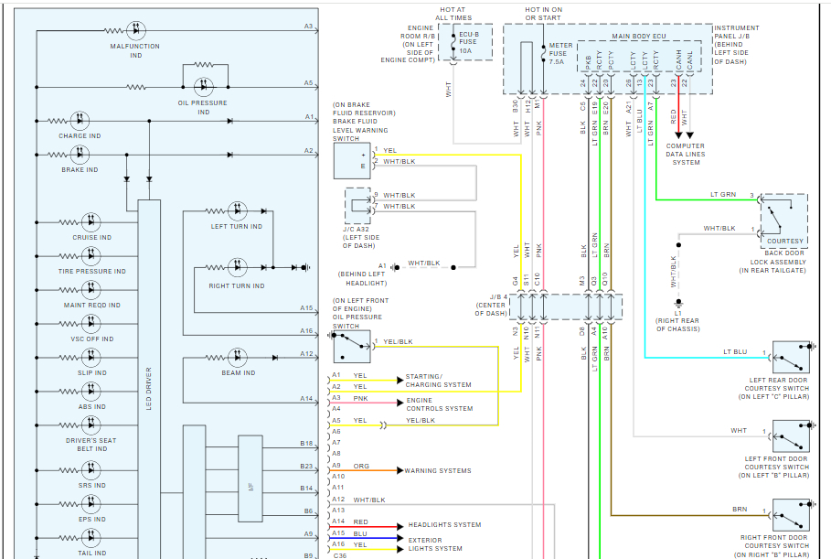

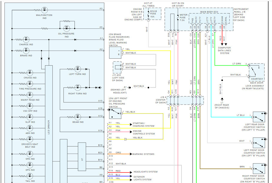

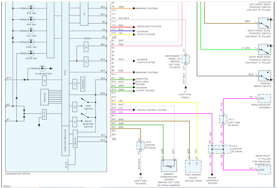

As far as the instrument cluster, I attached what I have. Take a look at it and let me know if it helps. Also, I had to cut the pic in two to make it readable. I did overlap the two so you can follow from one to the next.
Let me know if this helps.
Monday, January 1st, 2024 AT 7:19 PM

Can you please tell me which pin is the RPM, power, speedometer and ground?
Saturday, January 6th, 2024 AT 7:42 PM
KEN L
  • MASTER CERTIFIED MECHANIC
  • 48,363 POSTS
Grounds are brown and white and black.
Power is white.
The Speedometer and RPM signal is brought in through the Body ECU which will be the computer data lines, they don't tell us which ones do what.
