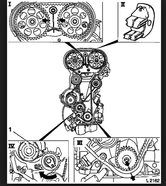

The timing belt is off so i want to replace.

Here are the timing marks for your car, Check out the diagrams (below). Please let us know if you need anything else to get the problem fixed......................
