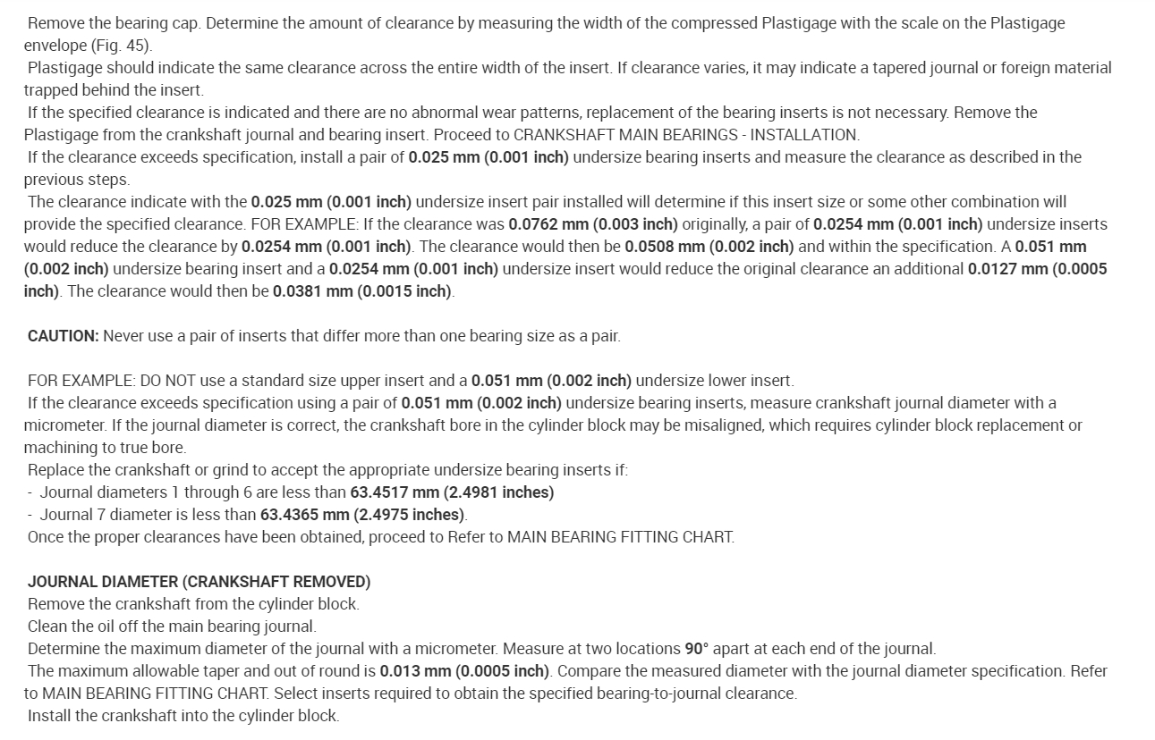

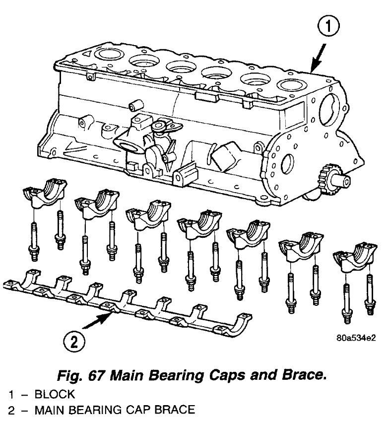

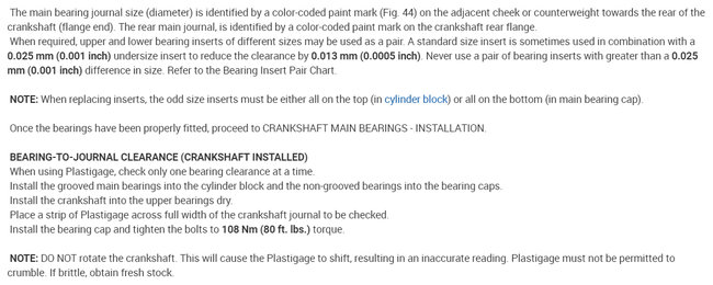

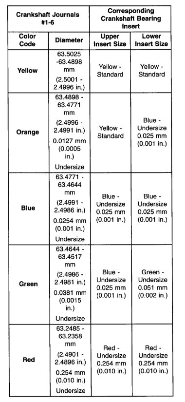

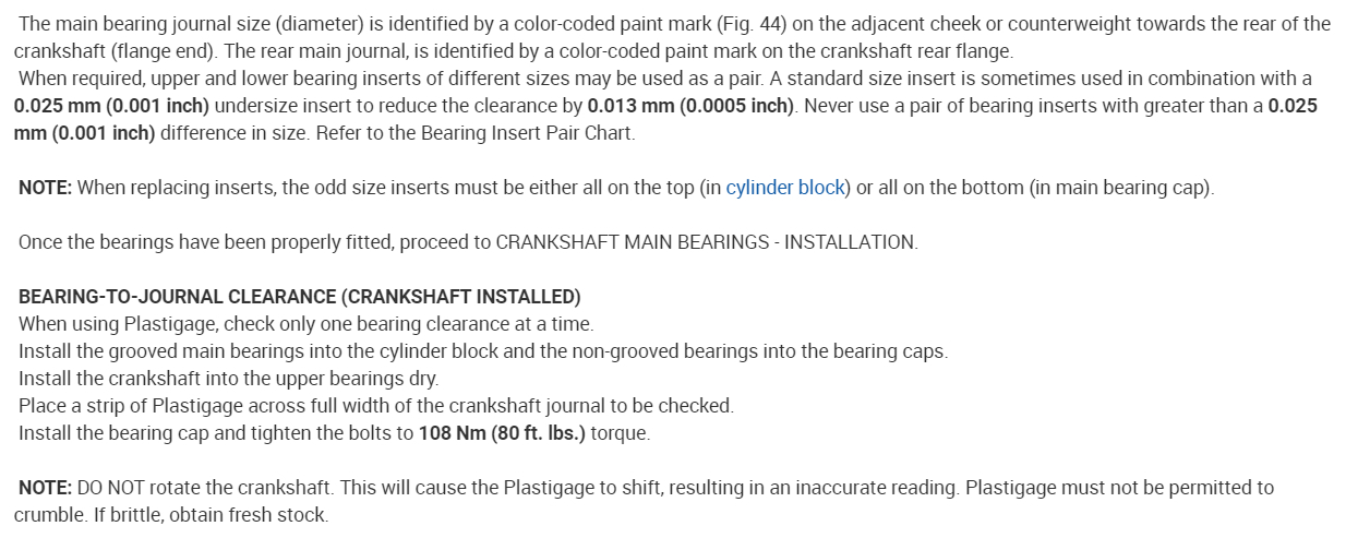

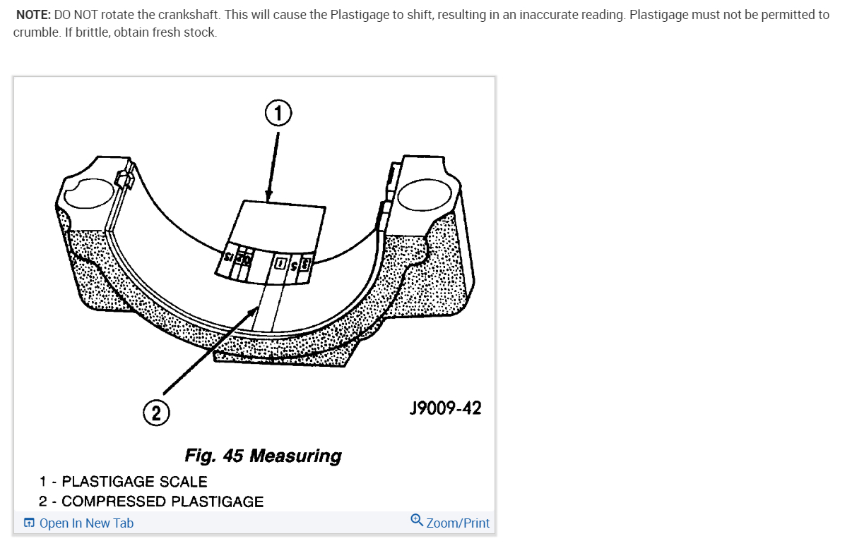

Here are the tolerances and torque specs for the crankshaft and rod bearing with fitting guides below.
1. Tighten the bolts of main bearing caps # 1, 2, 4, 5, 6 and 7 in three steps.
- Step 1: 54 Nm (40 ft. lbs.)
- Step 2: 95 Nm (70 ft. lbs.)
- Step 3: 108 Nm (80 ft. lbs.)
2. Push the crankshaft forward and backward. Load the crankshaft front or rear and tighten main bearing cap bolt # 3 in three steps.
3. Install main bearing cap brace and tighten nuts to 47 Nm (35 ft. lbs.).

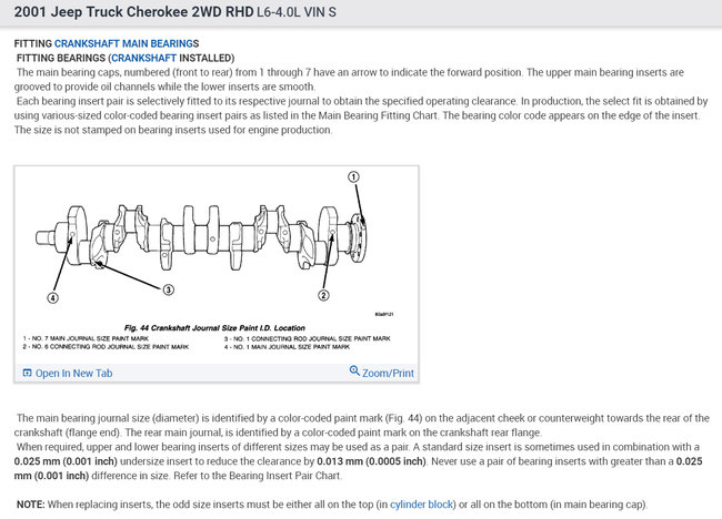

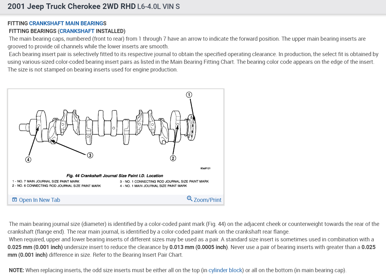

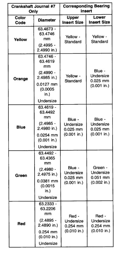

looking for the specs on the crankshaft so i know if i need to polish or grind them plus i need to know what bearings to buy .010 .020 .030
Nov 7, 2018 at 1:22 AM (Merged)
CRANKSHAFT End Play 0.0015 to 0.0065 in
Main Bearing Journal Diameter No. 1-6 2.4996 to 2.5001 in
No. 7 2.4980 to 2.4995 in
Main Bearing Journal Width No. 1 1.086 to 1.098 inch
No. 3 1.271 to 1.273 inch
No. 2-4-5-6-7 1.182 to 1.188 inch
Main Bearing Clearance 0.001 to 0.0025 in
Preferred 0.002 in
