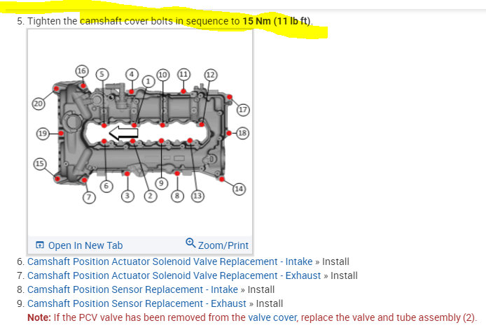

I need sequence and torque settings for valve cover?
100,000 MILES • 1.5L • 4 CYL • 2WD • AUTOMATIC
CRAZYFROGZ

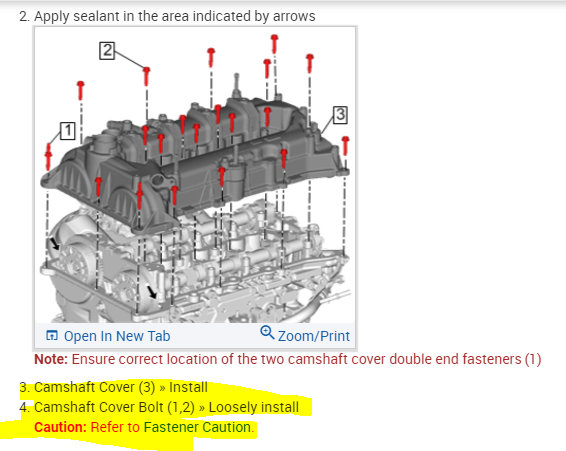

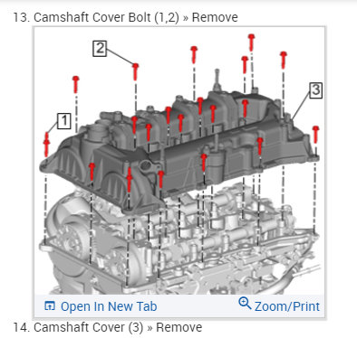

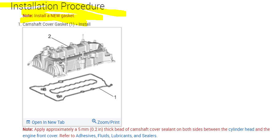

I had a brake vacuum pump break off into the valve cover, got it all apart now ready to put everything back together. I just need the Sequence and torque settings for the valve cover for the car listed above. Thank you!

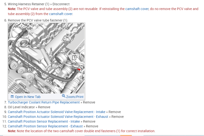

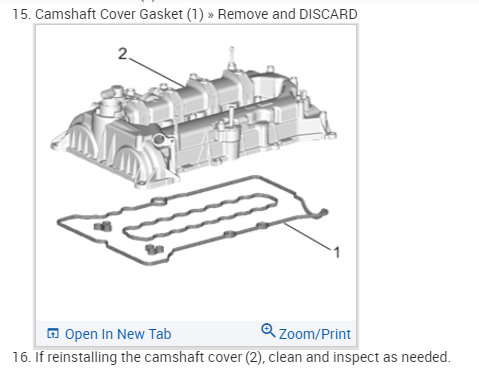

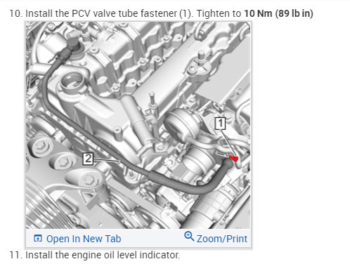

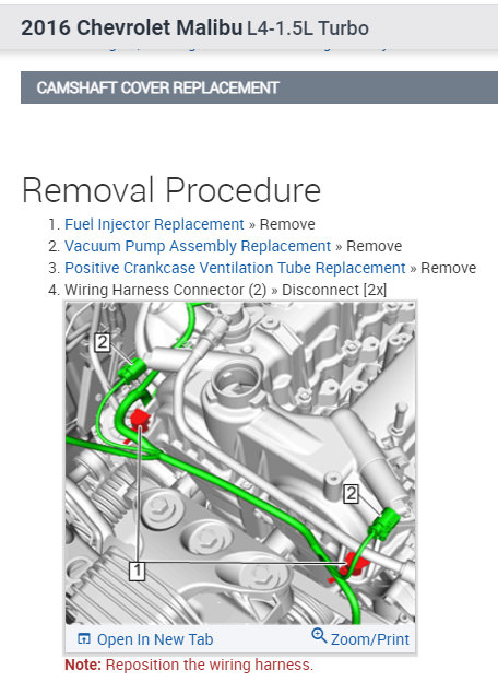

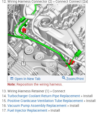

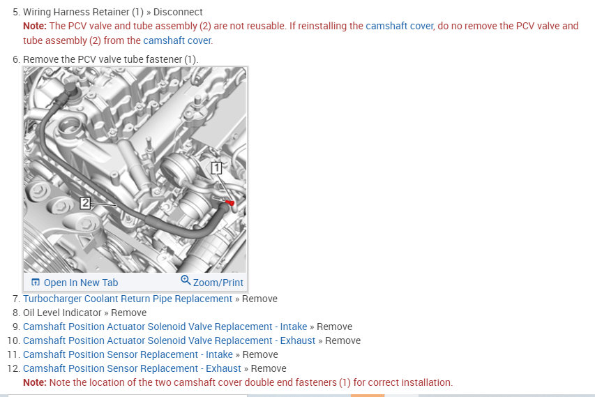

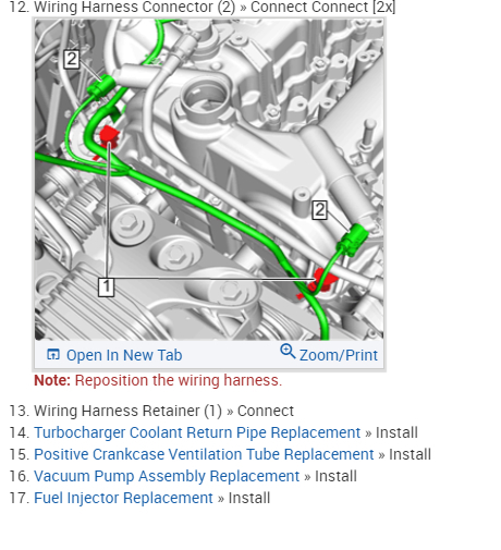

I attached the directions below for replacing the valve cover. I highlighted areas that will be of most interest and helpful to you.
