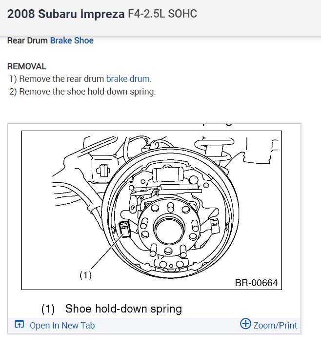

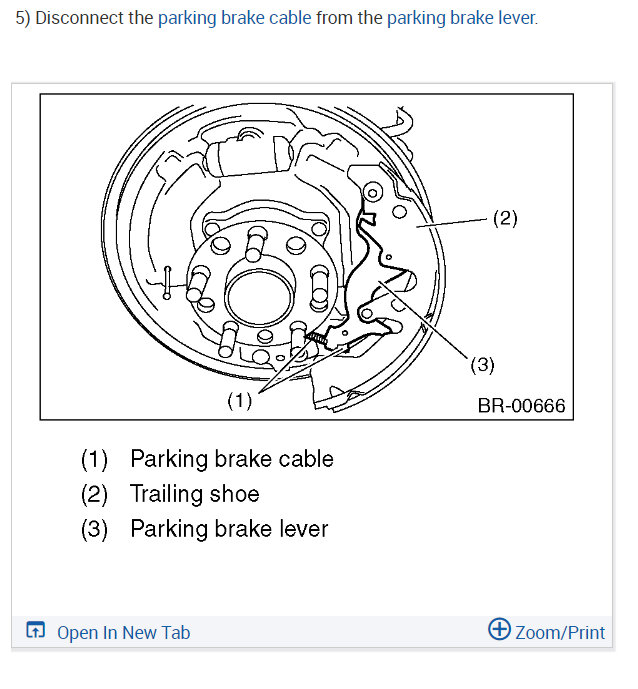

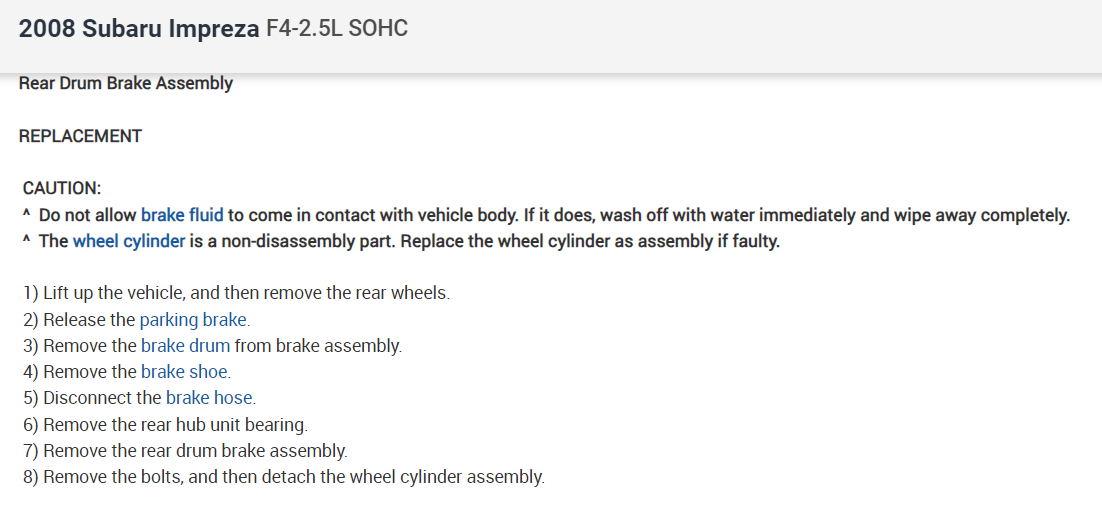

I need to have my wheel cylinder brake shoes and brake drum replaced but I don't know what size I need.
Feb 19, 2024 at 11:17 PM
  • 55,770 POSTS

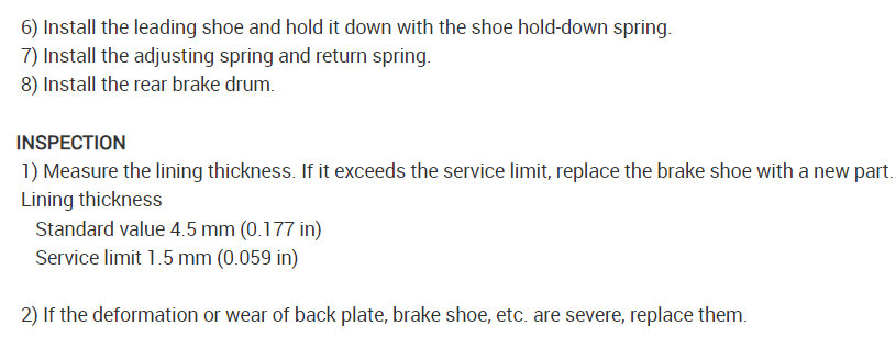

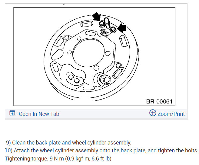

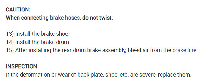

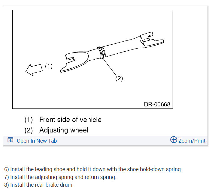

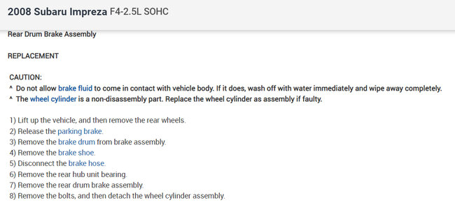

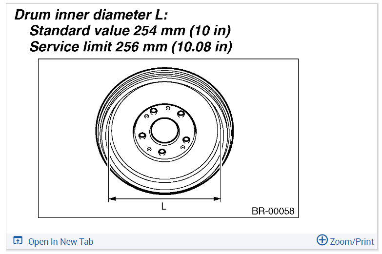

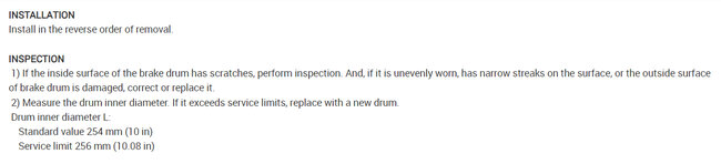

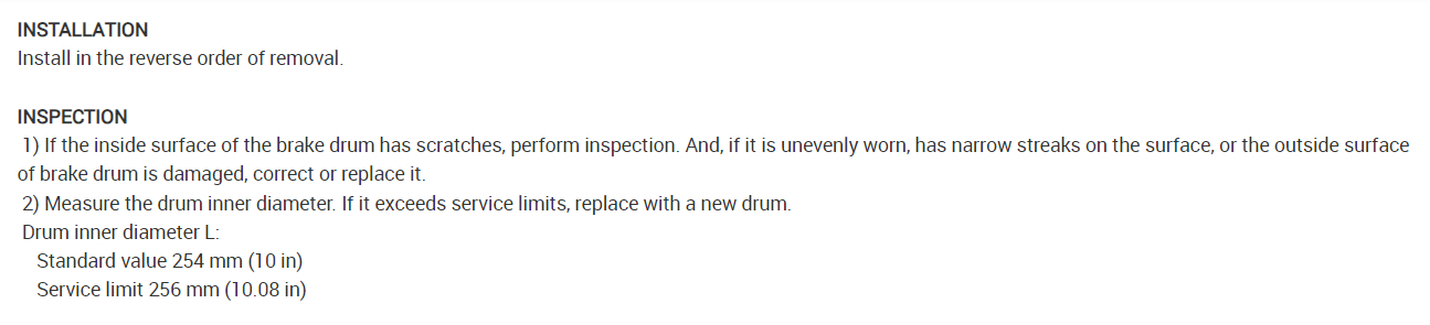

That will depend on the sub model, WRX or WRX STI or the regular Impreza? Here are the part numbers for the regular Impreza.
Drum 26740FG000 $137.30
Wheel Cylinder 26705FG000 $55.28
Shoes 26694FG000 $99.95

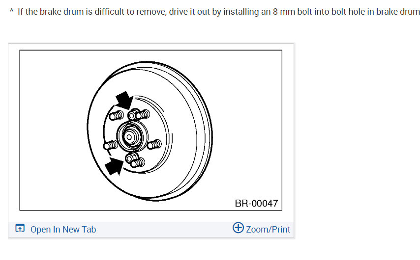

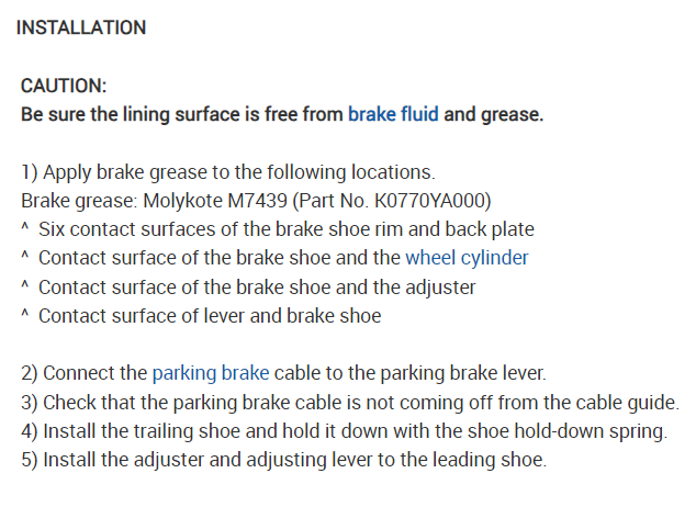

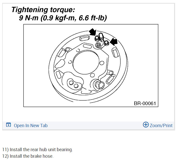

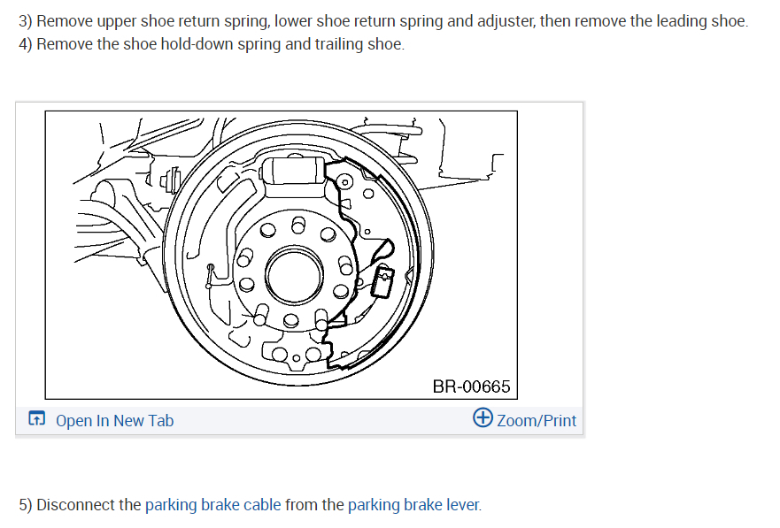

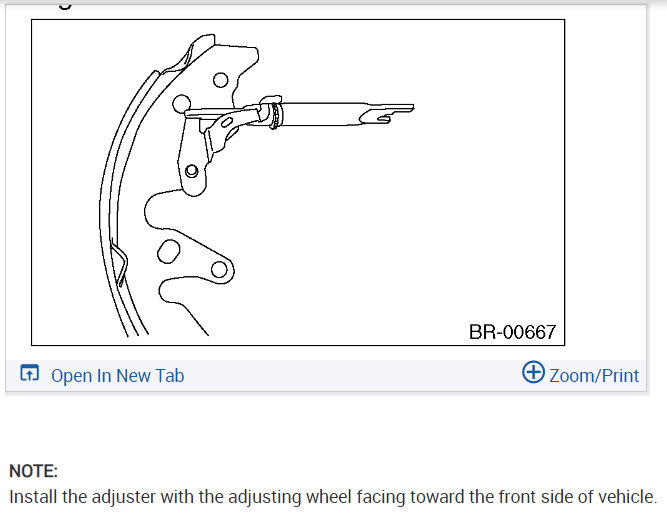

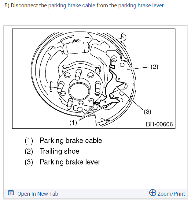

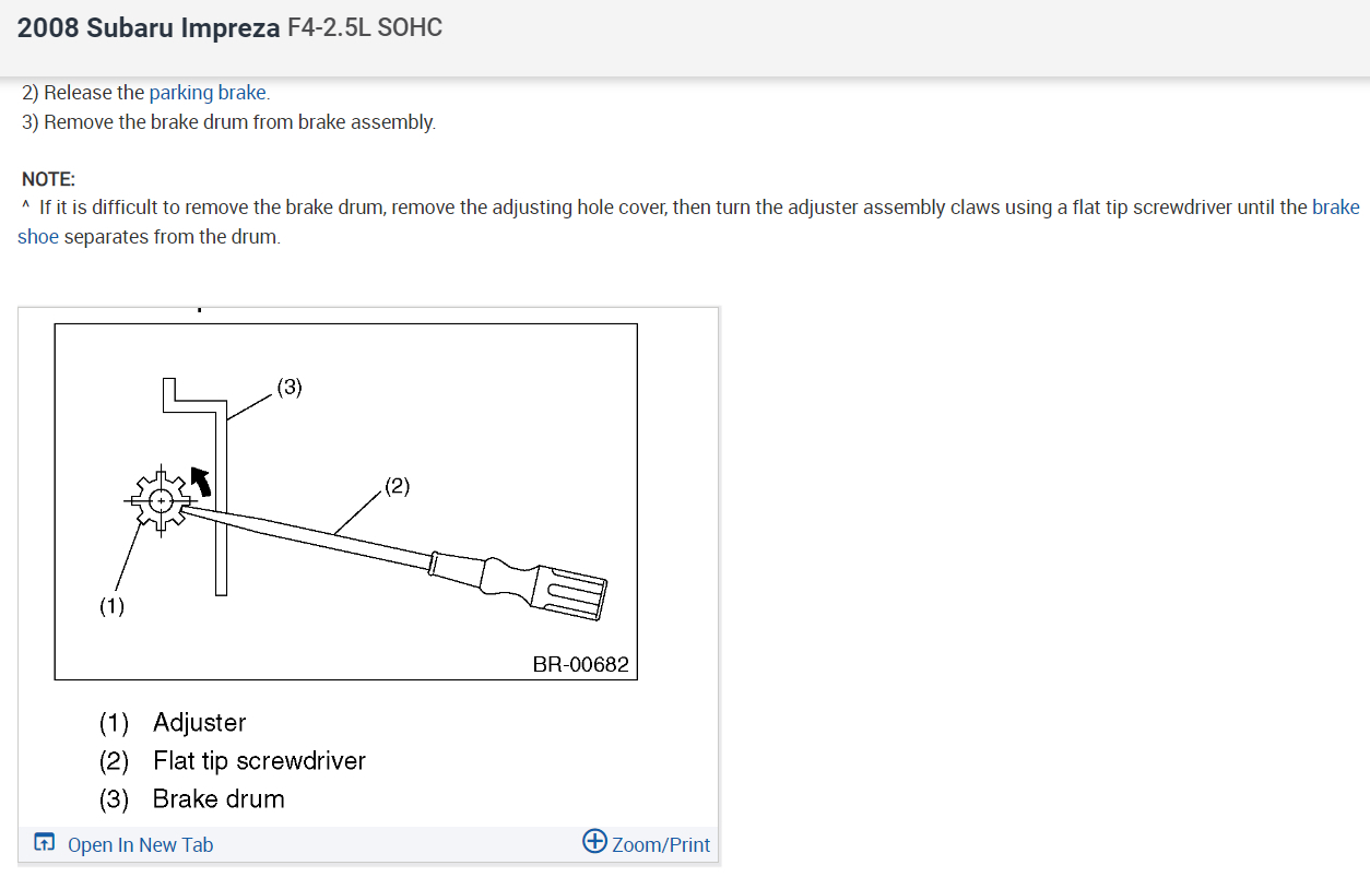

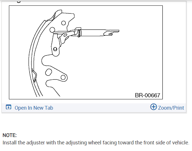

Here is how the job is done in the images below. Also, this generic guide can help as well:
https://www.2carpros.com/articles/how-to-replace-rear-brake-shoes-and-drums
and
https://www.2carpros.com/articles/how-to-replace-a-wheel-cylinder
Check out the images (below). Let us know how it goes.
