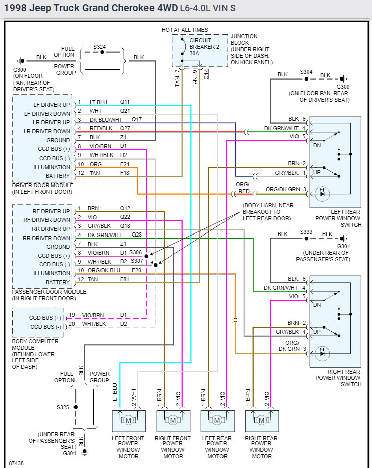

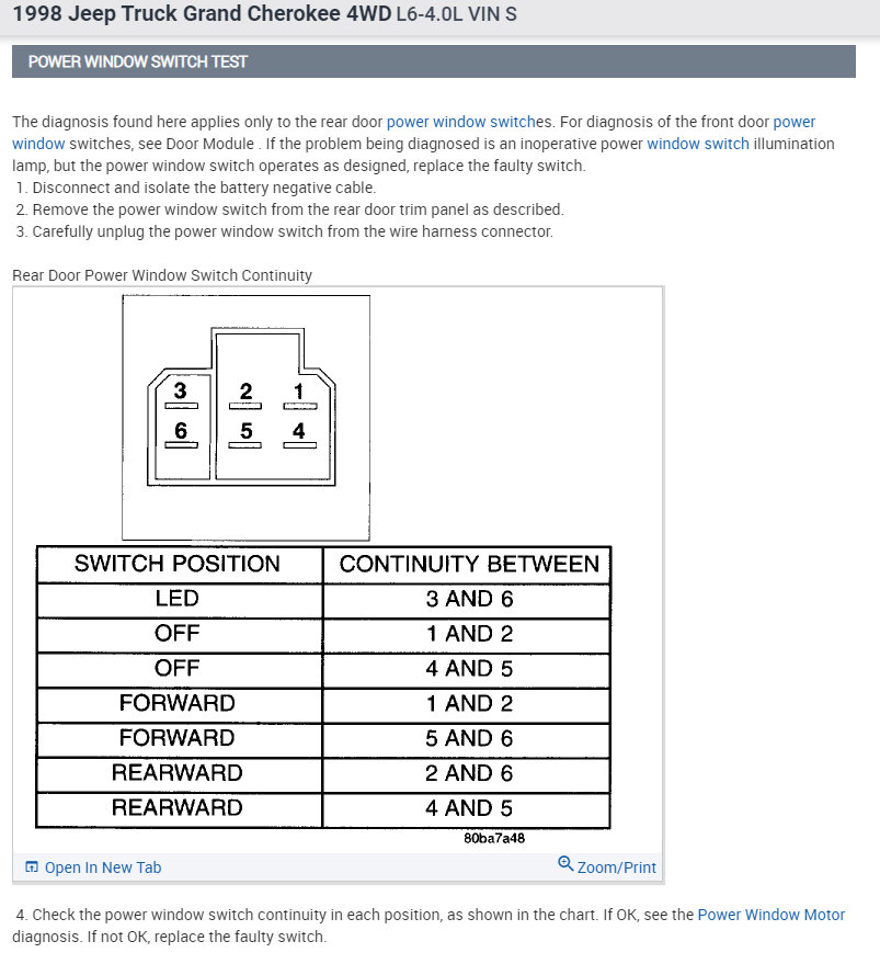

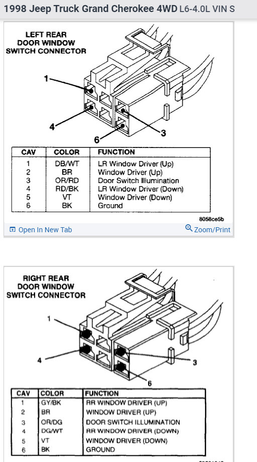

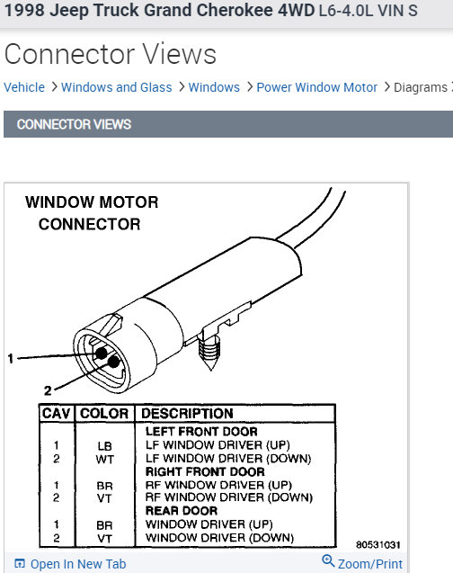

Pinouts and wire colors for the left-hand power window harness and connectors needed
1998 JEEP GRAND CHEROKEE
312,000 MILES • 4.0L
HENRY TEPASSE
Door wiring was all cut.

See attached for the wiring schematics.
You might find this video helpful:
https://youtu.be/HBFBcJrdym4
Check out the diagrams (Below). Please let us know if you need anything else to get the problem fixed. Let me know of any questions.
