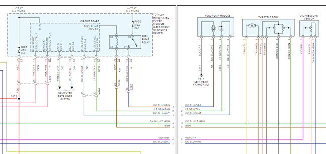

I need of a wiring diagram to install a fuel pump relay bypass
2010 DODGE RAM
160,000 MILES • 5.7L • V8 • 4WD • AUTOMATIC
JUSTINRAMJUSTIN
  • 7 POSTS
I want to be sure I’m wiring my relay correctly (this time) I’m trying to hard wire in a fuel pump relay bypass to the tipm. After hours and hours of research and voltage testing and burning out a fuel pump do to my wiring my relay incorrectly, I want to be 100 percent sure I’m all wired correctly before plugging in my $500 Delphi fuel pump. Is there an image you can share with wire colors and which slot on the relay those wires belong? I can not find a kit specific to the 2010 ram 2500 4x4 Laramie nor a video specific to that year. I have the tipm 7 model I believe. Produced in Mexico .

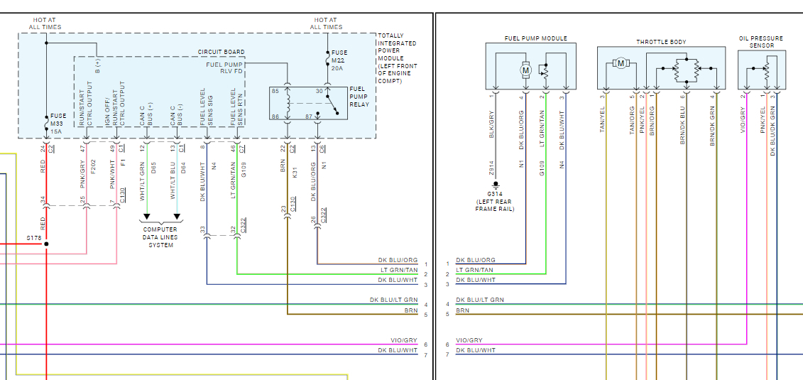

I cannot recommend you to bypass the fuel pump controls but I will give you the wiring diagrams so you can see how the system works. Also, if the fuel pump does not turn on a bad MAF sensor can cause this FYI. I would try unplugging the MAF sensor to see if it makes a difference. The brown wire goes to the PCM. Check out the images (below). Please let us know what happens.

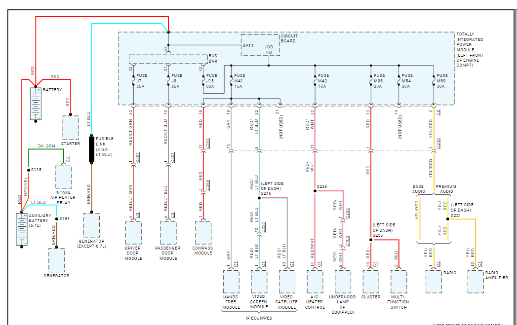

Also when it first did the crank no start, I had no voltage at the fuel pump fuse. Fuse was good.
Oct 5, 2024 at 2:57 AM
  • 55,423 POSTS
To confirm you have no power at fuse m2 correct? If so the TIPM might be bad. can you check for power at these other fuse I have listed below? Check out the images (below). Let us know how it goes.
