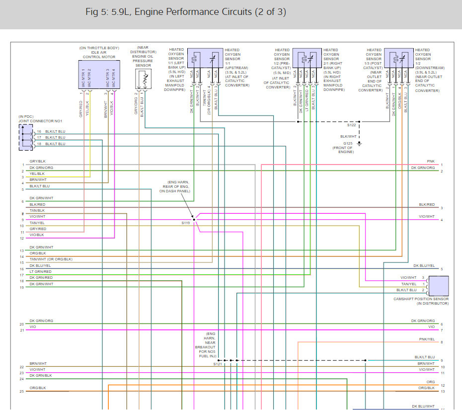

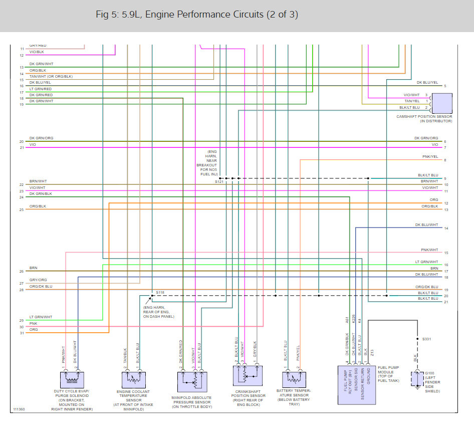

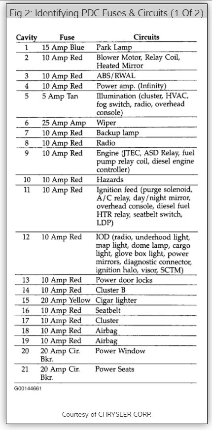

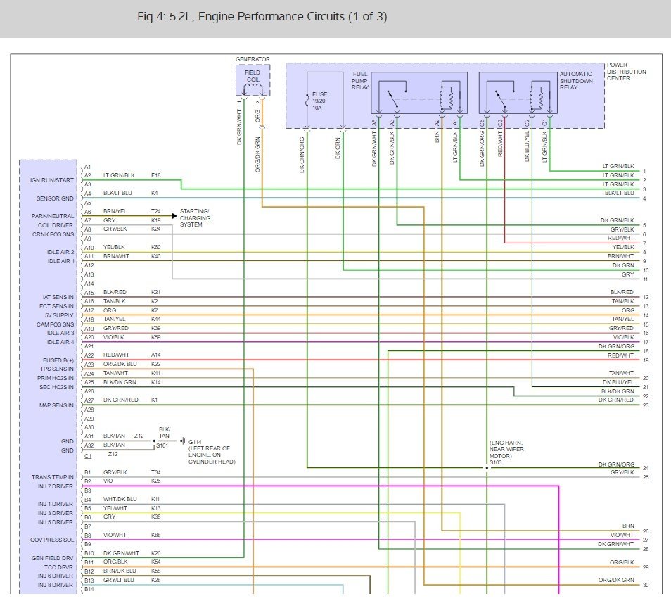

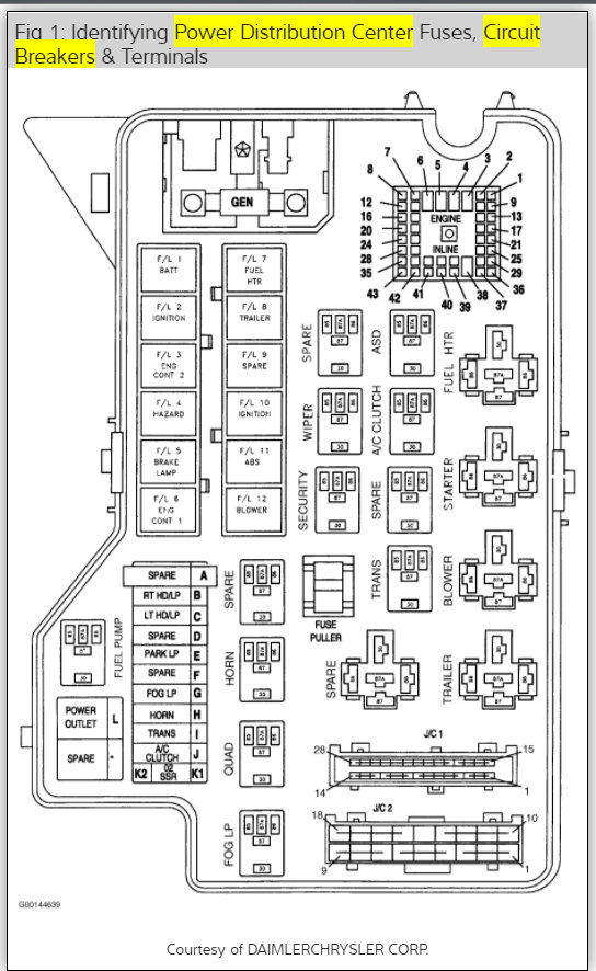

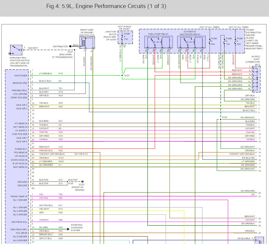

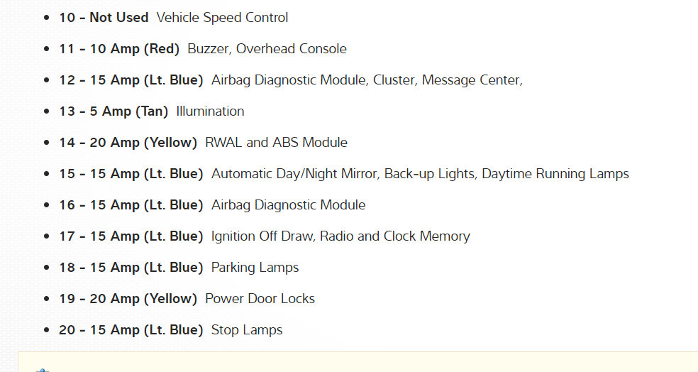

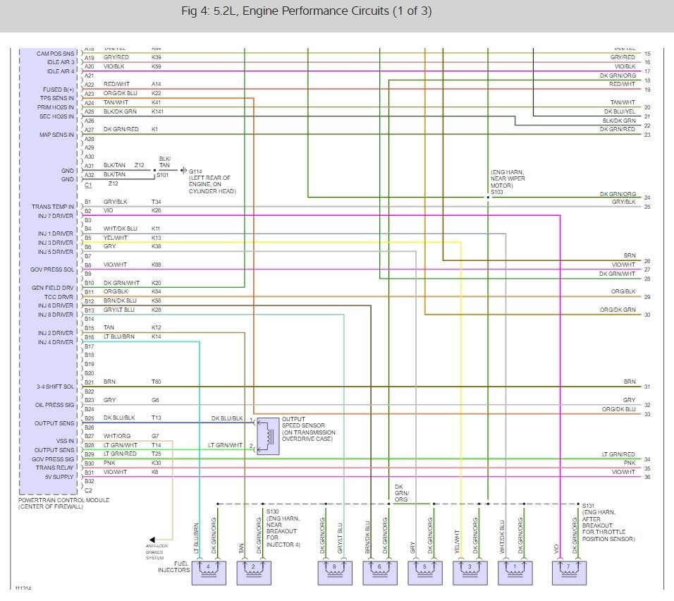

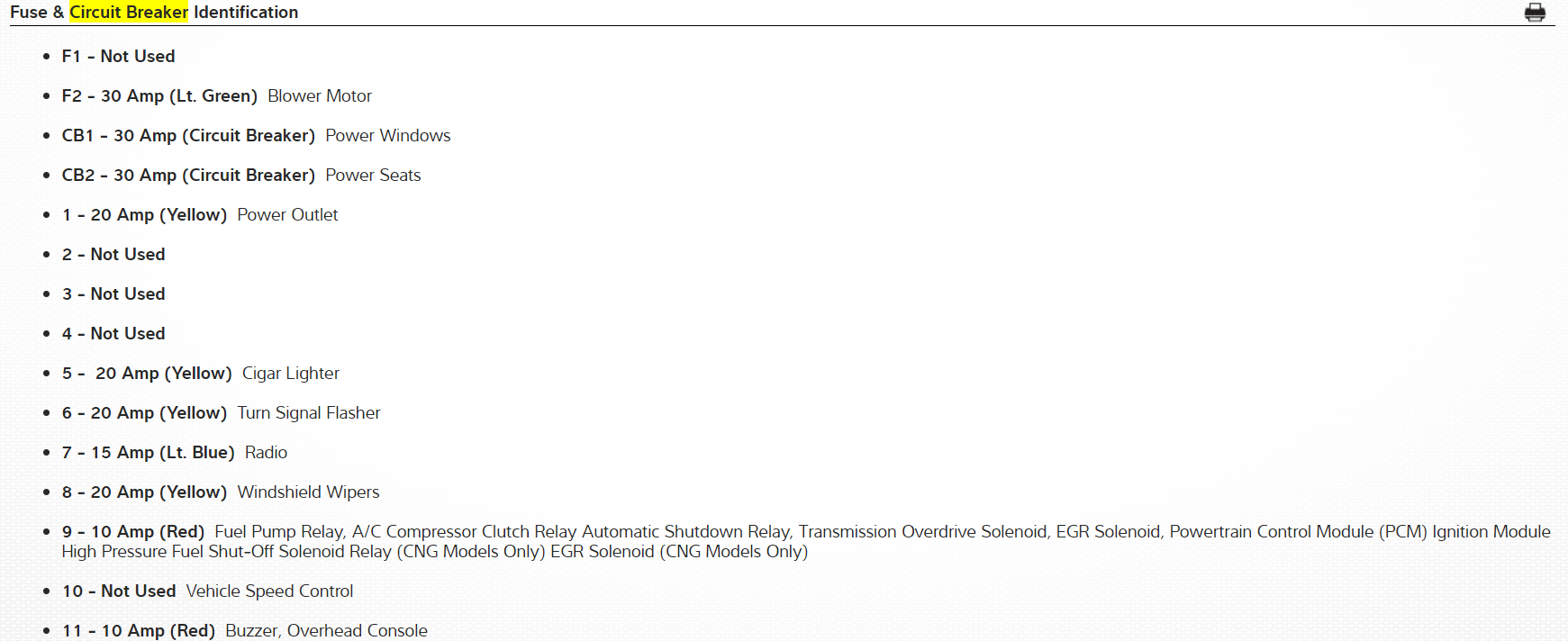

It sounds like you have a fuse out somewhere in the truck. Here is a guide and some wiring and fuse panel diagrams so you can do some easy testing to find the problem.
and

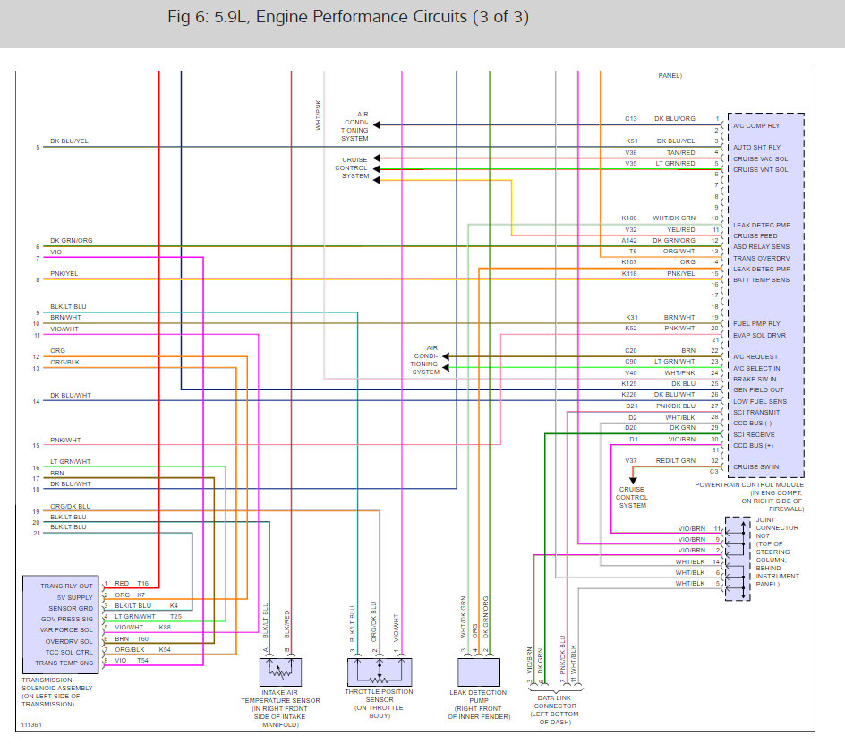

That is a good clue. The no bus indicates there is no communication between the PCM and its components. Just remove the wiring harness to it and check for corrosion and make sure everything is tight.
Let me know what you find.
PS: I believe what you described is the PCM and usually they are either good or bad, so my guess is a bad connection or broken wire.

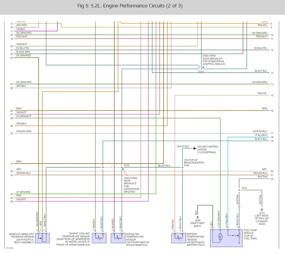

Below is fuel pump and engine wiring diagrams along with fse panel information.
Cheers!

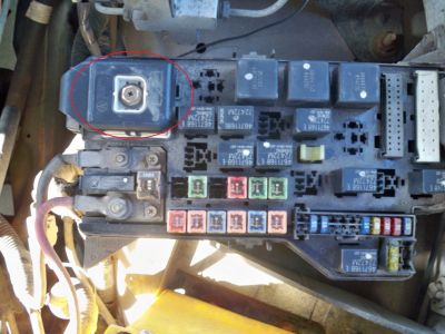

Found the problem! It was the "engine inline" plug that plugs into the black fuse box under the hood that houses the relays etc. See picture (top left hand corner of box). I unscrewed the screw (noticed it was a little loose). cleaned contacts on the pins with contact cleaner and then applied dialectric grease to the contacts; screwed it back in place and it has been running like a top ever since. This is one for the books!!! Thanks for all the help. This is a great site!

Great job. That is what was causing the no bus signal. Thanks for using 2carpros.com, and let us know if you have questions in the future.

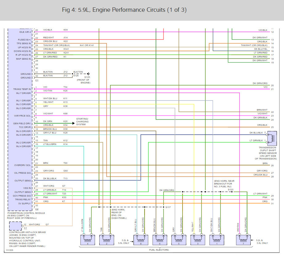

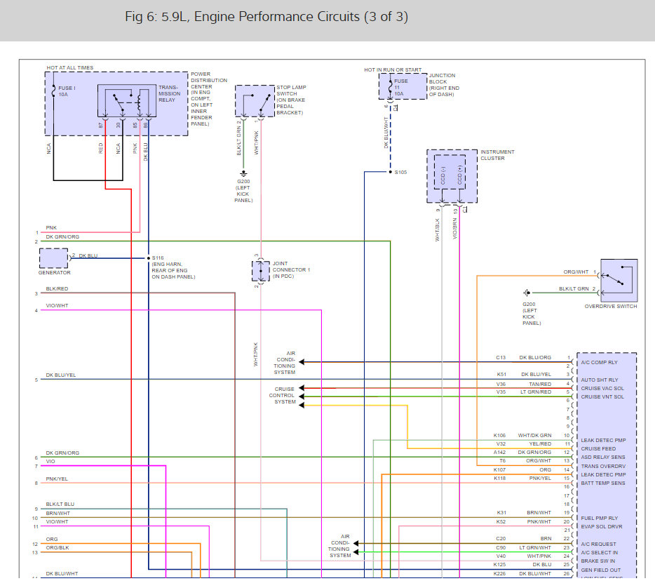

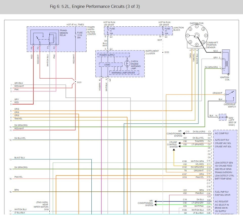

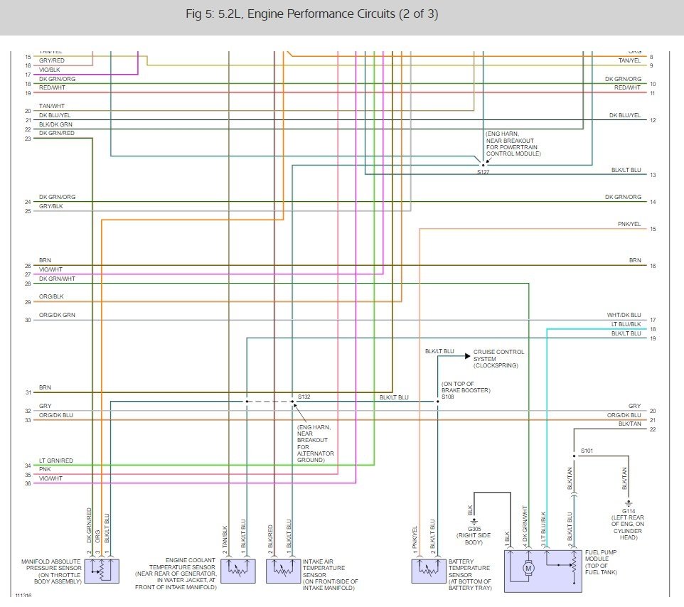

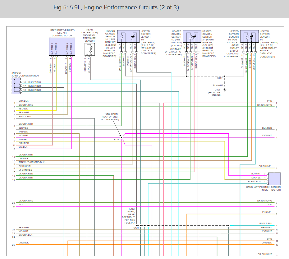

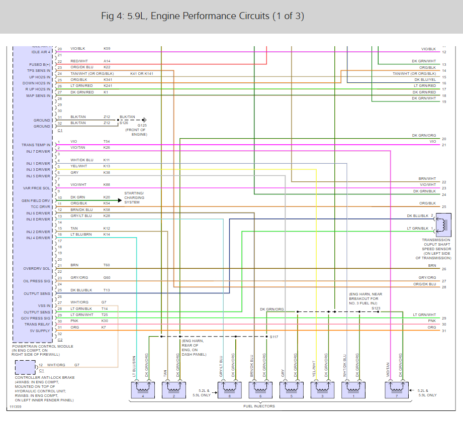

I found the fuel pump and engine wiring diagrams for you (below) just in case someone needs it.

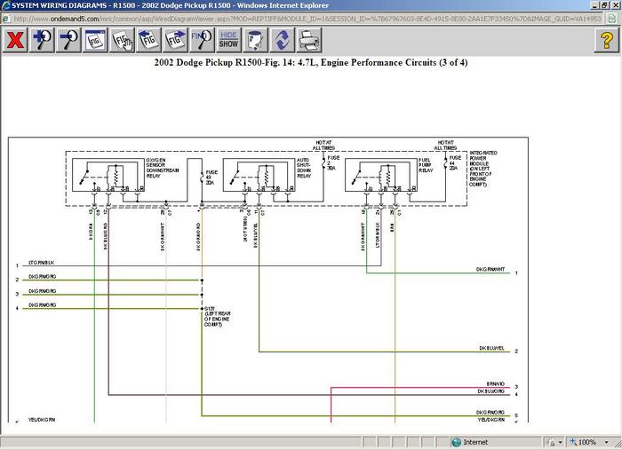

Check and test the fuel pump relay if okay then test or replace the ASD relay. could also be the computer controlled of the ASD relay.

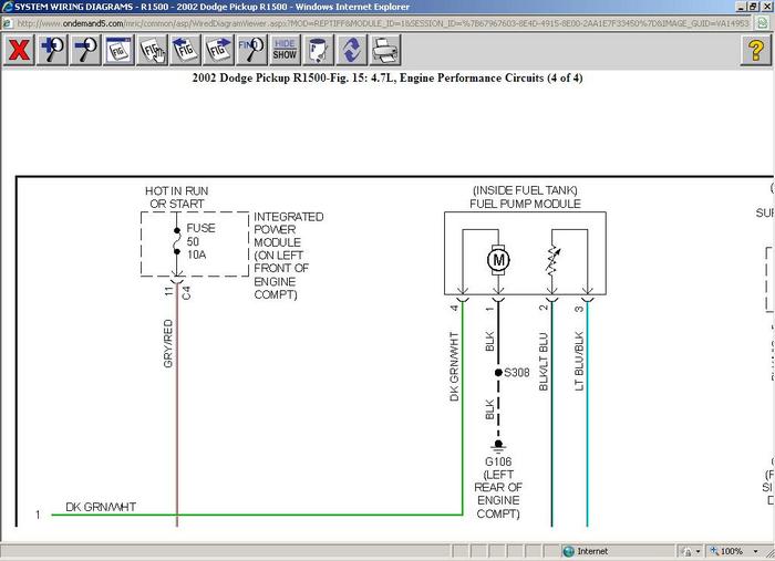

Im trying to replace the fuel pump in my truck but am not sure about the wiring, can you send me a colored diagram. Basically Im trying to find out which is the wire that goes to the power
Nov 22, 2017 at 2:30 AM (Merged)
SATURNTECH9
  • 30,868 POSTS
If its a ram van which model also what size engine?
MRSSALAS08
  • 8 POSTS
It is a 2002 Dodge Ram 1500 Truck with a 4.7 engine, like I marked on the section before the question
SATURNTECH9
  • 30,868 POSTS
There you go also as you can see the model and engine size doesnt show up on the question you asked.Atleast not that iam able to read and see thats why i asked.

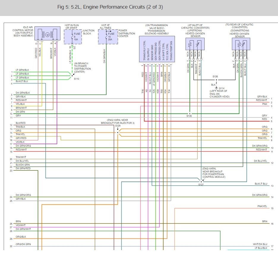

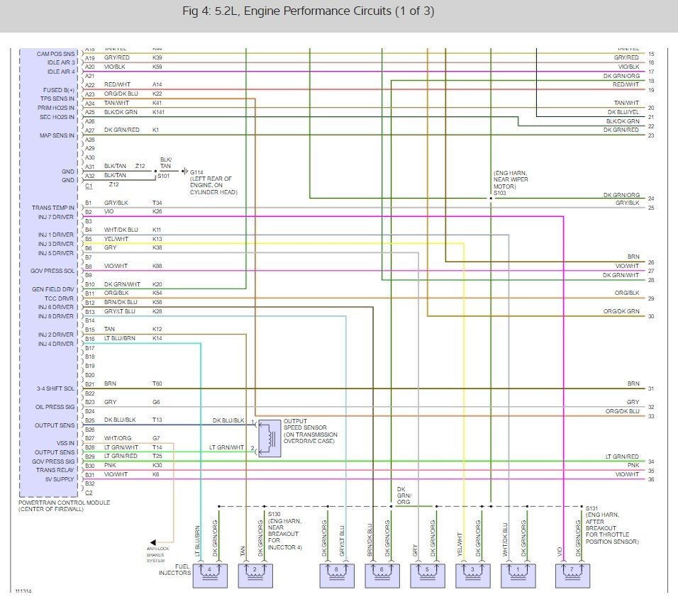

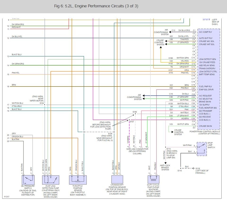

DODGERAM
was wondering where i can find a engine wiring harness diagram for a 98 dodge ram 1500 5.2L maunal trans
CJ MEDEVAC
  • 11,000 POSTS
There are a bunch of 'em......can you narrow down the systems you need?....Or Not?
I'll be up till about 0130 Eastern....or are they like super important....Right now!
The Medic
CARADIODOC
  • 34,417 POSTS
Hi guys. What's the symptom or problem you're trying to solve?
CJ MEDEVAC
  • 11,000 POSTS
Doc, I finally got back into Mitchell 1
He's wanting a wiring diagram....in M1, ain't just one, there's a lot of 'em
Soon as he does respond, I was gonna get his address, in messages (as for the world not to see it, like you can here!), as he probably will not have a good view of them, on the site......Probably better if I sent 'em via his Email.
Don't matter to me, here or at Email?!
I was just seeing if he needed specific parts of the diagram, or must I spend a great deal of time getting all of the diagrams!
I'm Tryin' to get over!.......That's what it boils down to!......He just ain't come back yet!
