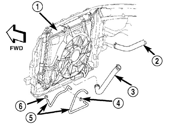

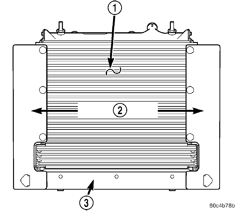

I got stuck at the bottom of a really muddy slick hill and I got stuck up. i had to get pulled by a chain up the hill to get unstuck. So i had someone else to drive my car out of there and when they were pulling my car out the chain came unloose and when he re-hooked the chain up to my car he must have hooked the chain up to my radiator or something because when they pulled it all the way up out of there i walked up the hill behind it and i saw a bunch of dark brownish looking fluid everywhere. looked kind of like oil and two rubber circle plug pieces that were broke off laying on the ground too. i hurried up and took it close to park it and it started running hot and they looked under it and said that my radiator was busted it had a hole in it. I have a radiator out of a Suzuki Sidekick car that he gave me to use to replace my bad one with. He took a tape measure and measured the radiator and he said he thinks it will fit. Do you think that i will be able to use that good radiator out of the Suzuki Sidekick car to put in my car? And how do i take my radiator out and how do i put that one out of the Suzuki back into my car correctly and what all fluids and parts do i need to have to fix it with?

Honestly, I can help you with the removal and replacement of a direct fit part, but I have no idea if the other will work. There are specific mounting points, radiators have different capacities, they have different core thickness for different coolant abilities, if your car is an automatic, then it will have transmission cooling lines to it in a specific place, the radiator hoses could be located in different places and could be different sizes, the cooling fans have to mount to it and the list goes on. Without being there, I have no idea what exactly you are facing. I strongly recommend getting a direct fit part in this case.
_________________________________
Here are the directions for replacing the radiator with a direct fit part. The attached pics correlate with the directions. You will see in the pics, there are a lot of mounting points for different things that are needed and will most likely not be the same on the Suzuki radiator.
PROCEDURES
RADIATOR
REMOVAL
pic 1
WARNING: Do not open the radiator draincock with the system hot and under pressure because serious burns from coolant can occur.
NOTE: It is not necessary to discharge the air conditioning system to remove the radiator.
1. Drain cooling system.
2. Remove radiator fan.
3. Turbocharger Equipped Vehicles: Disconnect and cap the power steering hoses.
4. Disconnect lower radiator hose (3).
5. Non-Turbo Vehicles with Automatic Transmission: Remove two fasteners attaching transmission oil cooler to radiator.

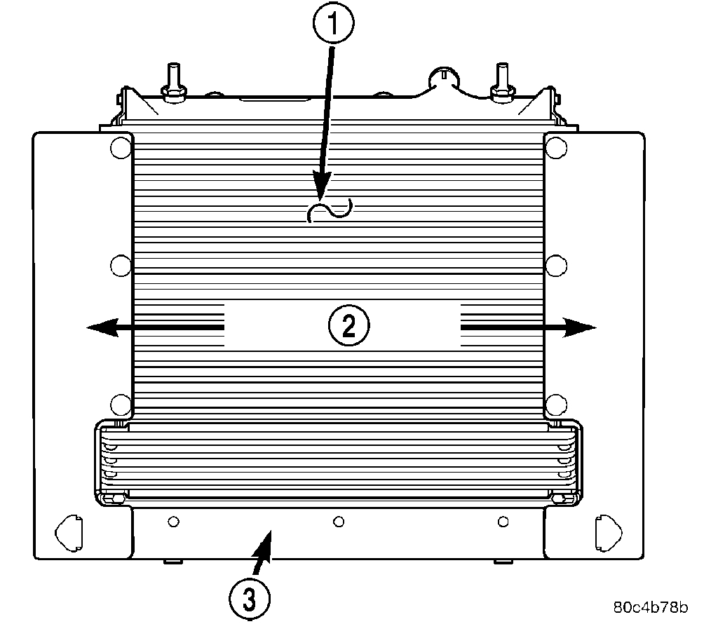

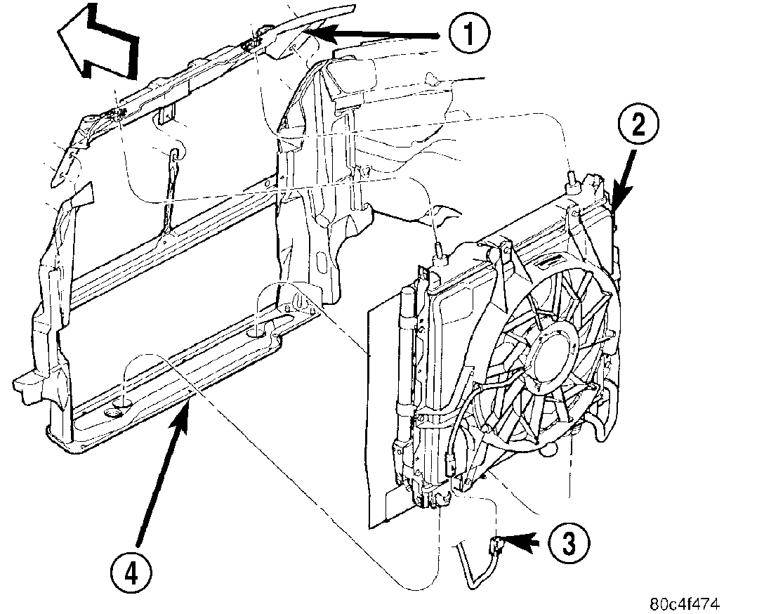

pic 2
6. Non-Turbo Vehicles: Remove lower radiator air seal from side radiator air seals (2, 3).

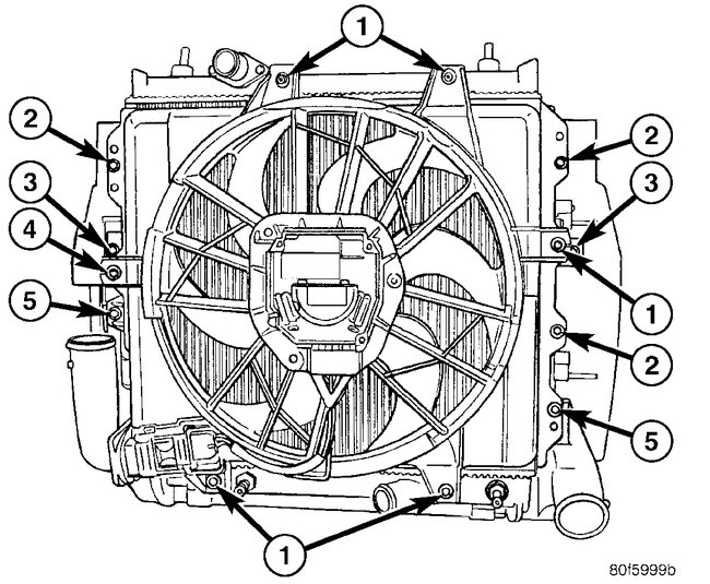

pic 3
7. Remove fasteners (2) attaching AC condenser to radiator. Reposition AC condenser.
8. Turbocharger Equipped Vehicles: Remove fasteners (5) attaching charge air cooler to radiator.

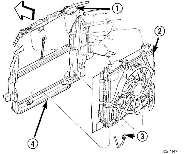

pic 4
9. Remove radiator assembly (2) by lifting it up from the engine compartment. Care should be taken not to damage the cooling fins and tubes during removal.
10. Non-Turbo Vehicles: Remove the lower air seal from radiator.

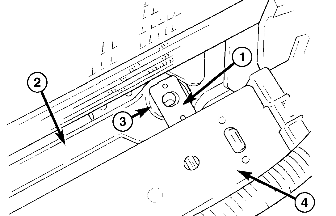

pic 5
1. Non-Turbo Vehicles: Install the lower air seal to radiator.
NOTE: Turbocharger Equipped Vehicles: When lowering radiator, make sure lower radiator pins engage properly through charge air cooler locating tabs (1).
2. Position radiator into mounting position.
3. Position A/C condenser against radiator. Hand start fasteners.
4. Turbocharger Equipped Vehicles: Install fasteners attaching charge air cooler to radiator. Torque fasteners to 8 Nm (70 inch lbs.).

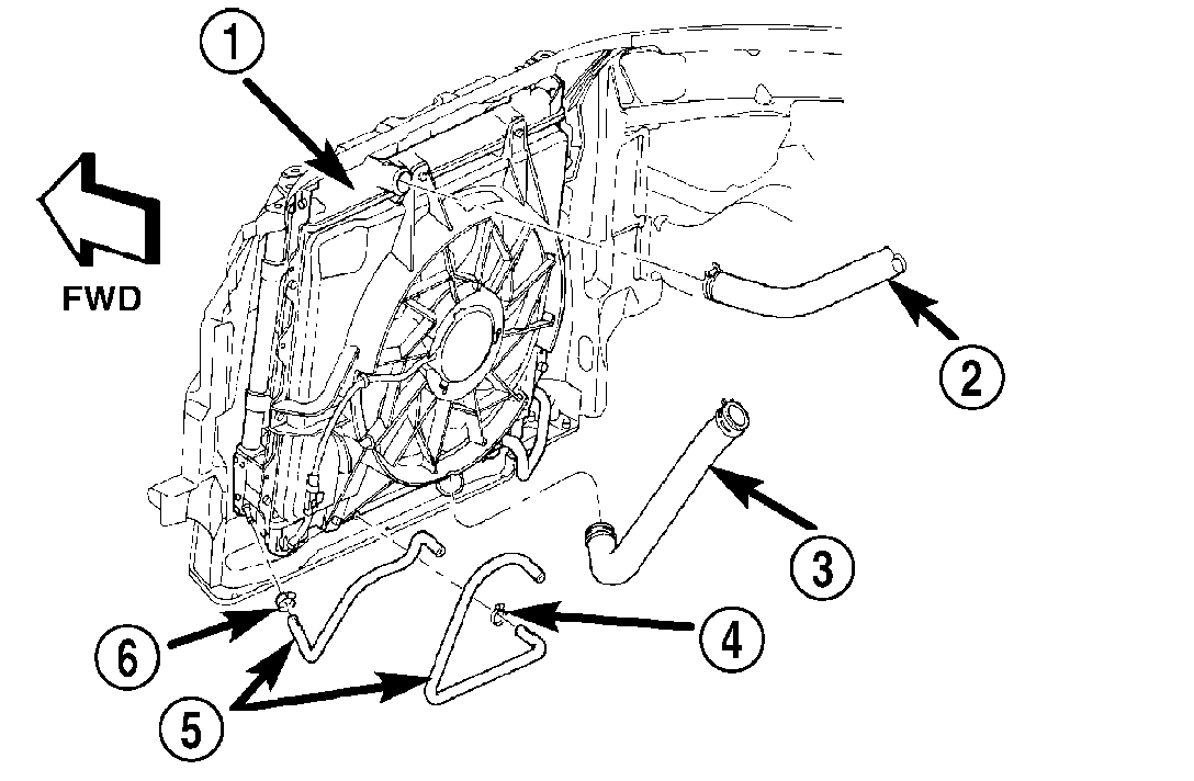

pic 6
5. Install radiator fan/shroud assembly. Hand start fasteners.
6. Torque all condenser fasteners to 8 Nm (70 inch lbs.).
7. Torque all radiator fan fasteners to 6 Nm (55 inch lbs.).
8. Non-Turbo Vehicles with Automatic Transmission: Install fasteners attaching transmission oil cooler to radiator. Torque fasteners to 8 Nm (70 inch lbs.).

10. Non-Turbo Vehicles: Connect the lower air seal to the side air seals.
