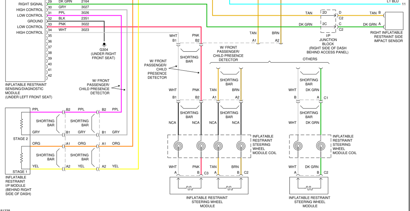

I think my airbag clock spring is bad. How do I diagnose it?

There are 2 types of driver air bag, with single or dual stage ignition
So, the clock spring will either have 1 or 2 airbag squibs.
You will need to remove the steering wheel air bag to carry out any tests on the airbag clock spring.

See image below for wiring/pin data
Continuity testing is best done using a voltmeter on ohm setting.
