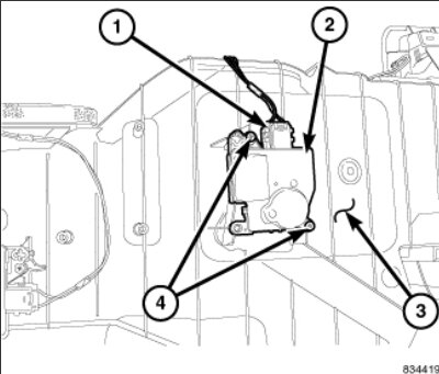

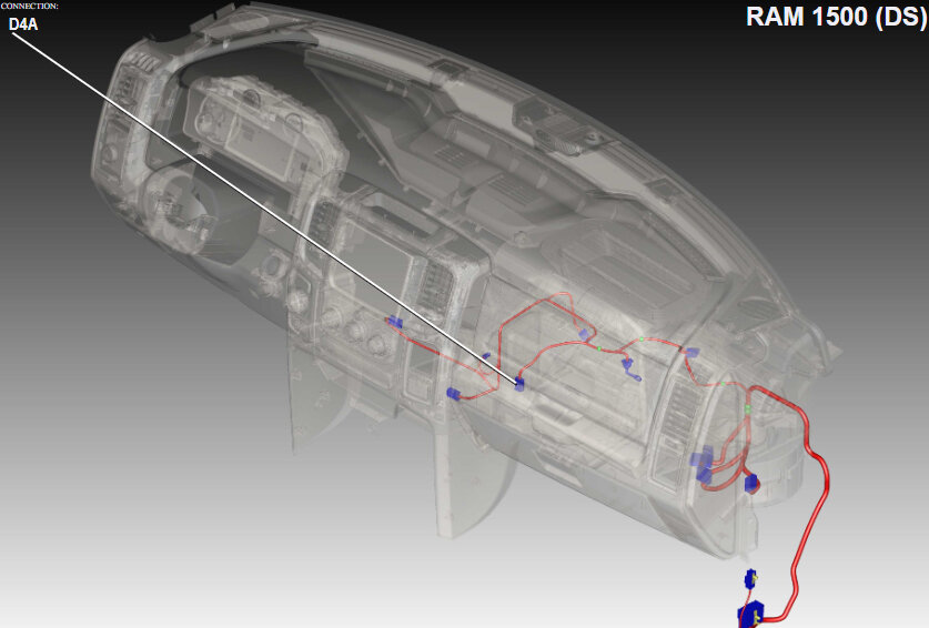

Where is the A/C actuator blend door that controls driver's side located?
2019 RAM 1500
95,000 MILES • 5.7L • V8 • 4WD • AUTOMATIC
ETHANVIE
In the middle of July, the A/C works great on the passenger side of vehicle but the driver side and backseat both blow hot air. I’m thinking it a faulty blend door actuator. Could Use all the help I could get. I have the dash apart and trying to locate the correct actuator.
Aug 8, 2025 at 9:21 PM
  • 54,837 POSTS
Yep, good call, the driver's side blend door actuator is a common failure, here is the location to make sure you get the correct part replaced to help fix the problem. To be sure you have the correct actuator with the part removed, turn the system on and work the door pivot be hand to see if the driver side changes. You will need to remove the glove box which it sounds like you have already done. Check out the images (below). Let us know how it goes.
Aug 9, 2025 at 11:32 AM
