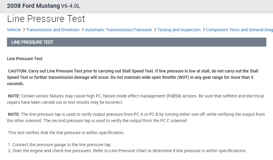

My overdrive was blinking, so I changed all the solenoid block and transmission filter and put new transmission fluid but after I drove it the overdrive still goes off. I had it read and it was pressure control solenoid b, what would that be?

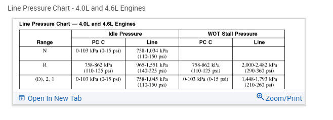

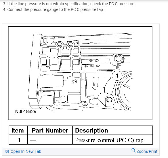

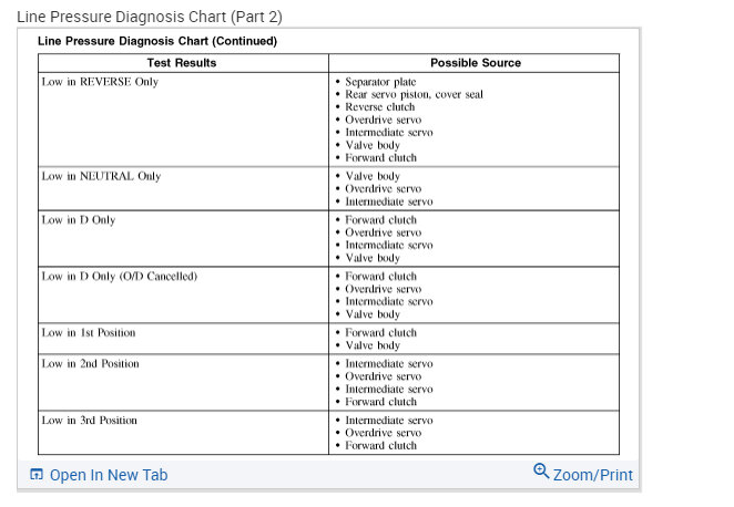

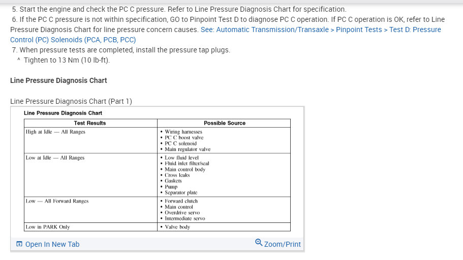

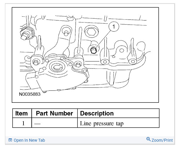

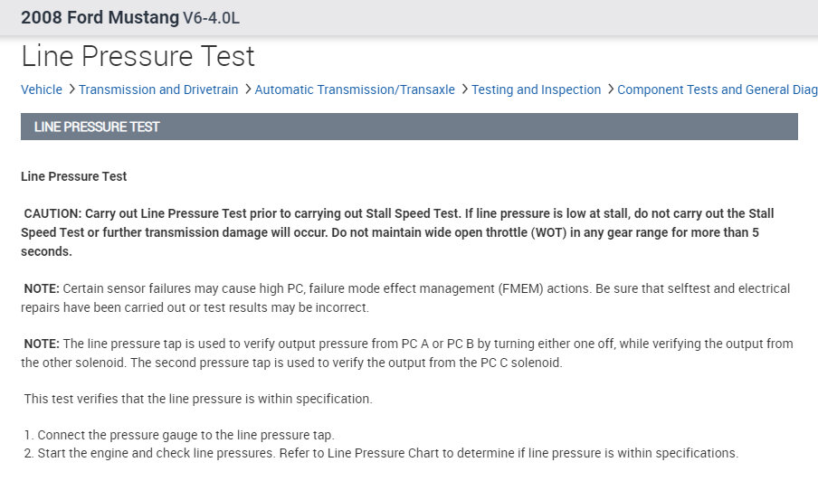

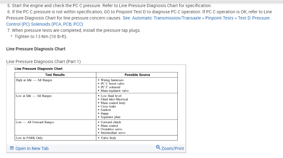

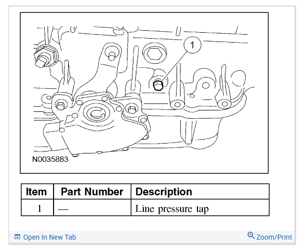

If that isn't an option, then line pressure will need to be tested. I attached the directions below. You will need a pressure tester, but often times a parts store will provide one free of charge.
