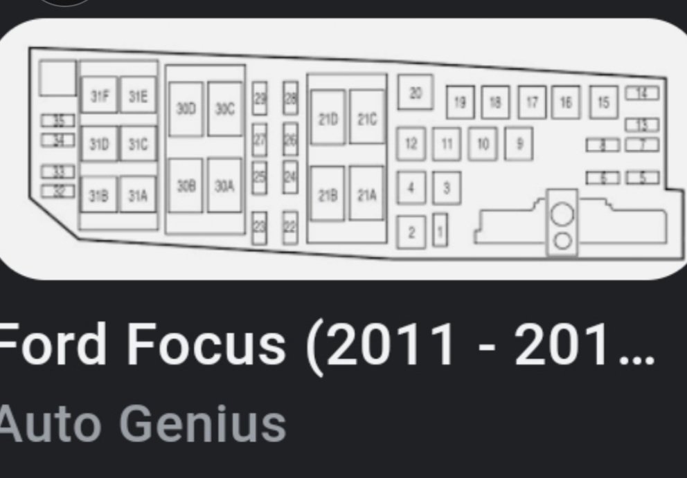

I traced the wiring for the failed components back to the MIDI fuse (100 amp) in the under-hood battery junction box.

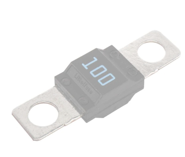

I attached a pic below of the fuse box (pic 1), but the legend doesn't show its location. I circled where approximately I feel it would be. Also, I attached a pic showing what a MIDI fuse looks like. It isn't the traditional fuse type. (pic 2)
Use a test light and check both sides of the fuse for power. If there is power only on one side, replace it.
Let me know what you find.

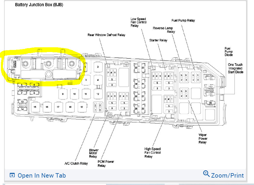

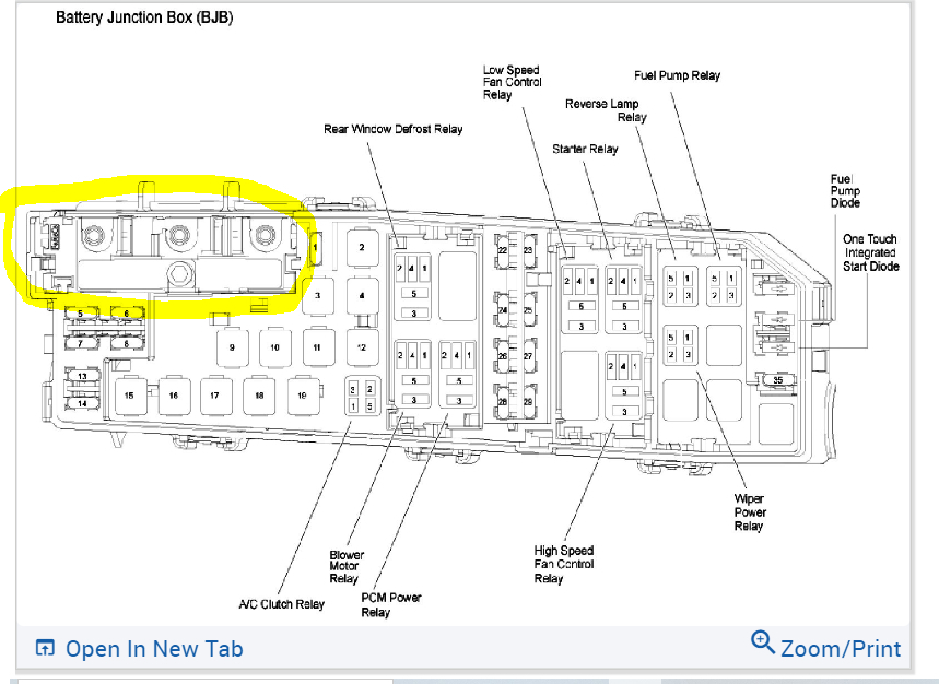

I forgot to mention that I put a new Interstate Battery in my car after I had replaced the blown fuses under the dash. After reading your response. I went to look for the MIDI fuse. This is what my battery fuse box looks like. See attachment. I used the test light to check the MIDI fuse on both sides on top (in the attached picture is the MIDI on the bottom, right?).
The light lit up on both sides of the MIDI. Something told me to recheck some of the fuses under the dash again. I did and some of the fuses blew when I installed the new battery. I got the correct battery. I pulled one of the blown fuses #8 and replaced it. It immediately blew. Any suggestions?
