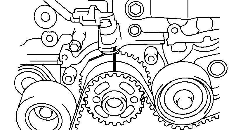

I’ve been having a problem for a while now. I have cylinders 1 and 3 with a misfire and there’s this odd ticking sound coming from it, but when the plugs are off from both the sound is gone and the oil smells like gas and there is smoke coming out from the exhaust. I did a compression test and they both came down low to 90 psi and the car shakes really bad. I was wondering if anyone has any ideas as to what it could be?
Dec 27, 2019 at 11:13 PM
  • 110,194 POSTS
The manufacturer's minimum spec for compression is 120 psi if you have 90, that is the problem. The idea that you smell fuel in the oil is most likely because it isn't getting burned in the cylinders. I suspect this is a head gasket issue or timing issue.
Can you tell me what color smoke is coming from the exhaust? Also, let me know if you have checked timing.
Dec 27, 2019 at 11:20 PM
JOANI321
The timing is spot on and the color of the smoke is white. And if it is the head gasket what would I need to do other then replacing it?
Dec 27, 2019 at 11:32 PM
  • 110,194 POSTS
If the smoke is white, chances are it is burning engine coolant. It burns white when it enters the combustion chamber.
Here are directions for replacing the head gasket. Once the heads are off, you should have them checked to see if they are warped or damaged in any way.
Next, if I was replacing the head gaskets, I would also replace the timing belt and all associated components and the water pump at the same time.

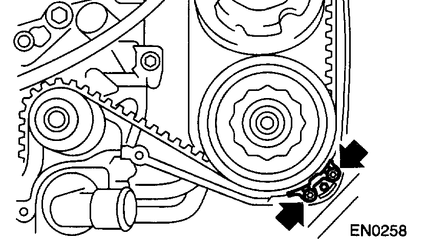

Here are directions for cylinder head removal and replacement. The attached pictures correlate with the directions.

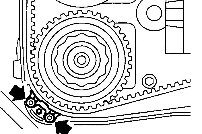

1. Remove the V-belt.
2. Remove the crankshaft pulley.
3. Remove the belt cover.
4. Remove the timing belt assembly.
5. Remove the camshaft sprocket.
6. Remove the intake manifold.
7. Remove the bolt which installs the A/C compressor bracket on cylinder head.
8. Remove the camshaft.

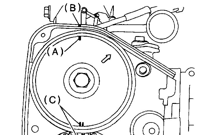

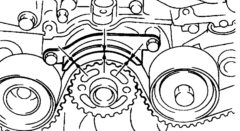

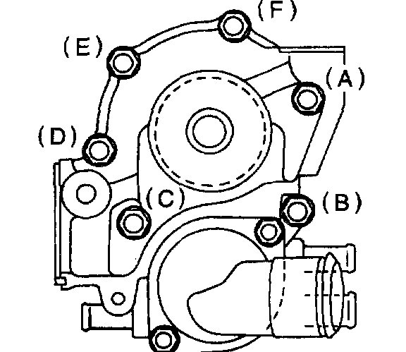

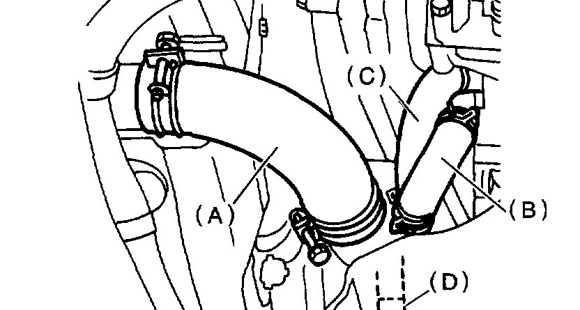

pic 1

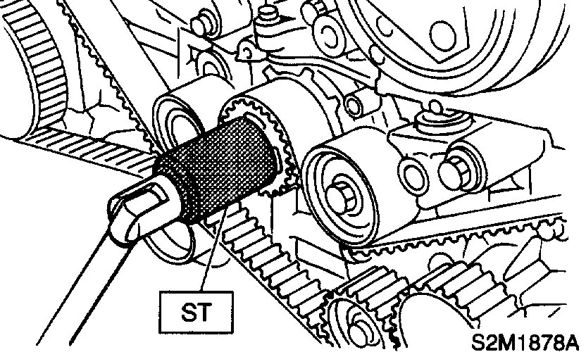

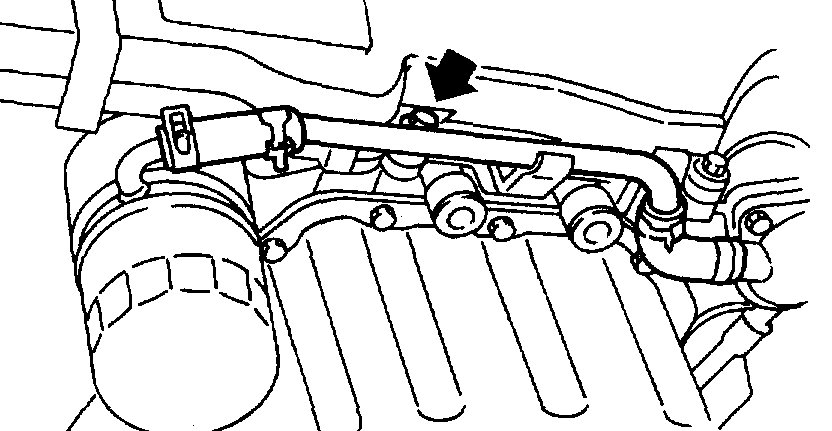

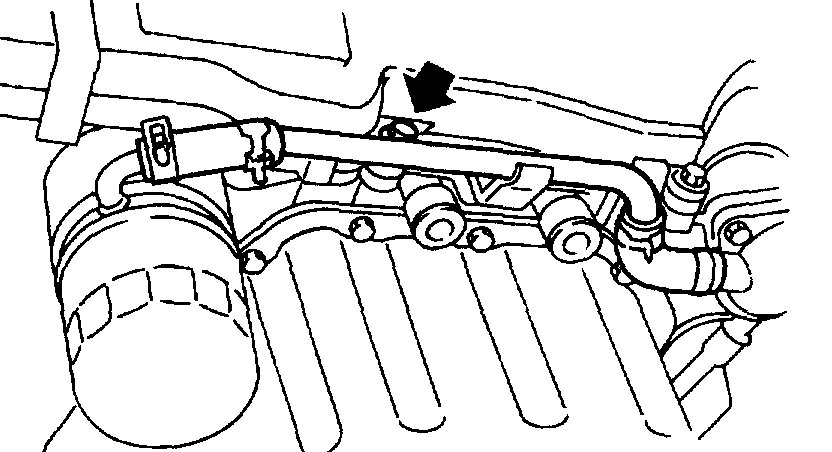

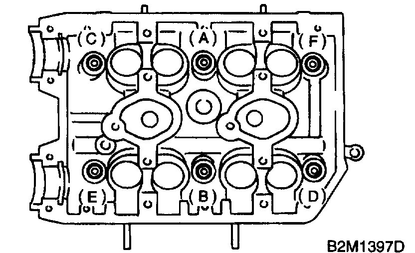

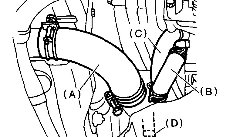

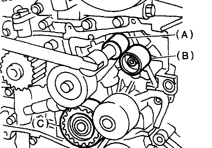

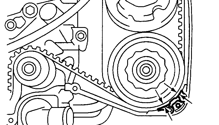

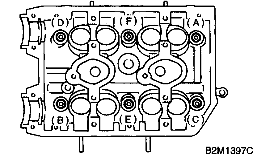

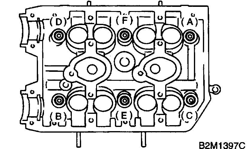

9. Remove the cylinder head bolts in alphabetical sequence shown in the figure.
CAUTION: Leave bolts (A) and (D) engaged by three or four threads to prevent the cylinder head from failing.
pic 2
10. While tapping the cylinder head with a plastic hammer, separate it from cylinder block. Remove the bolts (A) and (D) to remove the cylinder head.
11. Remove the cylinder head gasket.
CAUTION: Do not scratch the mating surface of cylinder head and cylinder block.
12. Similarly, remove the right side cylinder head.

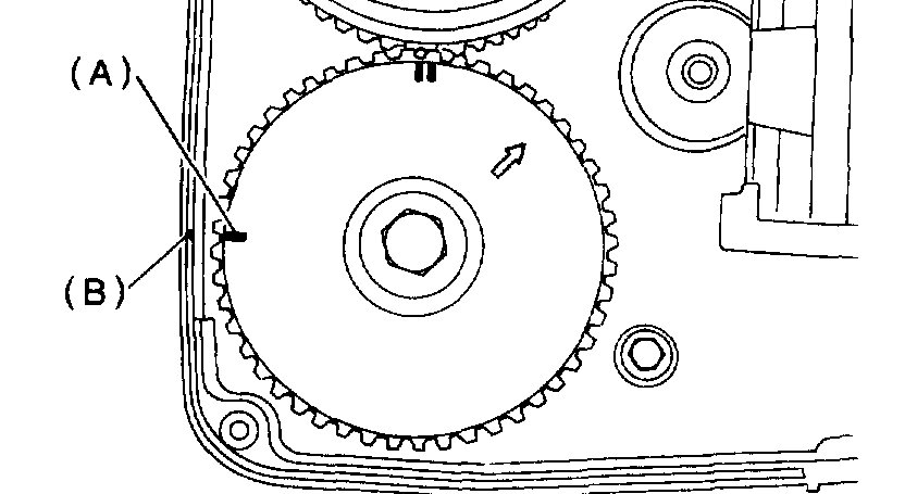

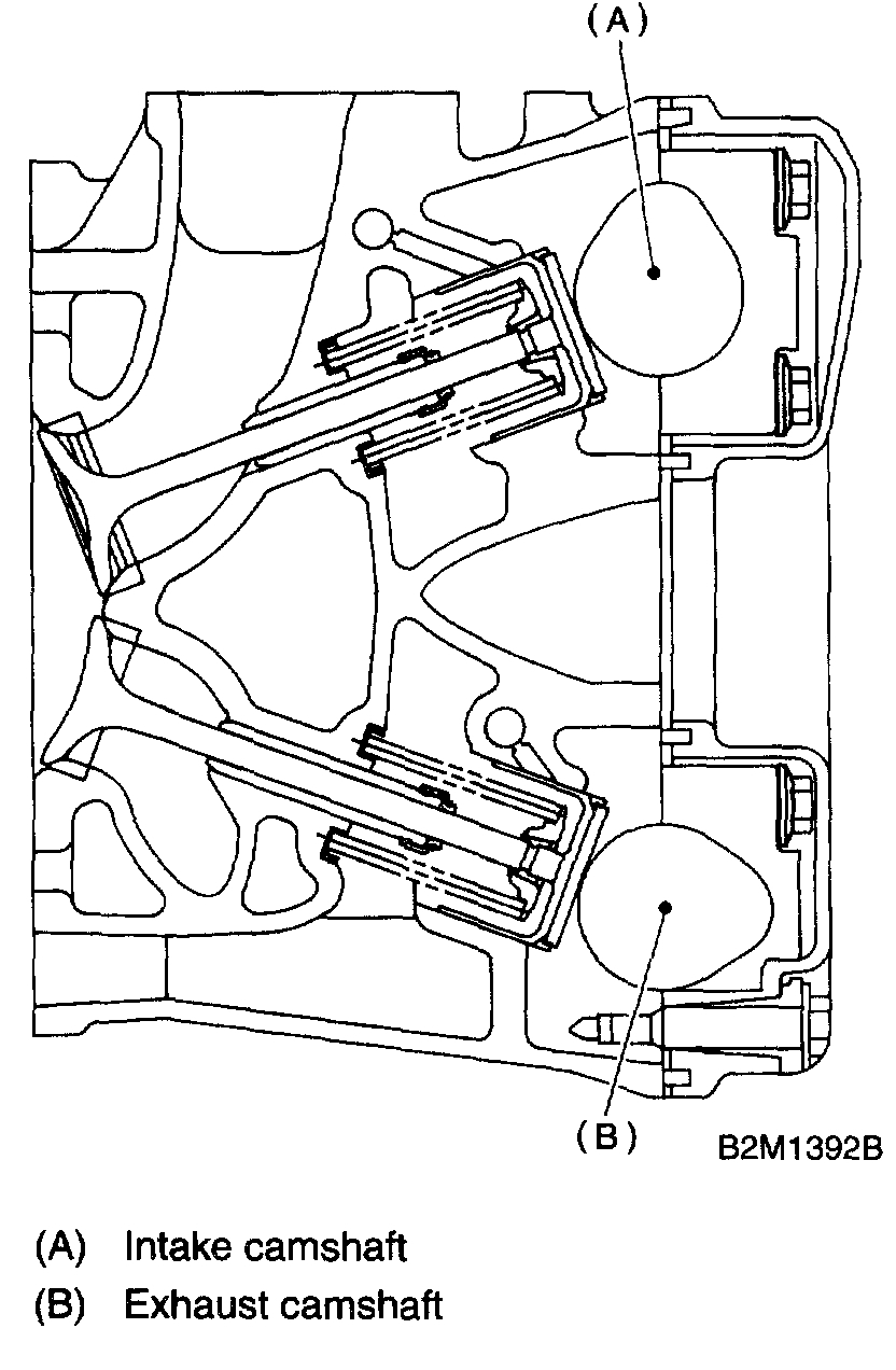

2. Tighten the cylinder head bolts.
a. Apply a coat of engine oil to washers and bolt threads.

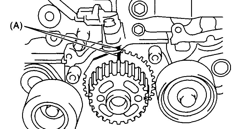

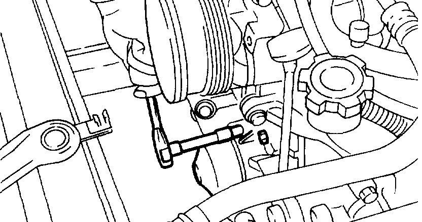

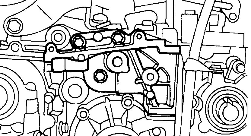

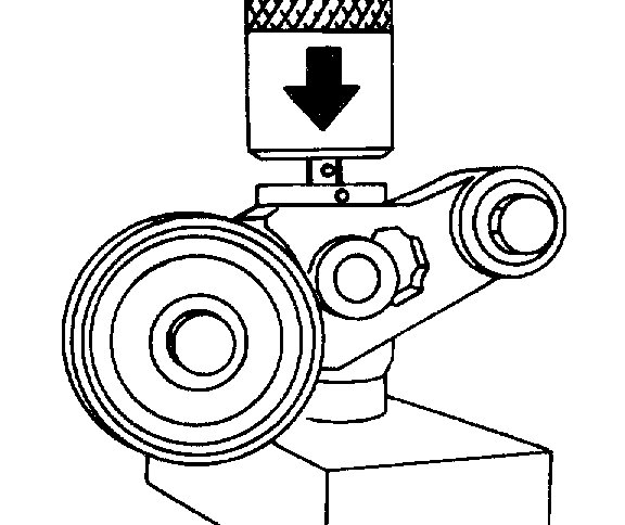

b. Tighten all bolts to 29 Nm (3.0 kgf-m, 22 ft-lb) in alphabetical sequence. Then tighten all bolts to 69 Nm (7.0 kgf-m, 51 ft-lb) in alphabetical sequence.
c. Back off all bolts by 180° first; back them off by 180° again.
pic 3

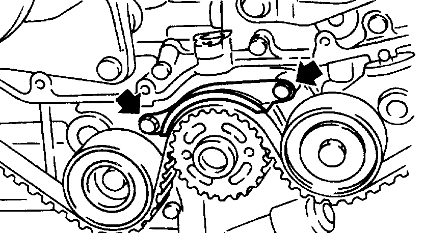

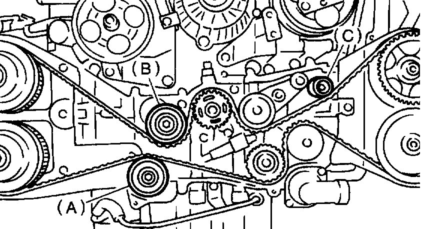

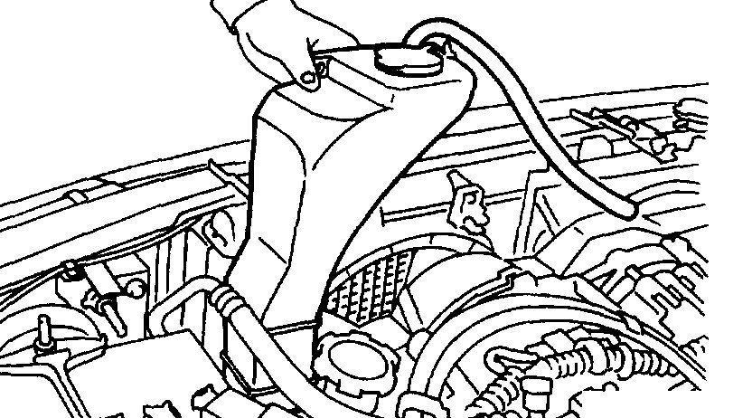

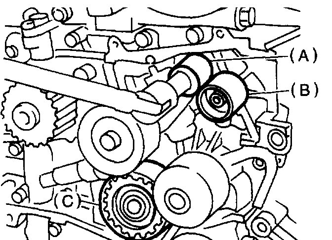

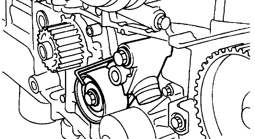

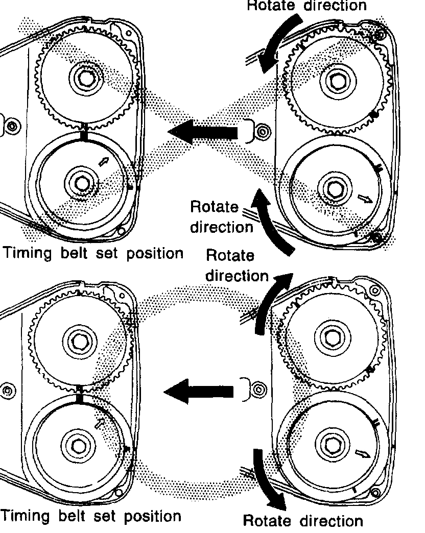

d. Tighten the bolts (A) and (B) to 34 Nm (3.5 kgf-m, 25 ft-lb).
pic 4
e. Tighten the bolts (C), (D), (E) and (F) to 15 Nm (1.5 kgf-m, 11 ft-lb).

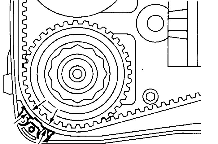

Here are the directions for replacing the timing belt. You will need this to make sure timing is correct before you try starting it.
2002 Subaru Impreza WRX Sedan F4-2.0L DOHC Turbo
Timing Belt Replacement
Vehicle Engine, Cooling and Exhaust Engine Service and Repair Procedures Disassembly and Assembly Timing Belt Replacement
TIMING BELT REPLACEMENT
REMOVAL

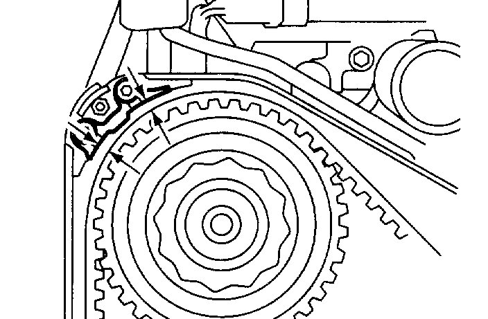

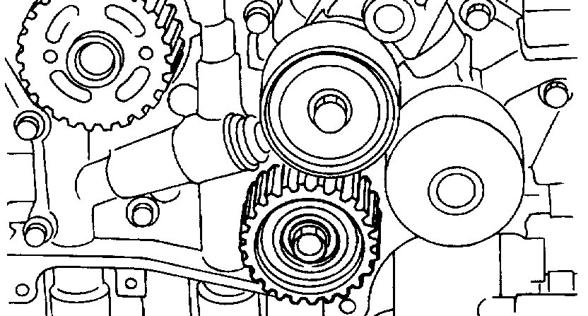

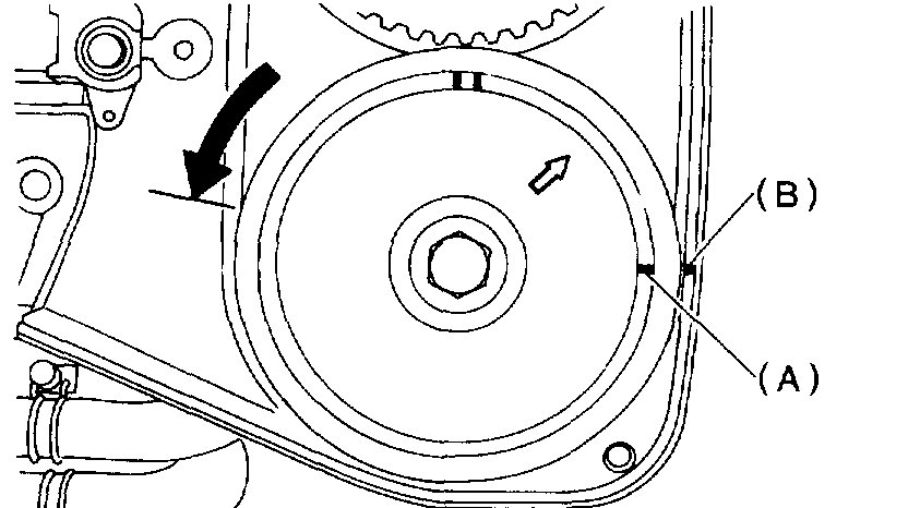

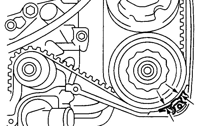

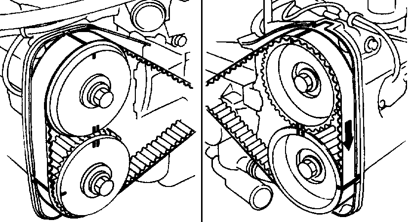

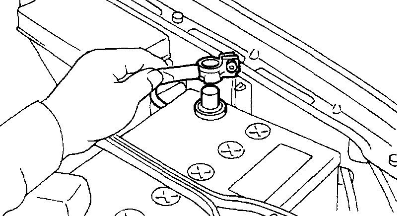

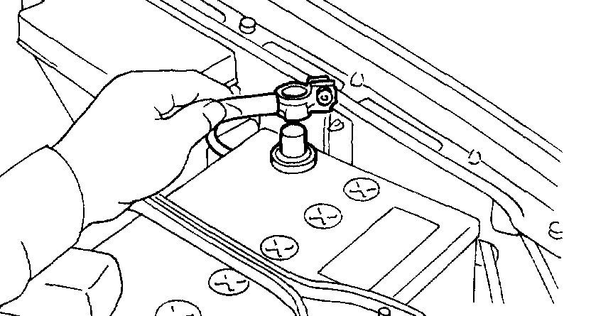

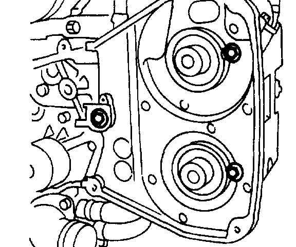

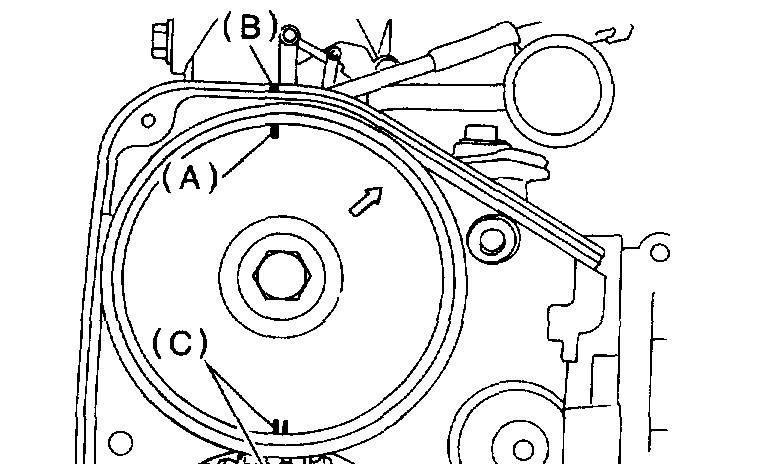

1. TIMING BELT

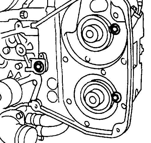

a. Remove the V-belt.
b. Remove the crankshaft pulley.

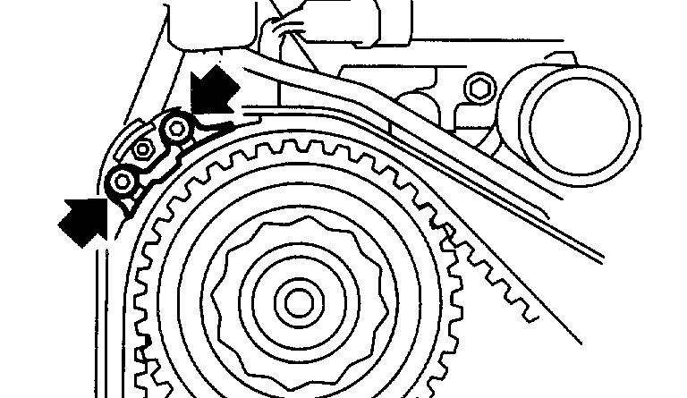

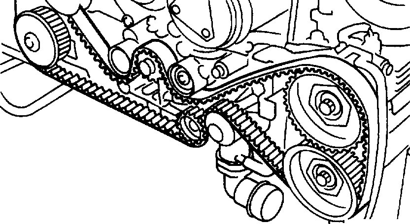

c. Remove the belt cover.
pic 5

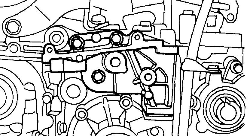

1 of 4
pic 6
2 of 4
pic 7
3 of 4
pic 8
4 of 4
d. Remove the timing belt guides. (MT vehicle)

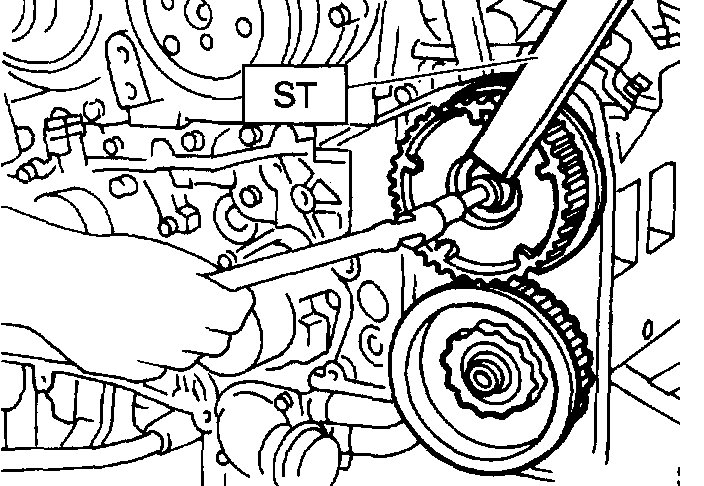

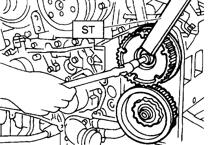

e. If the alignment mark and/or arrow mark (which indicates rotation direction) on timing belt fade away, put new marks before removing the timing belt as follows:
pic 9
1. Turn the crankshaft using ST, and align alignment marks on crankshaft sprocket, left-hand intake camshaft sprocket, left-hand exhaust camshaft sprocket, right-hand intake camshaft sprocket and right hand exhaust camshaft sprocket with notches of belt cover and cylinder block.
ST 499987500 CRANKSHAFT SOCKET
pic 10
1 of 2
pic 11
2 of 2

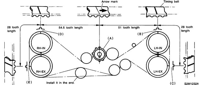

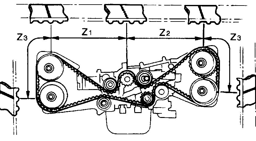

2. Using white paint, put alignment and/or arrow marks on the timing belts in relation to the sprockets.
pic 12
Z1: 54.5 tooth length
Z2: 51 tooth length
Z3: 28 tooth length
pic 13

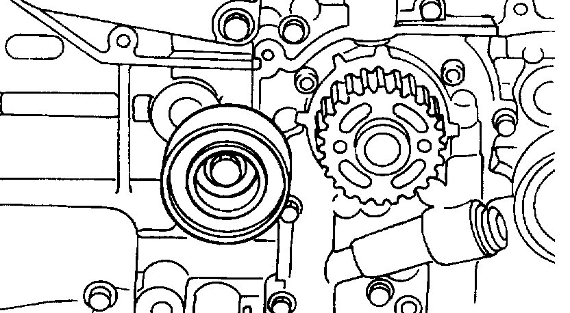

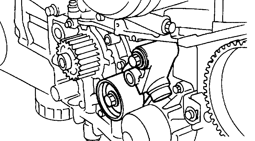

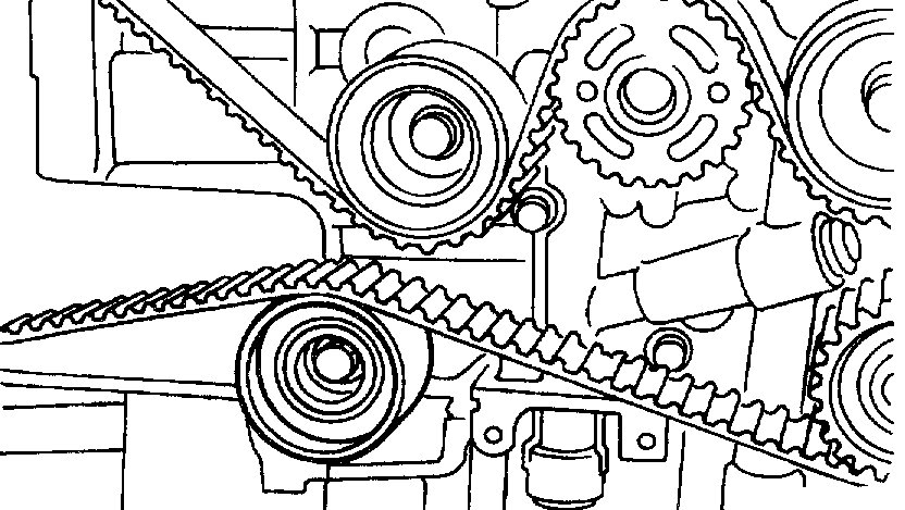

f. Remove the belt idler (A).
g. Remove the timing belt.
CAUTION: After the timing belt has been removed, never rotate the intake and exhaust, camshaft sprocket. If the camshaft sprocket is rotated, the intake and exhaust valve heads strike together and valve stems are bent.
2. BELT IDLER AND AUTOMATIC BELT TENSION ADJUSTER ASSEMBLY
pic 14
a. Remove the belt idler (B) and (C).
pic 15
b. Remove the belt idler No. 2.
pic 16
c. Remove the automatic belt tension adjuster assembly.

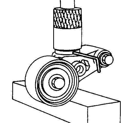

^ Be sure to slowly move the adjuster rod down applying a pressure of 294 N (30 kgf, 66 lbs.).
^ Press-in the push adjuster rod gradually taking more than three minutes.
^ Do not allow press pressure to exceed 9,807 N (1,000 kgf, 2,205 lbs.).
^ Press the adjuster rod as far as the end surface of the cylinder. Do not press the adjuster rod into the cylinder. Doing so may damage the cylinder.
^ Do not release the press pressure until stopper pin is completely inserted.
1. Attach the automatic belt tension adjuster assembly to the vertical pressing tool.
pic 17
2. Slowly move the adjuster rod down with a pressure of 294 N (30 kgf, 66 lbs.) until the adjuster rod is aligned with the stopper pin hole in the cylinder.
pic 18
3. With a 2 mm (0.08 inch) diameter stopper pin or a 2 mm (0.08 inch) (nominal) diameter hex bar wrench inserted into the stopper pin hole in the cylinder, secure the adjuster rod.

pic 22

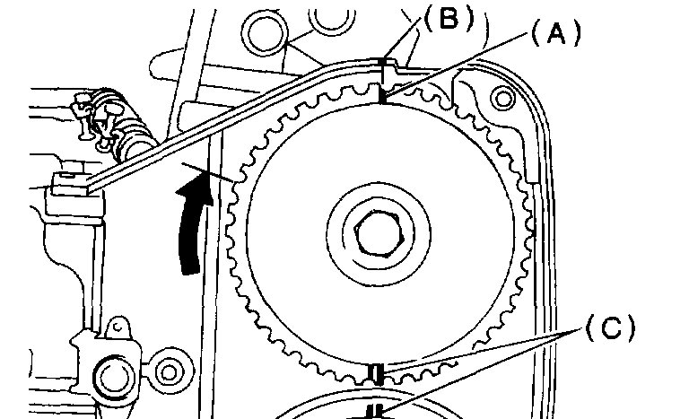

1. Align mark (A) on the crankshaft sprocket with mark on the oil pump cover at cylinder block.
pic 23
2. Align single line mark (A) on the right-hand exhaust camshaft sprocket with notch (B) on belt cover.
pic 24
3. Align single line mark (A) on the right-hand intake camshaft sprocket with notch (B) on belt cover. (Make sure double lines (C) on intake camshaft and exhaust camshaft sprockets are aligned.)
pic 25
4. Align single line mark (A) on left-hand exhaust camshaft sprocket with notch (B) on belt cover by turning the sprocket counterclockwise (as viewed from front of engine).
pic 26
5. Align single line mark (A) on left-hand intake camshaft sprocket with notch (B) on belt cover by turning the sprocket clockwise (as viewed from front of engine). Ensure double lines (C) on intake and exhaust camshaft sprockets are aligned.
6. Ensure camshaft and crankshaft sprockets are positioned properly.

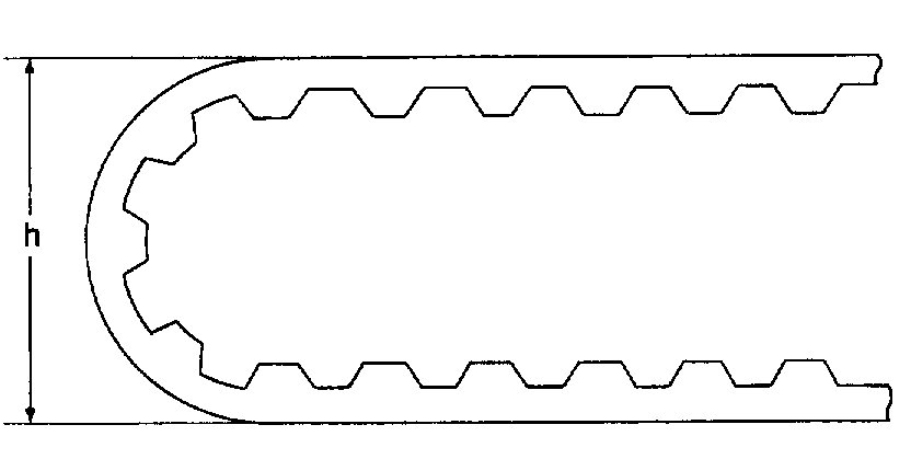

INSPECTION
1. TIMING BELT
a. Check the timing belt teeth for breaks, cracks, and wear. If any fault is found, replace the belt.
b. Check the condition of back side of belt; if any crack is found, replace the belt.
CAUTION:
^ Be careful not to let oil, grease or coolant contact the belt. Remove quickly and thoroughly if this happens.
^ Do not bend the belt sharply.
pic 40
Bending radius: h 60 mm (2.36 inch) or more

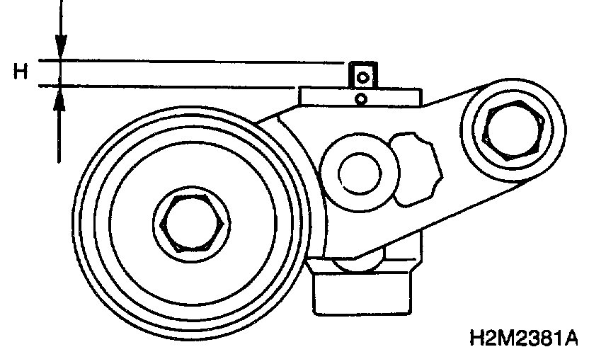

d. Measure the extension of rod beyond the body. If it is not within specifications, replace with a new one.
pic 41
Rod extension: H 5.7 ±0.5 mm (0.224 ±0.020 inch)

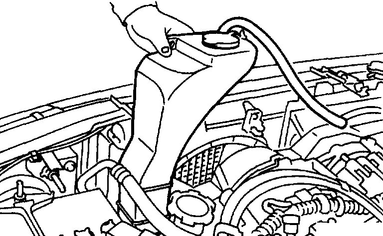

Here are the directions for water pump replacement. I recommend this because the timing belt will need removed to do it in the future, and when replacing the head gaskets, the belt will already be off.
2. TURBO MODEL
WARNING: The radiator is pressurized. Wait until engine cools down before working on the radiator.

2. Disconnect the ground cable from the battery.

pic 44
9. Disconnect the radiator outlet hose (A) and heater hose (B) from the water pump.
10. Disconnect the water by-pass hose (C) and oil cooler hose (D).

pic 45
13. Remove the reservoir tank.
14. Remove the radiator main fan and sub fan assemblies.

16. Remove the timing belt.
pic 46
17. Remove the automatic belt tension adjuster (A).
18. Remove the belt idler (B).
19. Remove the belt idler No. 2 (C).

pic 47
21. Remove the left-hand camshaft sprockets by using ST.
ST 499207400 CAMSHAFT SPROCKET WRENCH

22. Remove the tensioner bracket.
pic 49
23. Remove the left-hand belt cover No. 2.
24. Disconnect the heater hose from the water pump.
pic 50
25. Remove the water pump.

1. Install the water pump onto the left-hand cylinder head.
CAUTION:
^ Replace gasket with a new one.
pic 51
^ When installing water pump, tighten bolts in two stages in alphabetical sequence as shown in figure.
Tightening torque:
First: 12 Nm (1.2 kgf-m, 8.7 ft. lbs.)
Second: 12 Nm (1.2 kgf-m, 8.7 ft. lbs.)
pic 52
2. Install the tensioner bracket.
Tightening torque: 25 Nm (2.5 kgf-m, 18.1 ft. lbs.)

3. Install the left-hand belt cover No. 2.
Tightening torque: 5 Nm (0.5 kgf-m, 3.6 ft. lbs.)

4. Install the left-hand camshaft sprockets by using ST.
Tightening torque: 98 Nm (10.0 kgf-m, 72.4 ft. lbs.)

6. Install the belt idler No. 2 (C).
7. Install the belt idler (B).
8. Install the automatic belt tension adjuster (A) which has a tension rod held by a pin.
Tightening torque: 39.4 Nm (4.0 kgf-m, 28.9 ft. lbs.)
9. Install the timing belt.
10. Install the V-belts.

22. Connect the battery ground cable.
