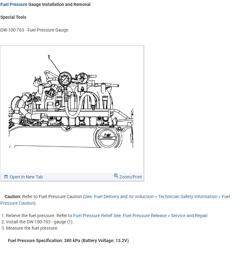

I am dealing with lack of acceleration when the A/C is on. I would like to do a couple of tests before determining that the mass air flow sensor is bad.

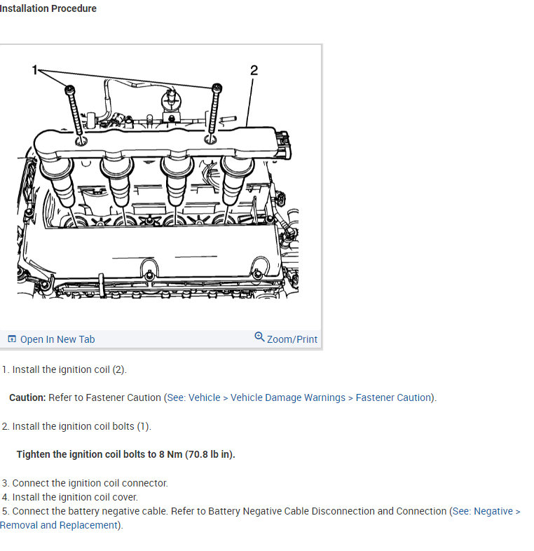

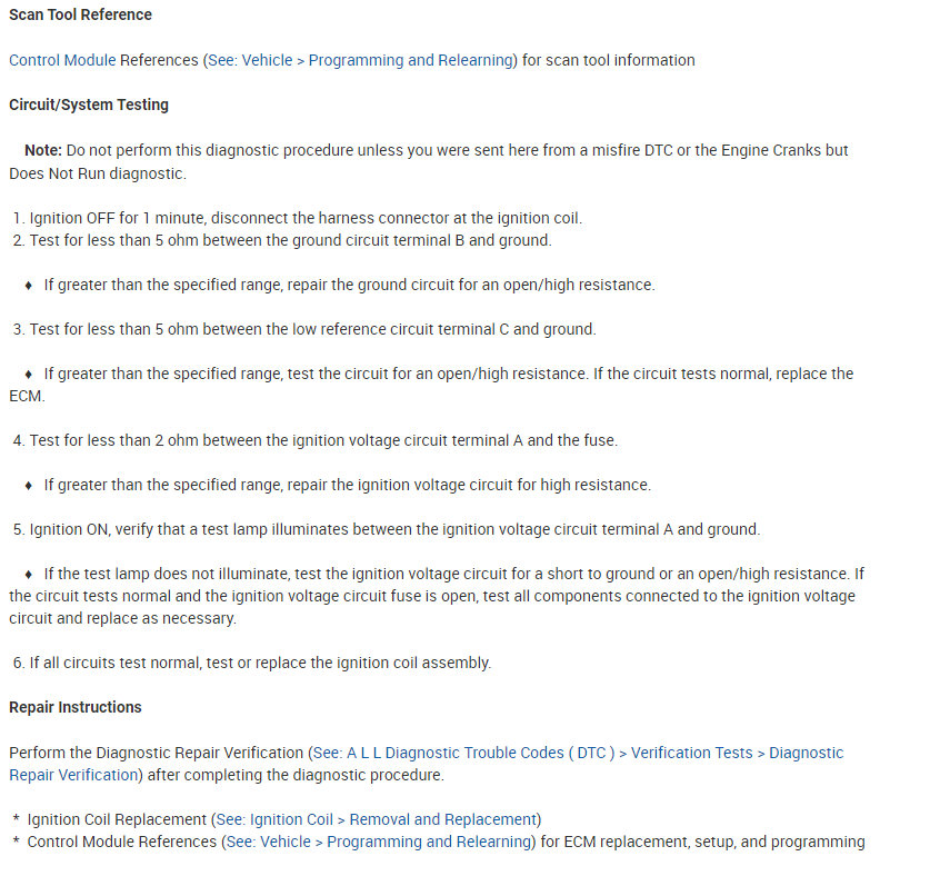

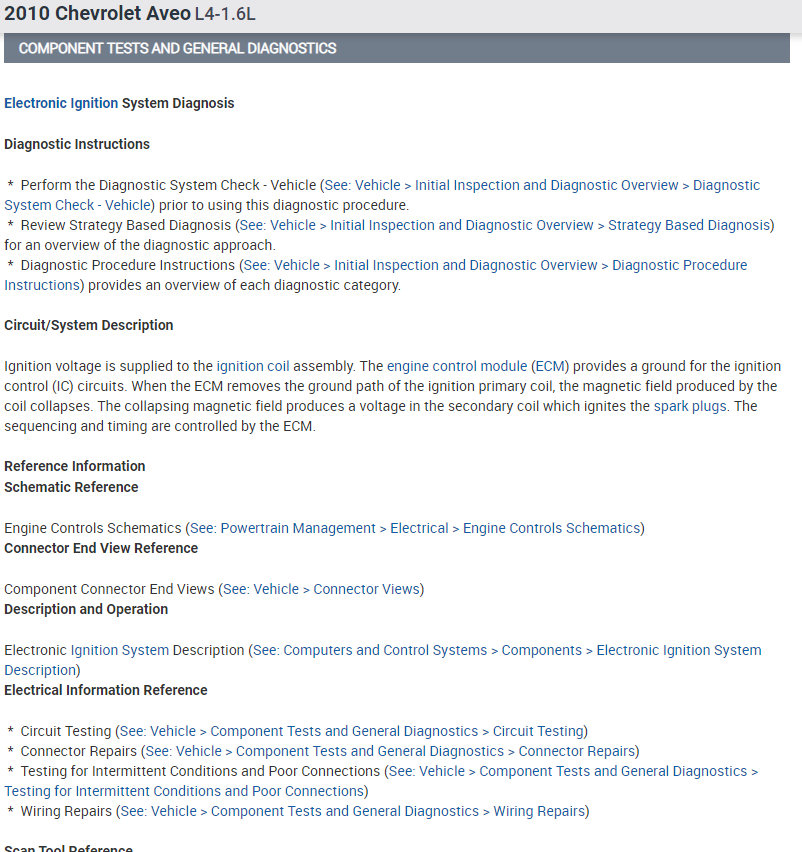

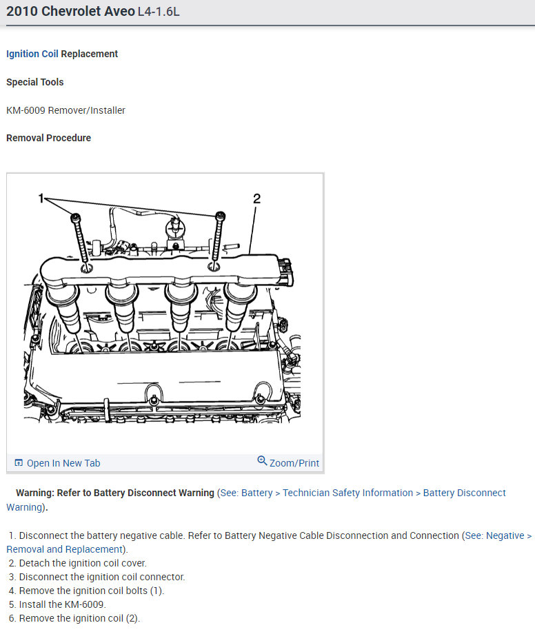

I just replaced spark plugs and air filter. If someone can send me factory info on how to test resistance in a coil pack assembly for this vehicle I would appreciate it. I also would like to know what the fuel pressure readings would be.
I have the tools to get the job finish. I just need the specs and readings I need to have before determining what is bad.
Thanks

I have attached the ignition coil pack testing procedure as well as replacement instructions.
Fuel Pressure Specification: 380 kPa (Battery Voltage: 13.2V)

Hi, fuel pressure was good. It checked out at 55 PSI and I spray the mass air flow sensor. That seemed to help. So I’ll keep an eye on it.
Jul 30, 2021 at 10:44 PM
SQM
  • 6,383 POSTS
Your fuel pressure is spot on, which is good.
