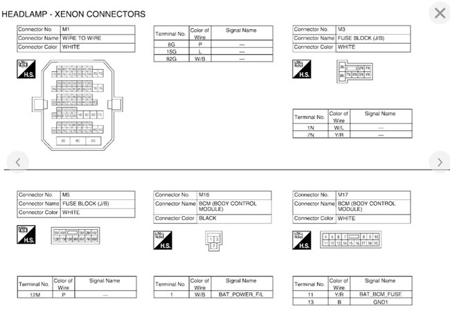

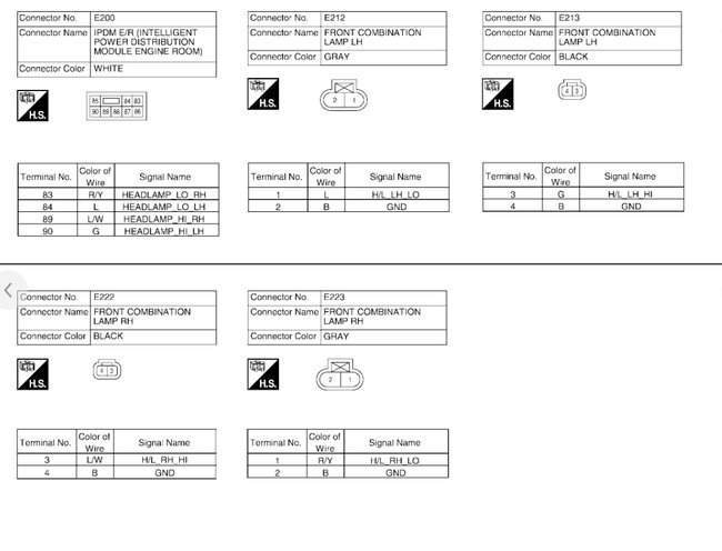

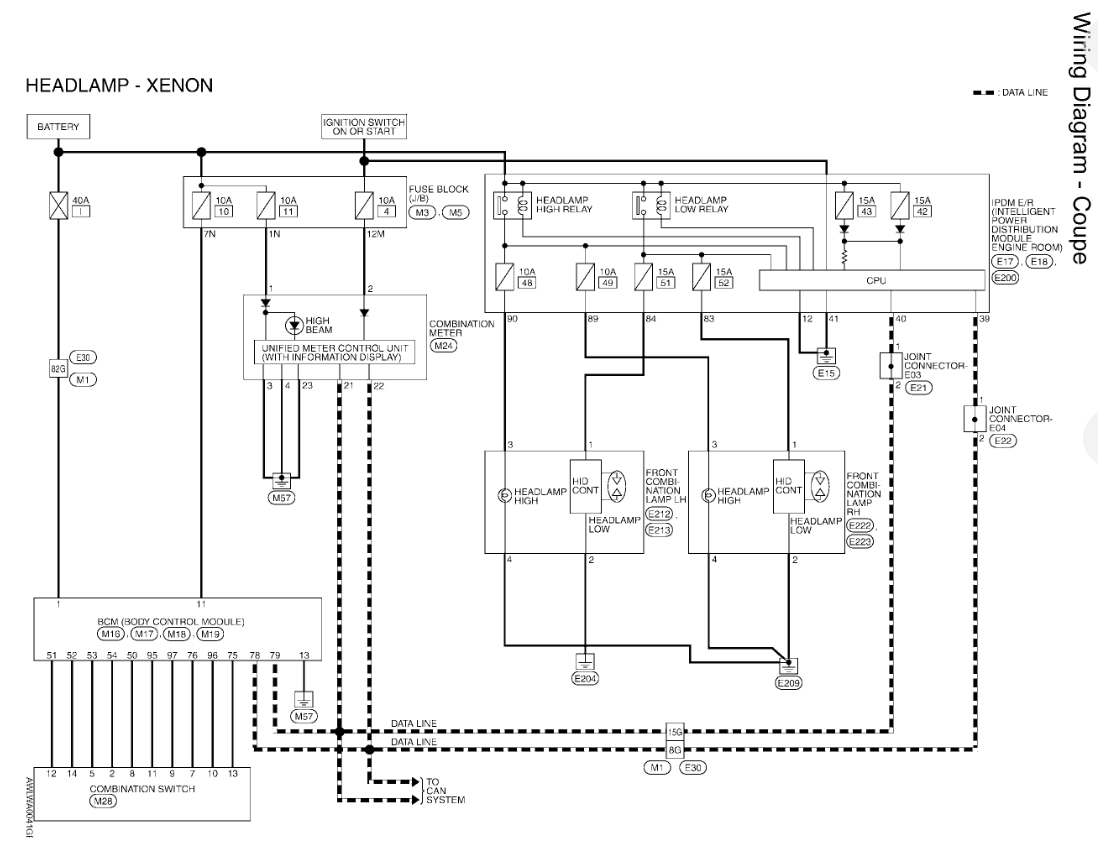

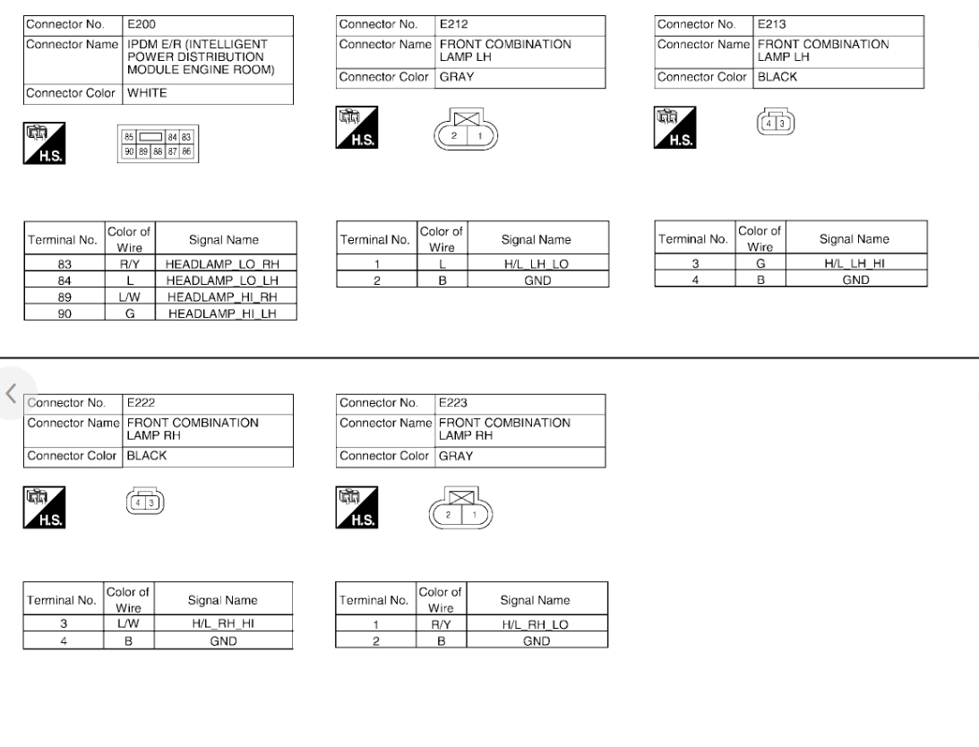

Driver headlight wiring diagram needed
2008 NISSAN ALTIMA
168,000 MILES • 3.5L • V6 • AUTOMATIC
CASSDDAGR8
Missing two connector heads. I want to wire new ones in, but I need to make sure I have the right ones.
The car listed above is a coupe, with the ballast on the bottom of the headlight housing. The one going to the ballast and fog lights (I think) are missing.
Wiring diagram please and thank you.

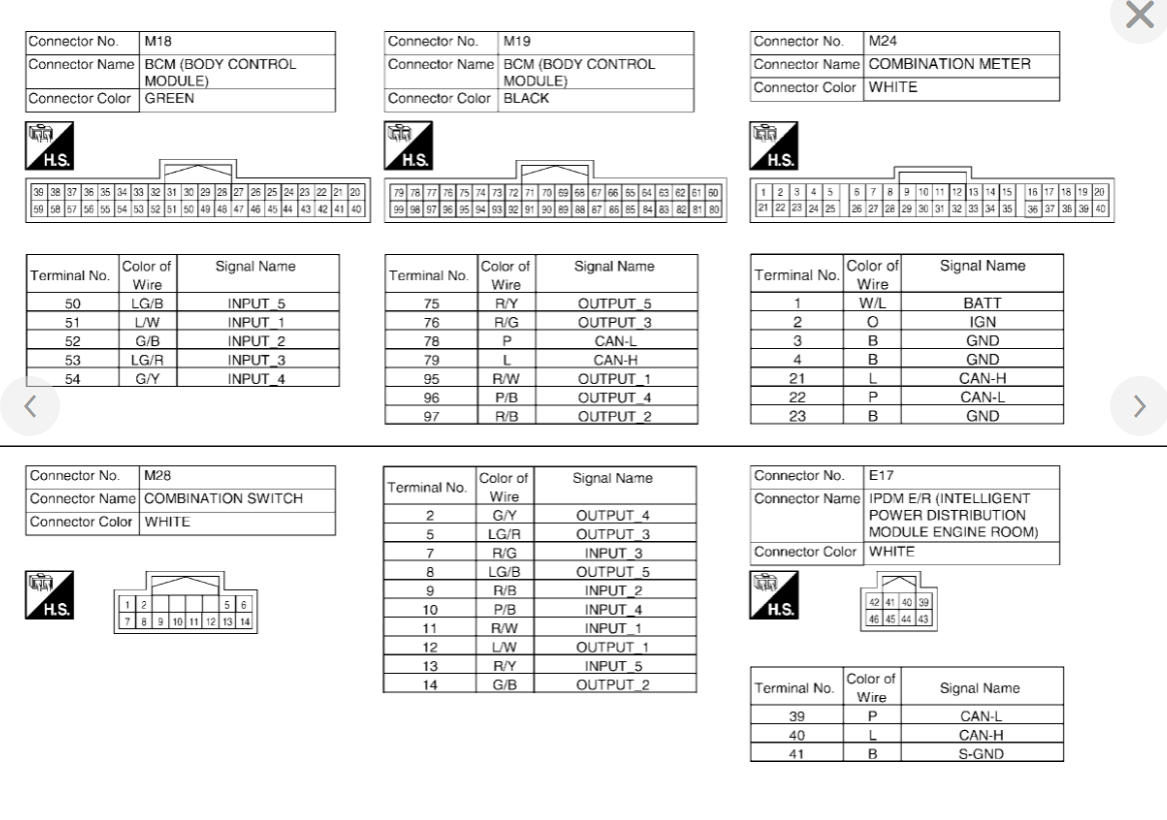

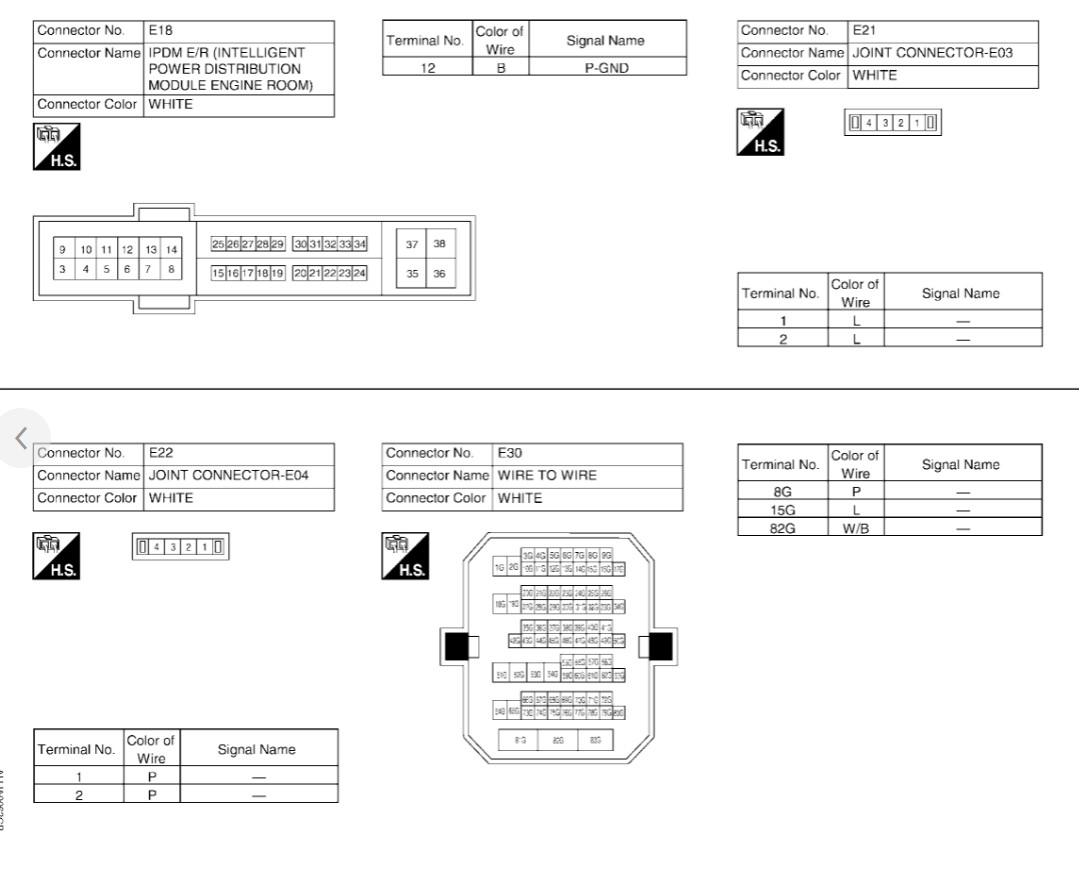

I have attached the wiring schematics for the headlights below.
Also included the pinout diagrams which shows the color of the wire and number of the connectors.
