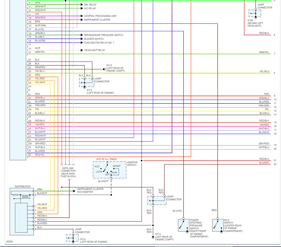

Hi there

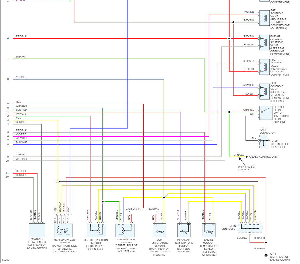

I have the car listed above, FS 2.0 engine, which damaged the male plugs which plugs into the distributor. There are two male plugs in total, one 6-pin and the other 3-pin.
Now, the diagrams I have found are different by two or three colors on the 6-pin connector none match my wires exactly. The wire colors are as follows:
Thick black/white - 12v from ignition switch
Green - to tacho
Black/yellow
Yellow/white
Orange
Black/red (this one goes into data link connector)
Thick Red/black
Black - Ground
Yellow
I know that the BLK/WHT is 12v from switch GRN is TACH signal both of these go into the 3 pin plug the last third one I do not know. I know though that if I sort out the rest, all of the others will be sorted out by default.
All the diagrams I was able to find do not match my customer's car exactly. So, I do not want to risk frying the PCM.
If someone could help me with the pin diagram and wire colors... pretty please.
Sizwe
Jun 16, 2023 at 6:27 AM
  • 55,684 POSTS
Here are the engine and wiring diagrams so you can rewire the distributor correctly. Check out the images (below). Please let us know if you need anything else to get the problem fixed.

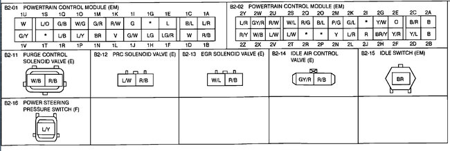

What a joy to have such a site... now Ken L, I need the pin out diagram of the distributor. I can see the yellow/white, but I do not know on which terminal does it go to into the distributor.
That is my small problem now.
Again, thank you a million times.
Sizwe
Jun 16, 2023 at 4:51 PM
  • 55,684 POSTS
Good to hear, below is the connector view. Check out the images (below). Please let us know if you need anything else to get the problem fixed.

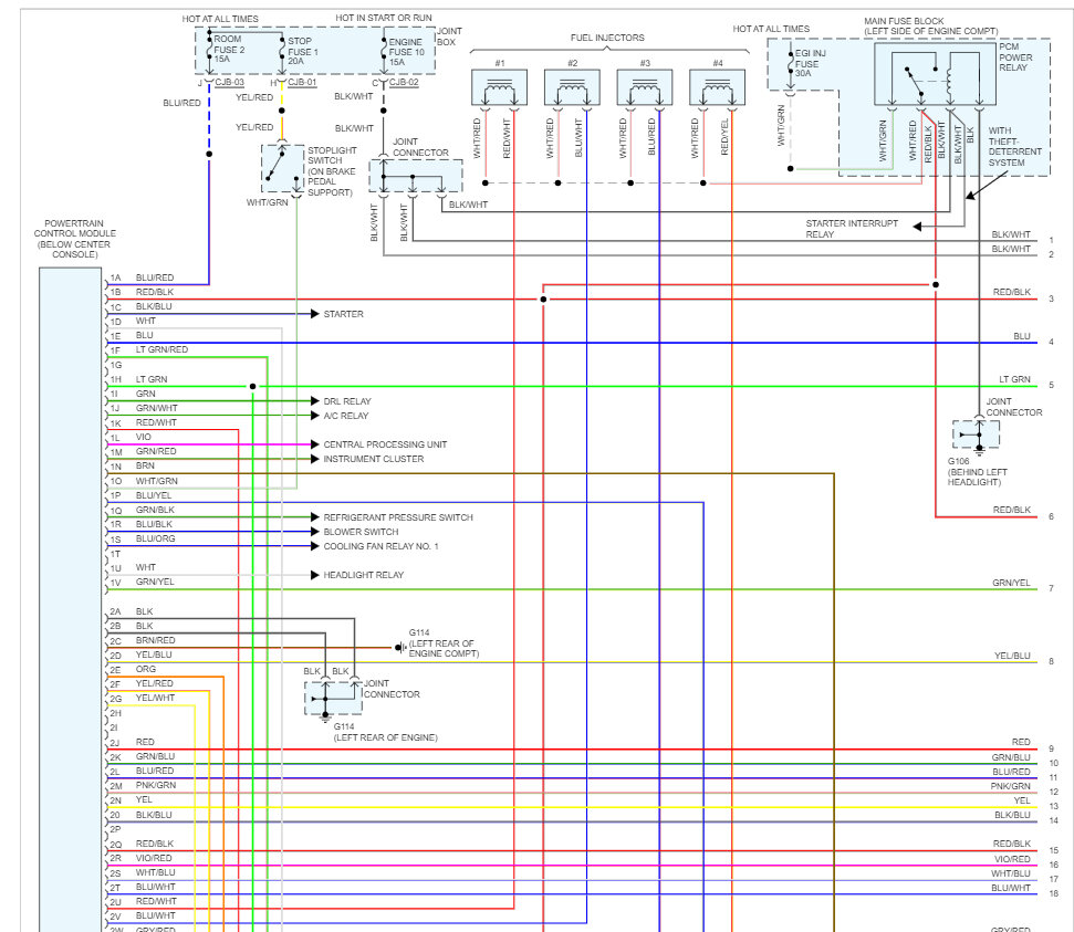

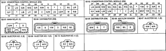

Can I have the connector diagram for the other 3pin plug? And PCM pin out too?
Sizwe
Jun 17, 2023 at 3:46 AM
  • 55,684 POSTS
Don't worry about it, we like helping people :) I believe this is what you need, check out the images (below). Please let us know how it goes.

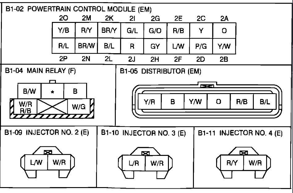

Hello ken l dont know if you still are able to respond to this but i see the pinout for the bigger connector for the distributor there what is B/L stand for in terms of the colors?
Nov 17, 2025 at 2:40 PM
  • 55,684 POSTS
Hey, yes I am still here, B/L = Blue with a Black stripe. Let me know if you need anything else.
