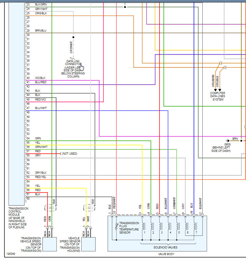

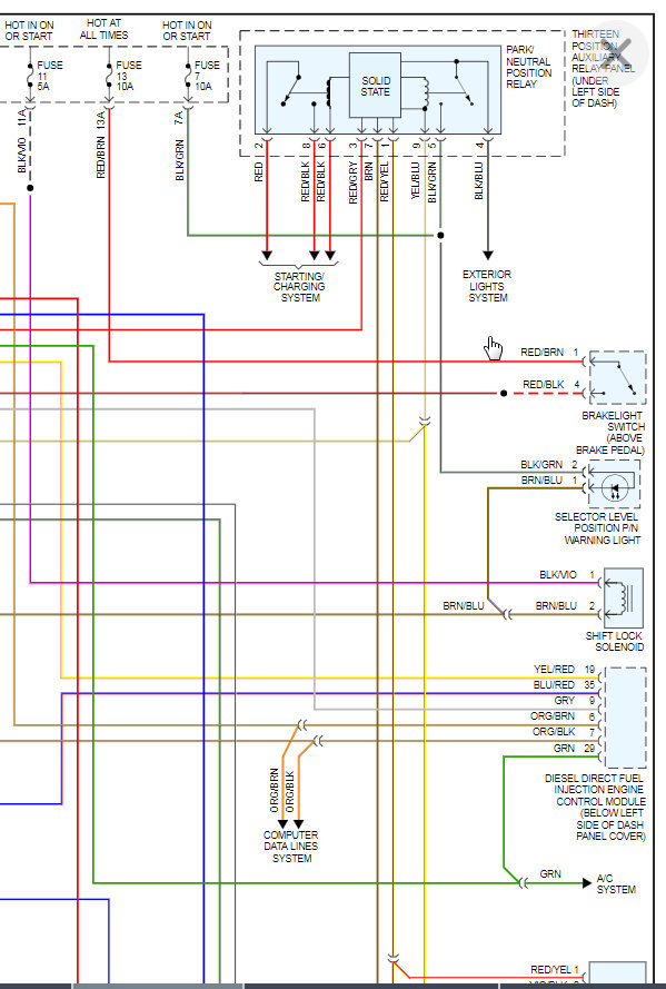

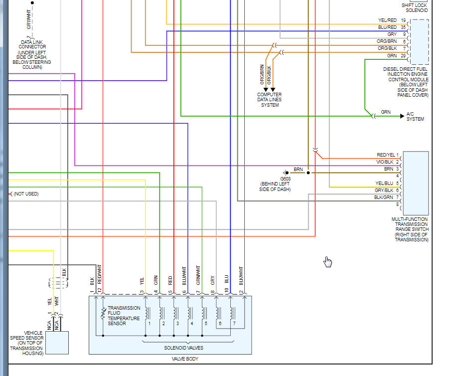

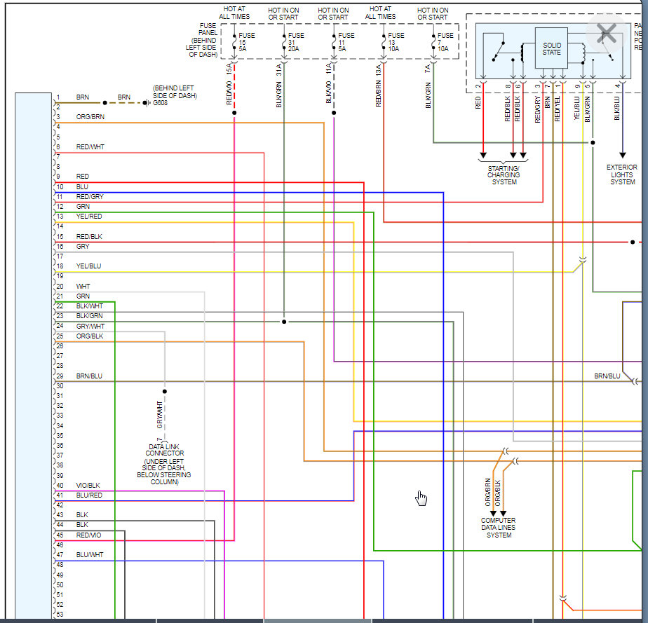

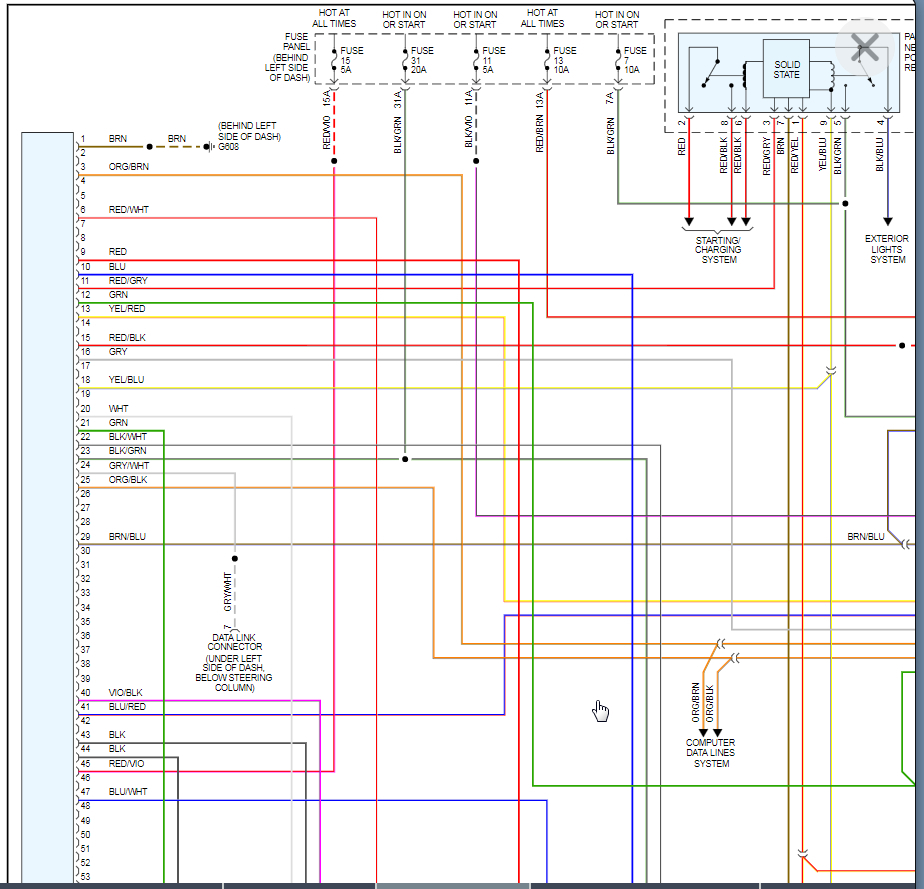

Please I need the complete wire diagram and the location of the transmission control module. Please, thank you.

I attached the wiring diagram that you requested. However, it appears there are options on which transmission so hopefully this matches your vehicle.
The diagram states the TCM is at the base of the windshield on the passenger side in the plenum.
