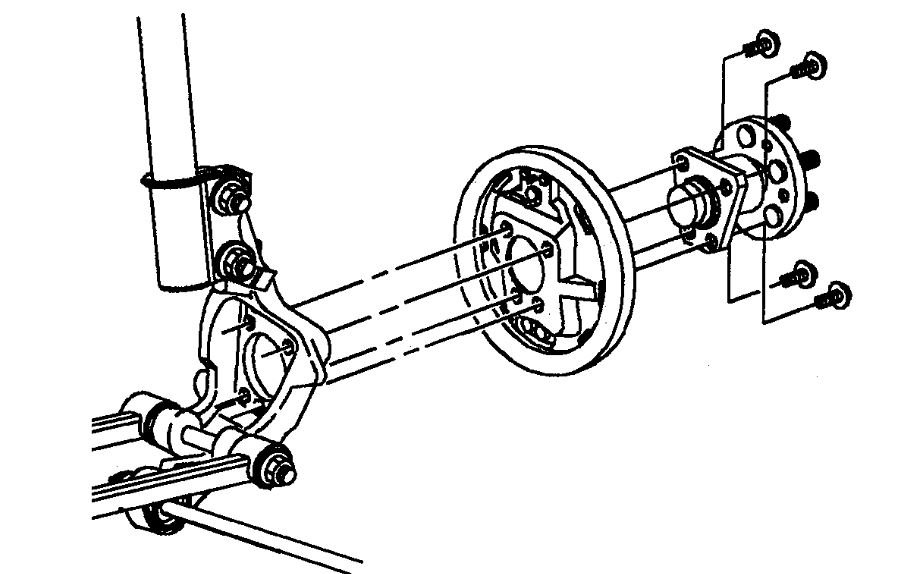

I need backshoepads and rotors
1999 SATURN SEDAN
710,000 MILES
SHONNA THOMPSON
They are squeaking.
Oct 14, 2018 at 5:32 PM
Good morning.
The backing plate replacement procedure is attached with a picture.
REMOVAL
1. Disassemble rear drum brakes. Refer to Rear Drum Brakes Disassembly.
2. Disconnect brake hose at wheel cylinder and remove wheel cylinder as previously described.
3. Remove parking brake cable.
4. Remove four hub and bearing assembly-to-knuckle bolts and remove hub and bearing assembly and backing plate from knuckle.
INSTALLATION
1. Position hub and bearing assembly and backing plate to knuckle and install four fasteners.
2. Install parking brake cable.
^ Torque: 85 Nm (63 ft. lbs.)
3. Install wheel cylinder and brake hose as previously described.
4. Completely assemble rear drum brakes. Refer to Rear Drum Brake Assembly.
