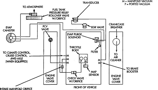

I need a vacuum line diagram
1994 DODGE DAKOTA
200 MILES • 3.9L • 6 CYL • 2WD • AUTOMATIC
DBM/1977
Problems idling.

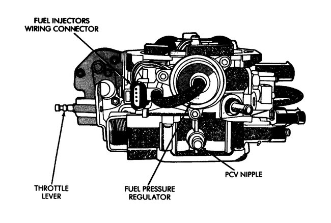

As far as the vacuum schematics, I attached two pics below. The first shows everything related to the EVAP system. Pic 2 simply shows the fuel pressure regulator's vacuum supply.
