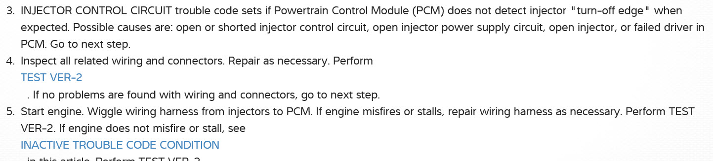

Code 27
Wednesday, April 6th, 2016 AT 11:49 AM
HMAC300
MECHANIC
48,601 POSTS
This is injector control circuit problem which can be any injector on engine as well. Check for shorts or grounded wires. See pic
