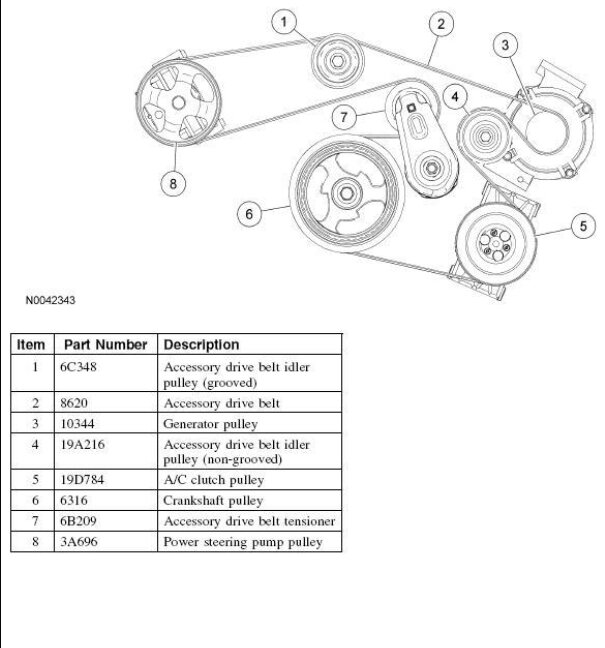

I need a serpentine belt diagram for the 3.0 V6. thank you

Sure, here you go, check out the images (below). Let us know if you need anything else.
