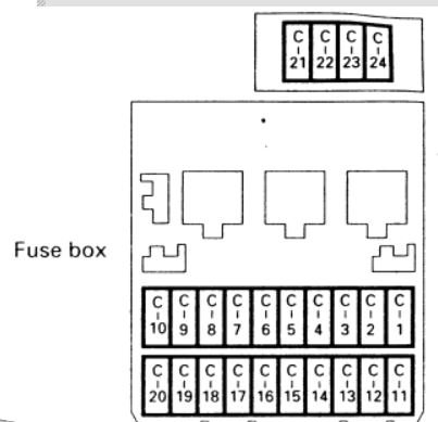

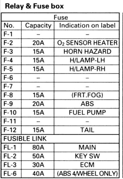

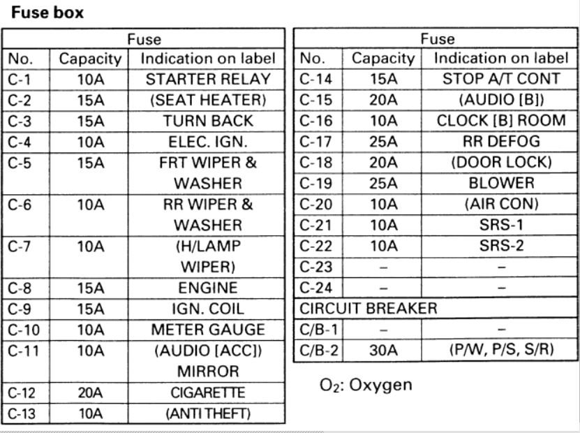

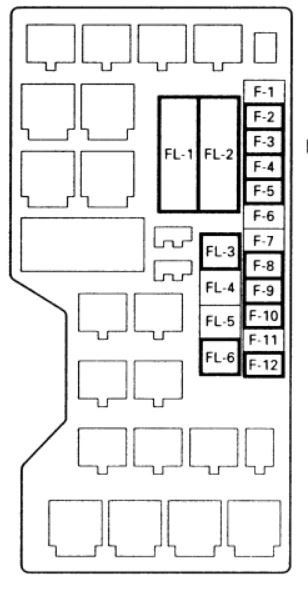

A fuse has fallen out and I cannot find where it goes. Now my automatic transmission will not shift on its own. Please help. The fuse panel door is missing. I cannot find the fuse layout anywhere.
Aug 31, 2018 at 4:44 AM
AL514
  • 5,703 POSTS
Hello there, hopefully these diagrams will help. There seems to be a bit of variation between years on the Troopers. This guide will help you test the fuses with the fuse panel location in the diagrams below.
