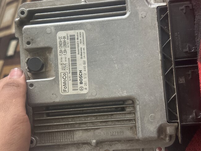

I need a ECU pinout for a FJ5A-12A650-DC?
2018 FORD ESCAPE
100,000 MILES
JOSE CONTRERAS
  • 5 POSTS
I been trying to look online for the pinout but I can’t seem to find anything
Mar 16, 2026 at 11:43 PM
JOSE CONTRERAS
  • 5 POSTS
More specifically I wanna program it on bench

I’m not sure I got it from a junkyard and yes I have all the equipment to program it I just want the pinout to make a connecter

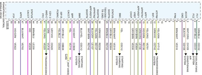

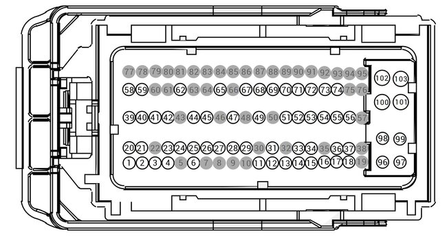

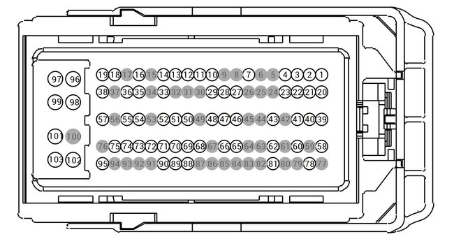

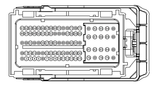

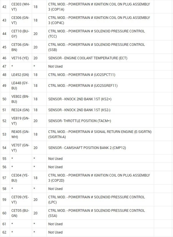

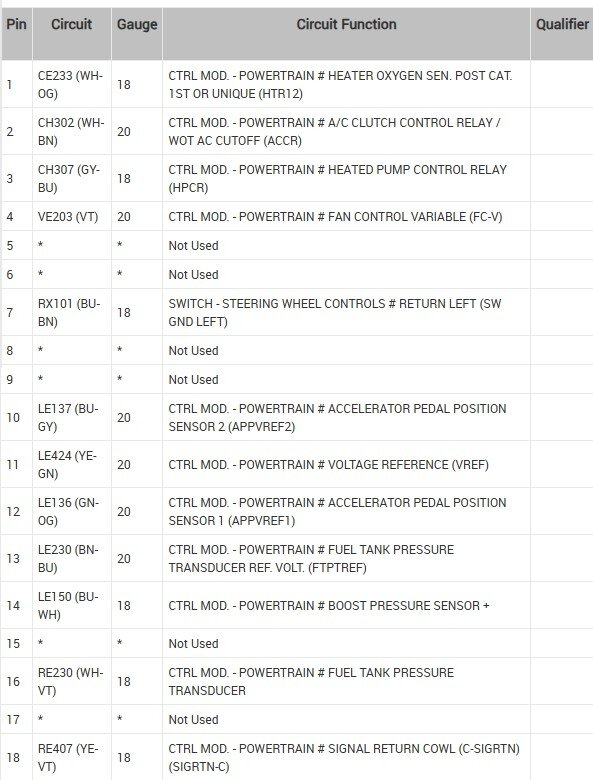

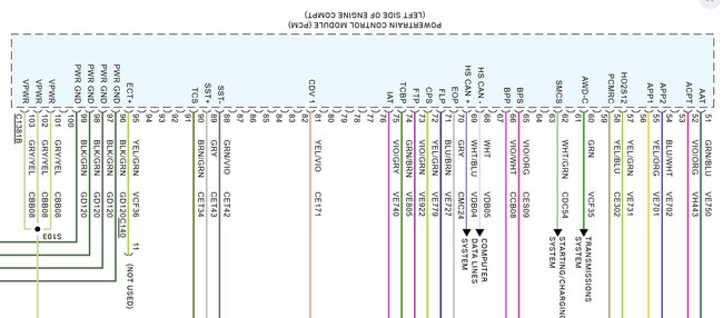

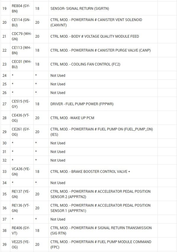

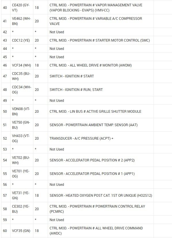

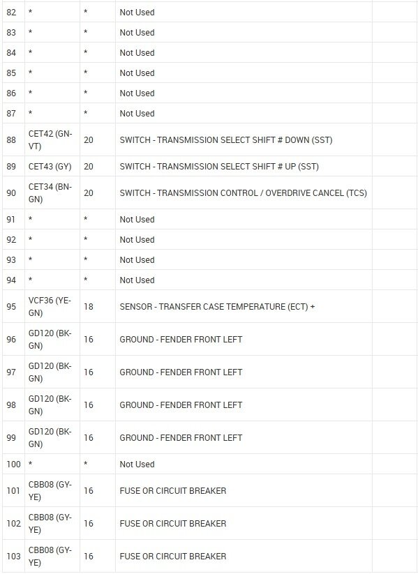

STEVE W.
  • 15,200 POSTS

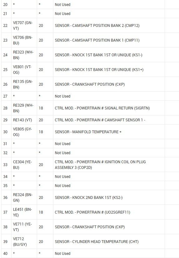

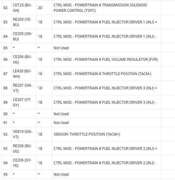

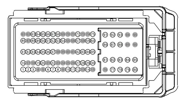

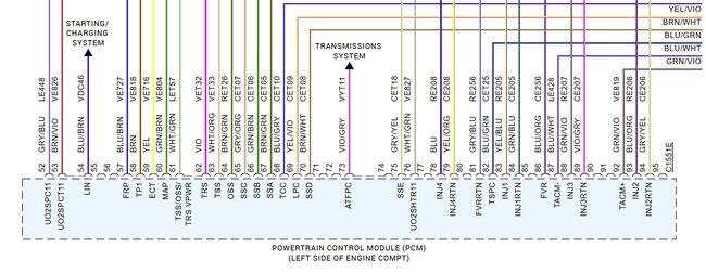

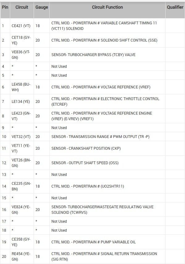

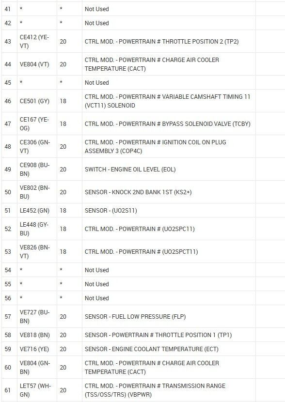

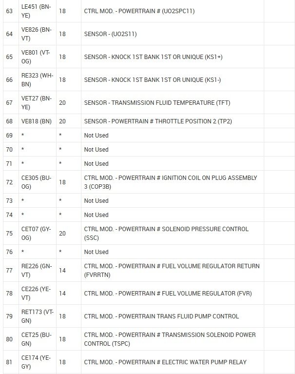

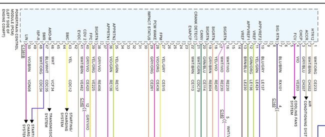

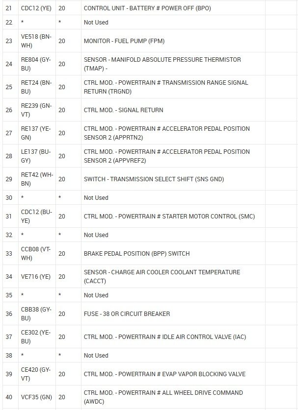

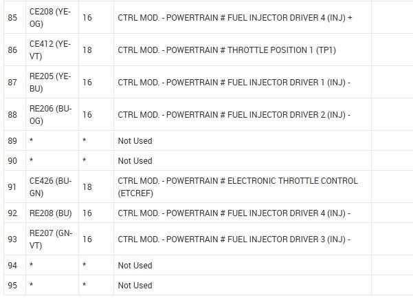

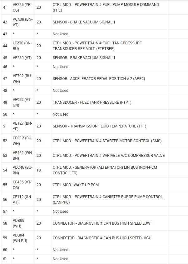

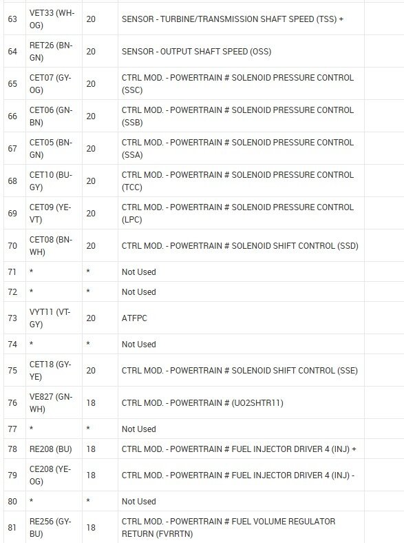

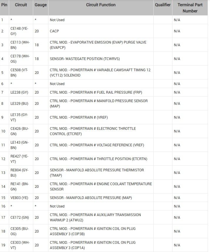

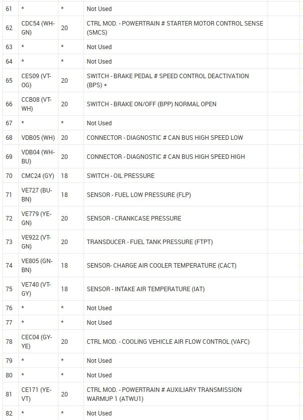

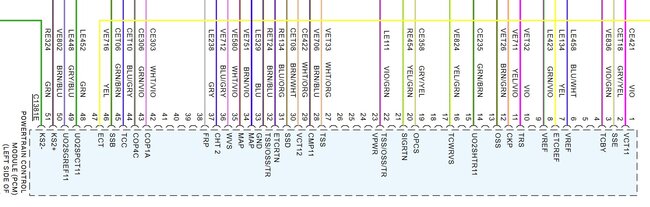

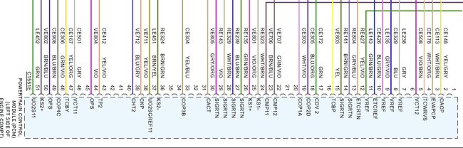

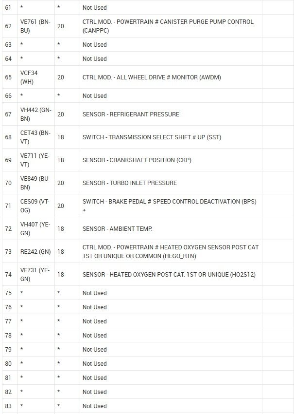

There are actually more than 2 as they had a few different ECUs depending on the engine and options. I'll give you the most common ones for a 4X4 as they generally have the most connections. First batch is the 2.0 turbo part HS7Z12A650AANP layout, second batch in the next reply will be the 1.5 turbo part FV6Z12A650DANP. Notice they are different in layout.
Mar 17, 2026 at 8:29 PM

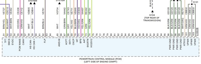

STEVE W.
  • 15,200 POSTS

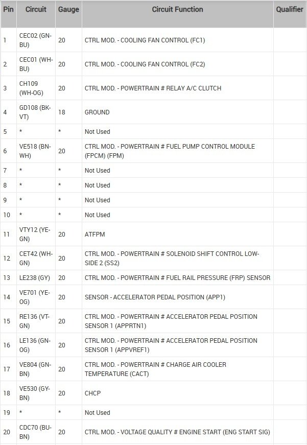

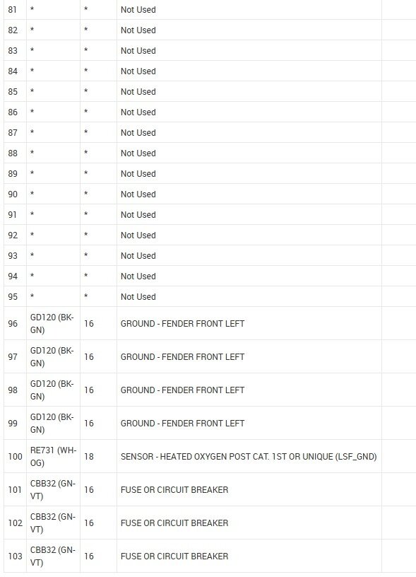

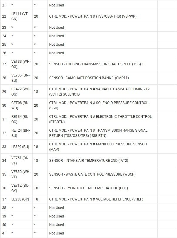

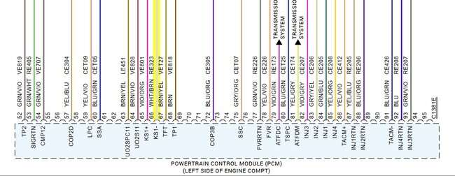

And here is the second batch for the 1.5 turbo part FV6Z12A650DANP ECU Hopefully one of those will do the trick.

Thank you
