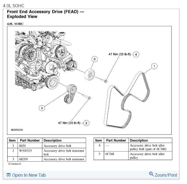

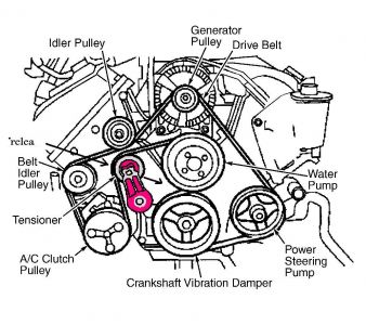

the belt needs to be replaced and put on. i need a diagram of serpentine belt and direction of turn
Aug 6, 2015 at 1:07 AM
CARADIODOC
  • 34,382 POSTS
The crankshaft pulley, (#5), turns clockwise here is a guide to help you change the belt step by step with diagrams below to show you how on your car.

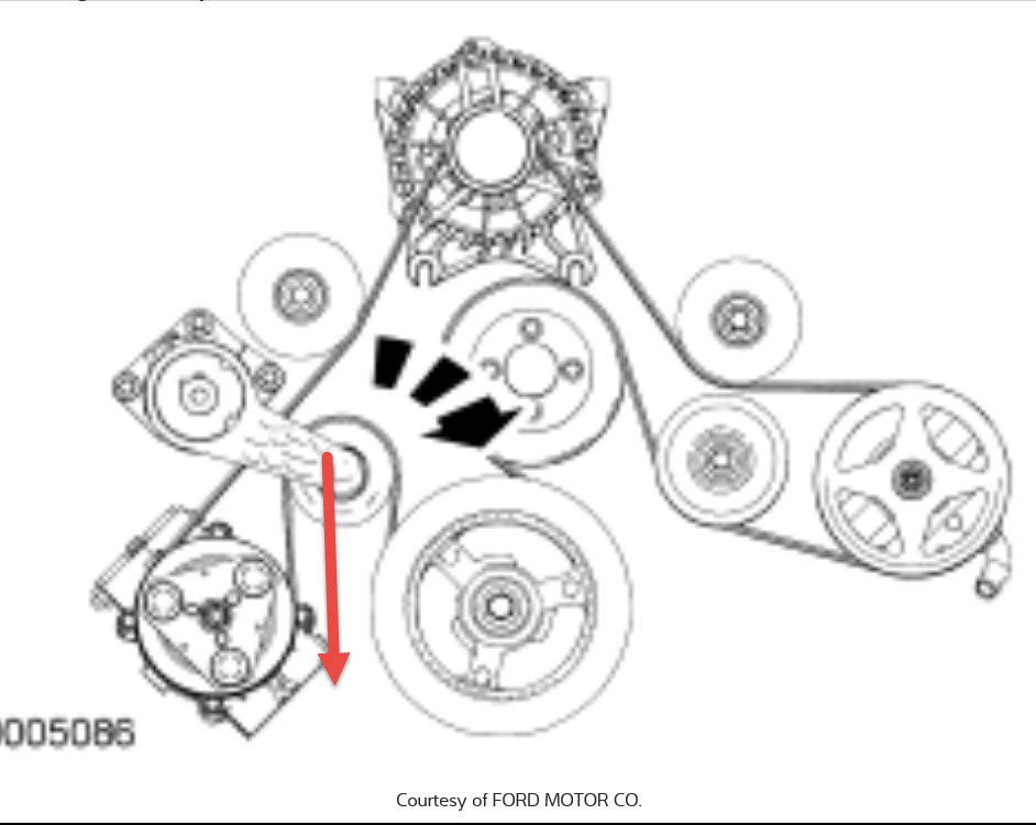

BMRFIXIT
  • 19,053 POSTS
Release the automatic tensioner by pulling away from the belt

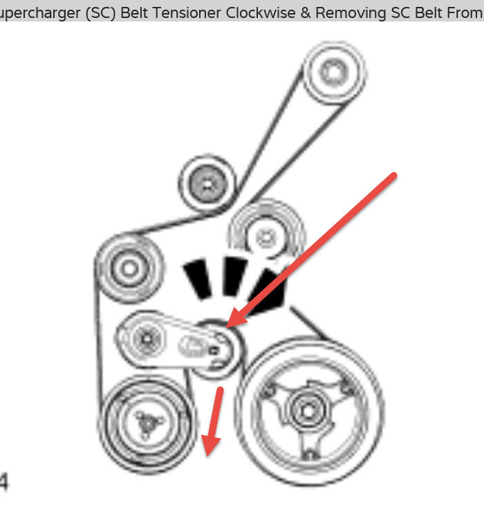

I have a Roush mustang i am trying to replace the belt on, but i am having trouble with figuring out some of the pulleys after the supercharger. i thought removing the supercharger would allow me access to the pulley, but i cannot get it off. I do not know what to do next.
Feb 23, 2019 at 8:01 AM (Merged)
HMAC300
  • 48,601 POSTS
we don't list a roush 2005 this is a 2008 what i'm sending so may be very similar. you need to take the air cleaner outlet tube off then move the tensioners in the direction shown. also if replacing belt replace tensioner as well as they loose tension. If this doesn't match up contact roush or look online through their website. one belt is for supercharger other for accessories
