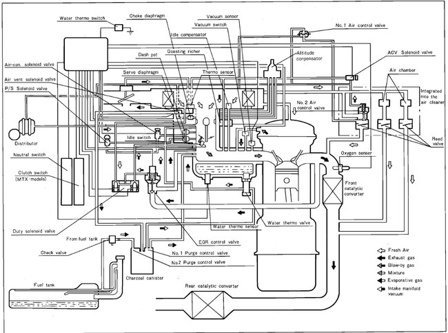

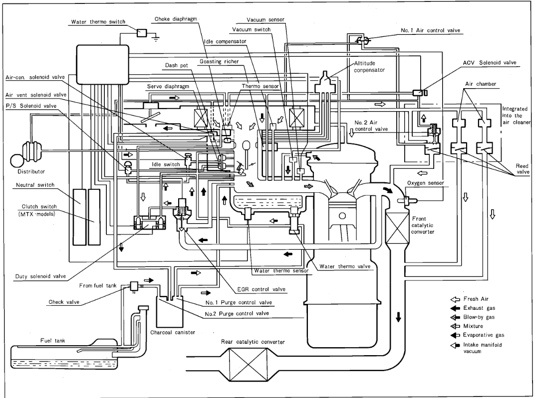

I need a diagram for the carburetor hoses in the engine bay to properly hook/route it all back together?
1983 MAZDA 626
250,000 MILES • 2.0L • 4 CYL • 2WD • MANUAL
BOUNDFORTRESS
MEMBER
1 POST
Need a diagram for the carburetor hoses on the vehicle listed above LX hatchback 4d fwd.
Feb 10, 2025 at 7:16 AM
Experienced Mechanic
55,688 POSTS
Yep, there are many, here are the diagrams for the vacuum lines I found. Check out the images (below). Let us know if you need anything else.
