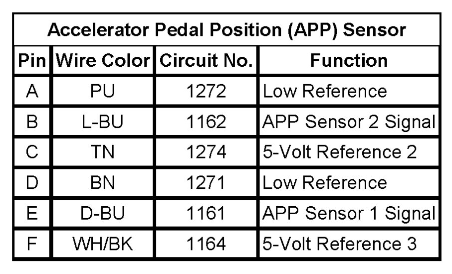

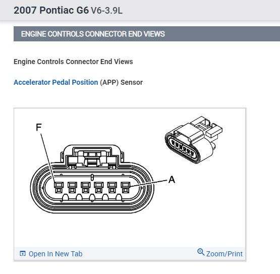

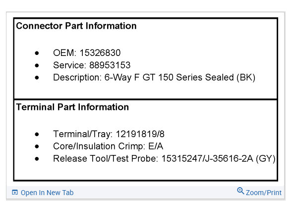

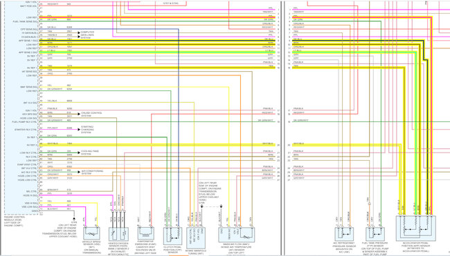

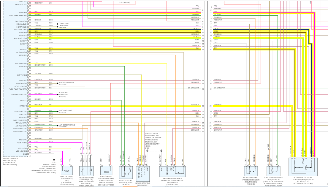

My wires were cut on my accelerator position sensor, and I need a diagram so it with color coded so that I can put my wiring back together at my gas pedal.
May 28, 2023 at 3:01 AM
  • 110,240 POSTS
If you look below, pic 1 provides the wiring schematic related to the accelerator position sensor.
The remaining pics are the pin-out/connector view, pin identification, function, and wire color.
Let me know if this is what you needed.
