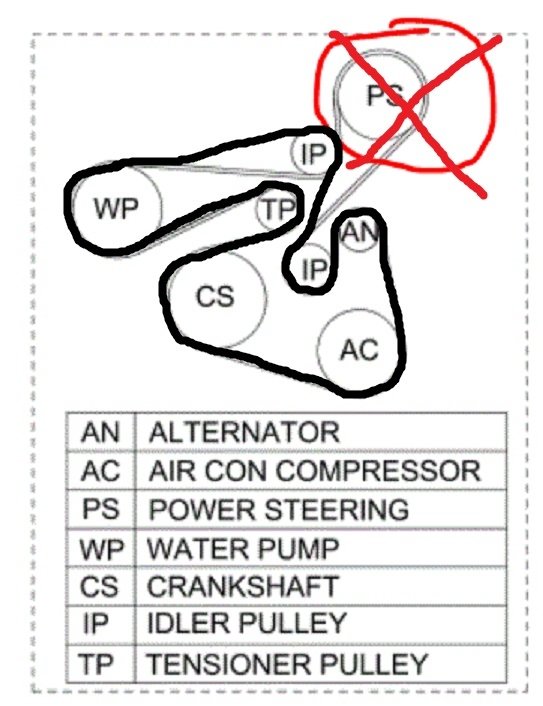

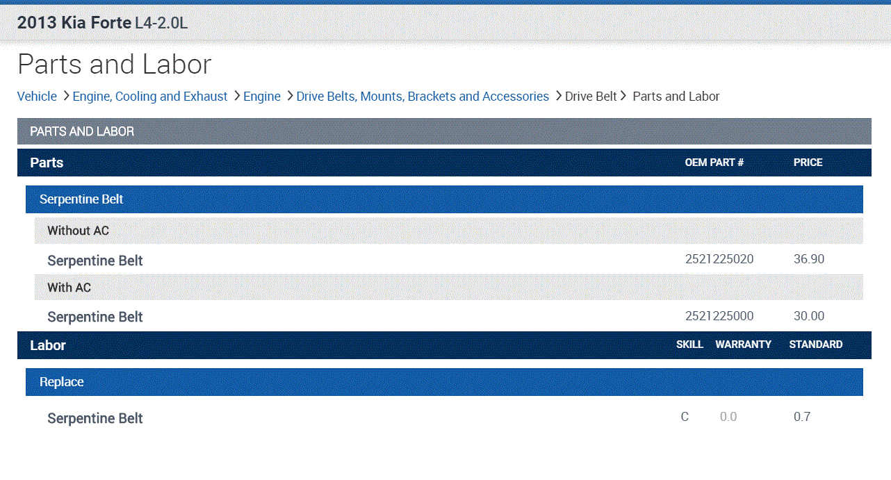

I have found the OEM part numbers for both with AC and without AC. The length 85" and 98.7". I have to assume the shorter one is without AC
I struggled to find this because electric and hydraulic PS was offered. However, electric seems limited to Canada. Take a look at the attached pic and let me know if that is the routing you have.
If you look at pic 2, it shows the part numbers with and without AC. However, they have hydraulic power steering. Let me know the exact model you have and if I am correct assuming you are in Canada.

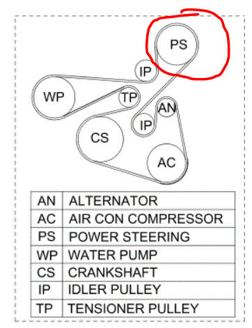

The vehicle is listed above EX, 4 door sedan with a 2.0L I4 MPI engine. The image I attached shows the belt diagram as it is on the vehicle. I can't seem to find these routing diagrams anywhere, even though I can look at this: http://www.kifomanual.com/second_generation_yd_2014_2018_-2.html.
Mar 1, 2020 at 11:38 PM

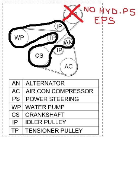

FYI, I attached a photo of the routing I need to accomplish the task of bypassing the A/C.

I finally got the chance this past weekend to finish this project. Instead of replacing the A/C compressor, I took the chance that it was just the A/C compressor pulley making the noise, so I decided to replace it. The A/C in the car works well and the pulley contains a bearing and that's where the noise was coming from. When I removed the belt to check the pulley, it wobbled slightly and made noise as I rotated it, so I knew I had a pretty good chance of having made the correct diagnosis. It turns out, I was right. No more noise and the A/C works perfectly (as far as I know...I don't know how to properly check the A/C operation). This solution was more expensive than the A/C compressor bypass belt idea (about $120 vs $40), but it is a permanent solution. It is much less expensive than having to replace the A/C compressor and having risked other repairs due to a belt failure (My mechanic quoted me $1600 for a refurbished A/C system...he's nuts!).

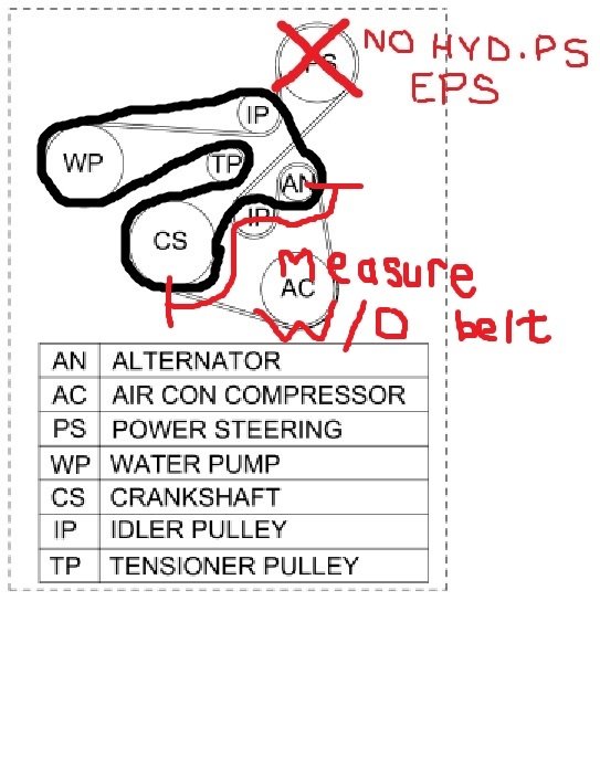

After replacing the A/C compressor pulley and with the belt off, I measured from the crankshaft, around the idler pulley to the alternator (see the attached photo) and subtracted that measurement from the original belt length. I know it's not ideal, but there is so little room in that engine compartment, even if I could have made any of the other measurements, the chances of error would have been so high (I would have had to make 3-4 other measurements, both on the inside and outside of the belt to add the lengths together to get a final belt length) that I felt it was the best option.
The measurement was 347mm, the original belt length is 2160mm, so the result is 1813mm or about 71.38 in. I looked up a DAYCO belt that matches the original belt's thickness, width, number of ribs, material, and rib profile and a DAYCO 5060715 Effective Length (in) 71.5 will work. A DAYCO 5060710 Effective Length (in) 71.06 will also work, but it may be too short.

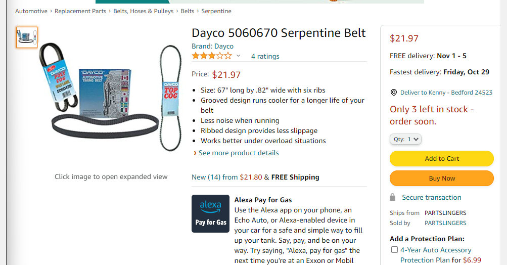

Actually, had my mechanic do this recently on the 2013 Kia Forte with electric power steering and bypassing licked up A/C compressor using belt 5060670.
Oct 26, 2021 at 11:31 AM
That is great info. Thanks for sharing that. I am sure that will help others. Plus, that is a 67-inch belt so if others want to find a similar belt of that length, then that would work as well.
Thanks again for sharing that info.
Oct 26, 2021 at 4:42 PM
EL SAL
  • 5 POSTS
The mechanic at the shop said they picked up four belts and this was the second one they tried which seemed to be the best fit. He said he had to remove that engine mount to get the idler pulley far enough over, but he made it sound like he wasn't sure if he absolutely had to.
