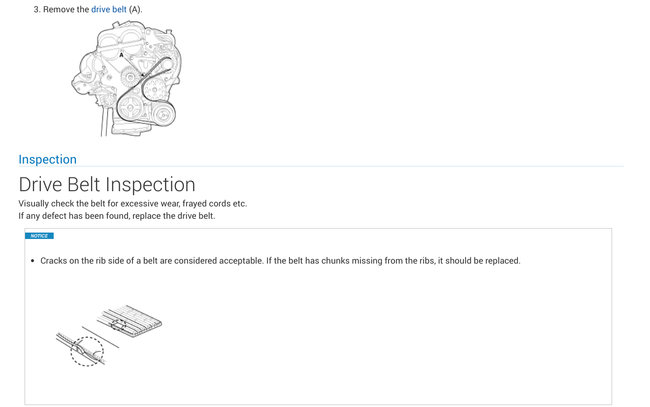

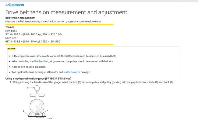

I need serpentine belt diagram
2017 HYUNDAI ELANTRA
68,885 MILES
OLAN
Engine is a 1.6.There's a part missing from one of my pulleys on my serpentine belt this is why I need to diagram.
Feb 1, 2020 at 11:35 PM
SCGRANTURISMO
  • 4,897 POSTS

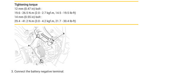

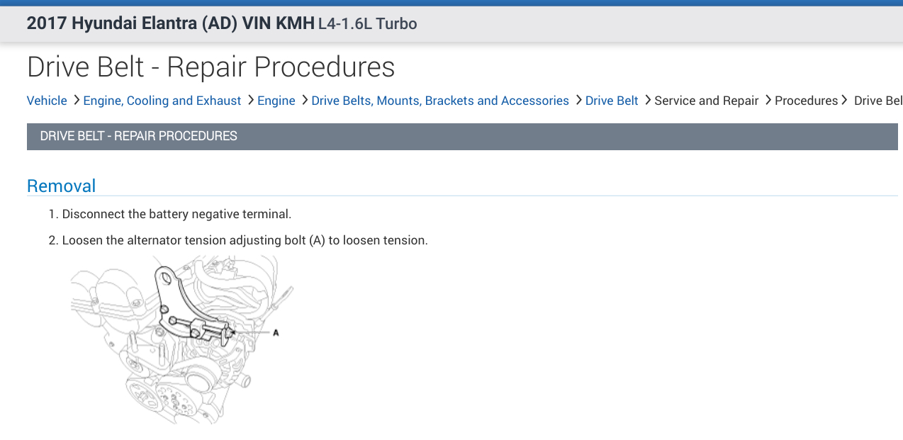

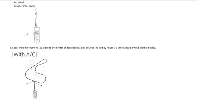

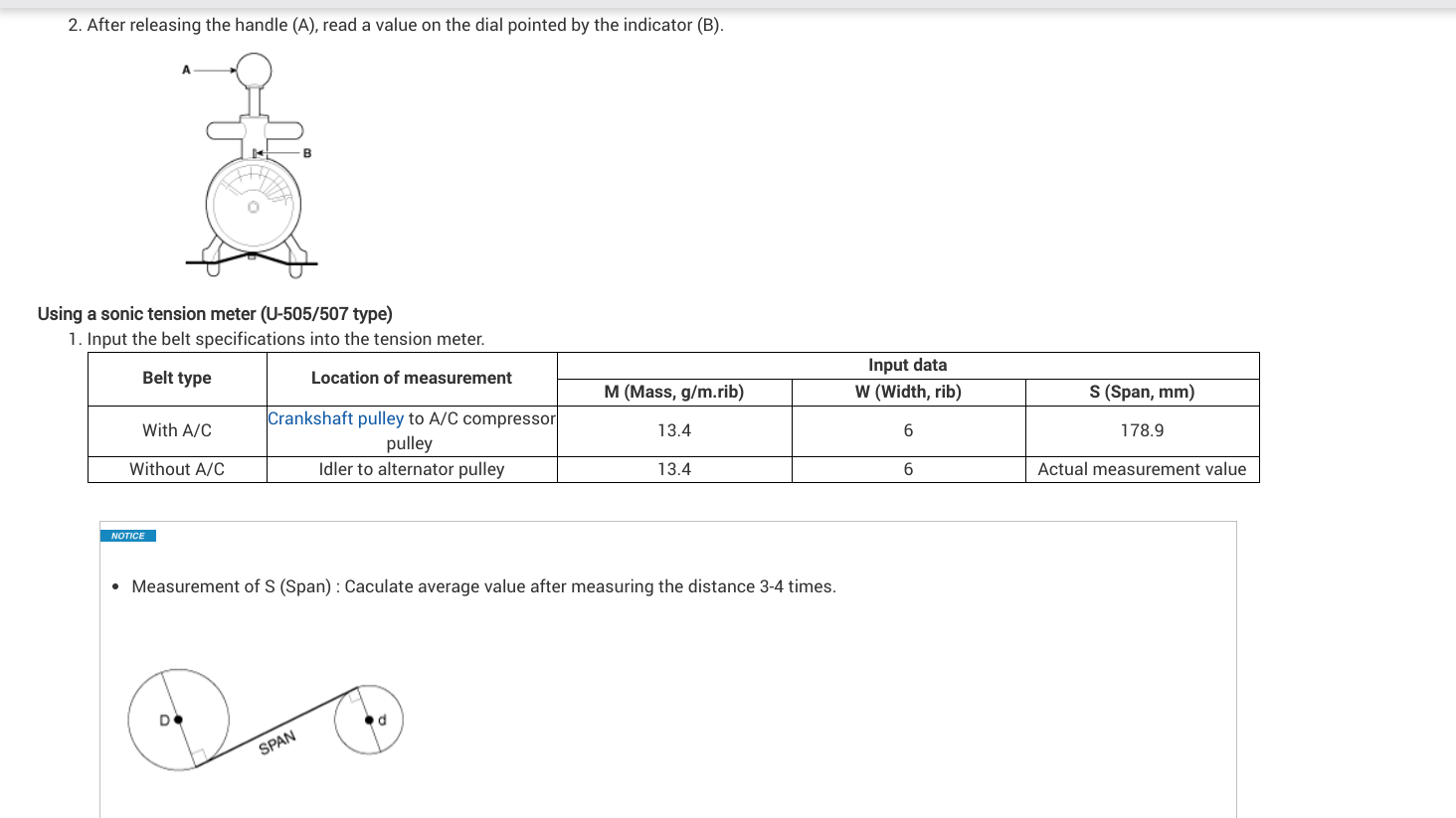

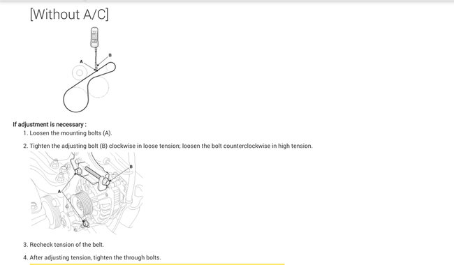

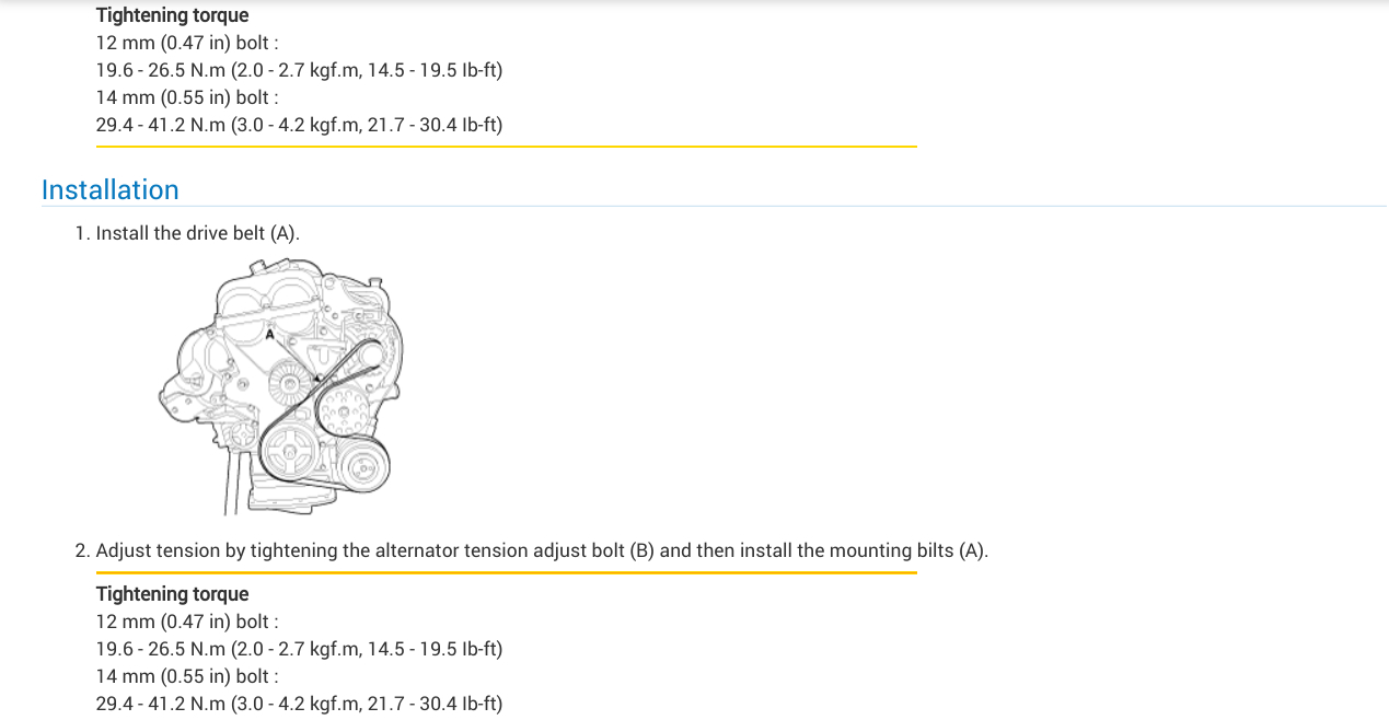

In the diagrams down below I have included the instructions for the removal and installation of the drive belt for your vehicle. In this guide there is a diagram for your vehicle's drive belt with and without A/C. Please go through this guide and get back to us with how everything turns out.I hope that this helps out.
