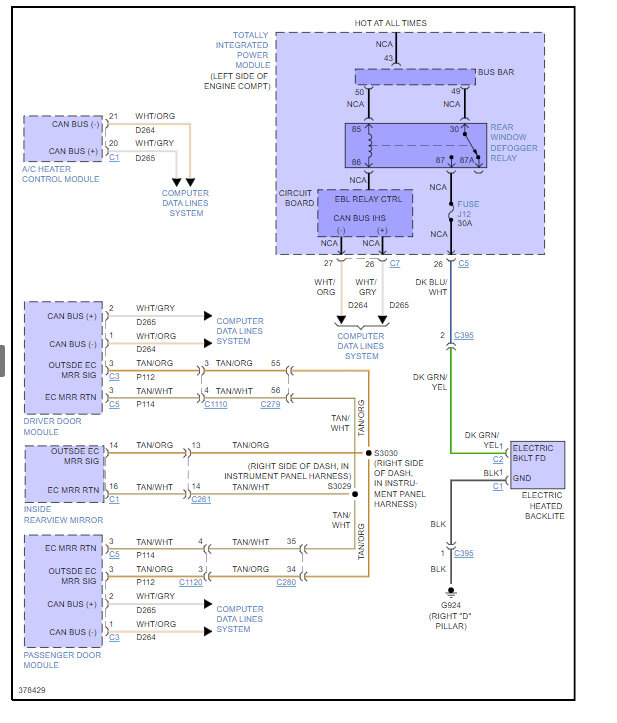

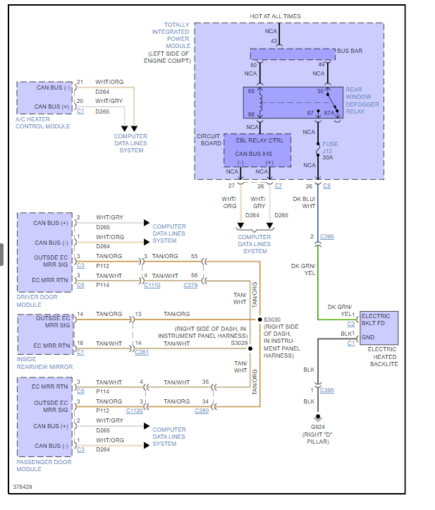

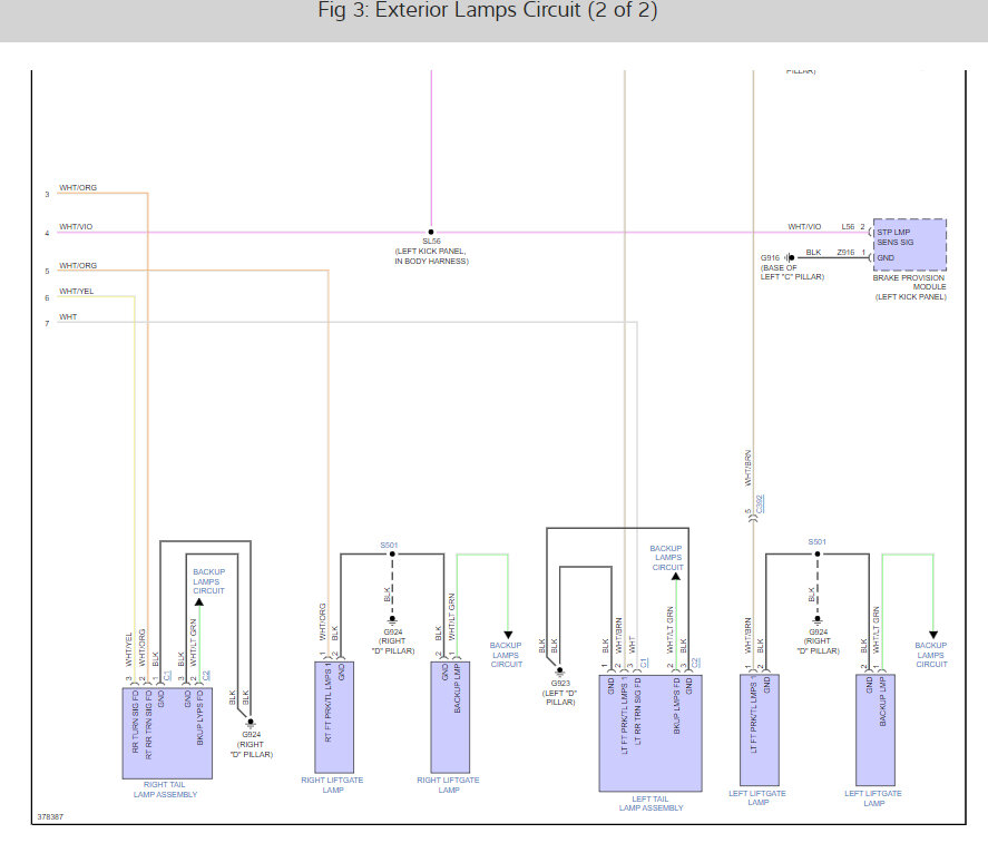

Hello. I need TIPM connectors scheme. Can't find rear defogger pin, rear stop light pins, rear turn signal pins?
Dec 28, 2022 at 8:21 PM
  • 55,694 POSTS
Here are the wiring diagrams for the TIPM, rear defogger and rear tail and brake lights as you have requested, and I have included a guide to help you with the testing.
Check out the images (below). Please let us know if you need anything else to get the problem fixed.

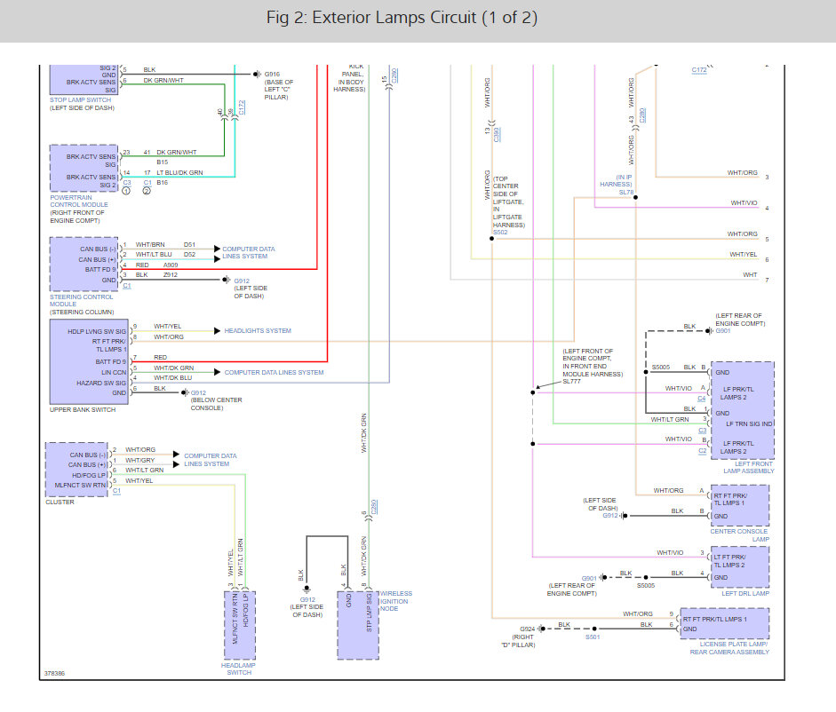

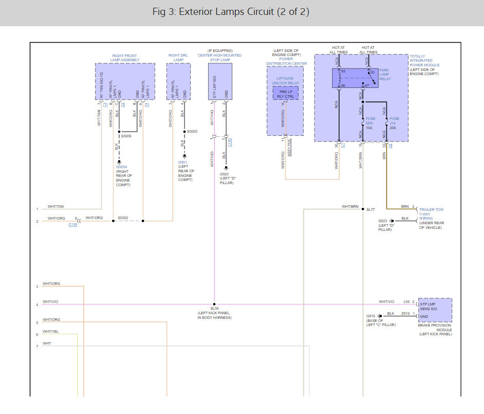

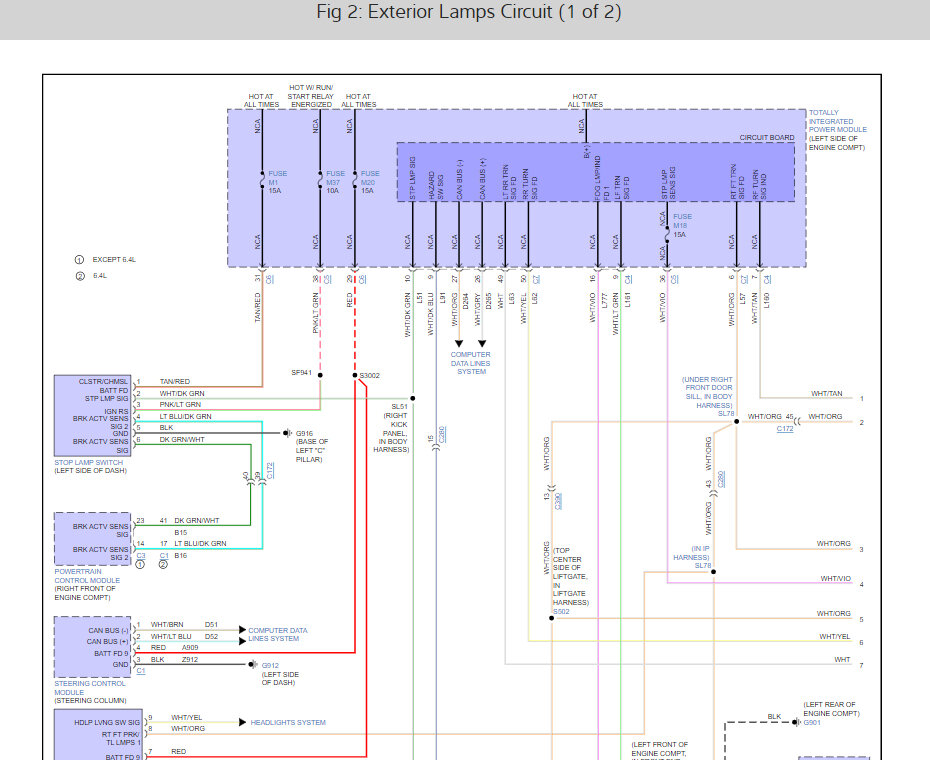

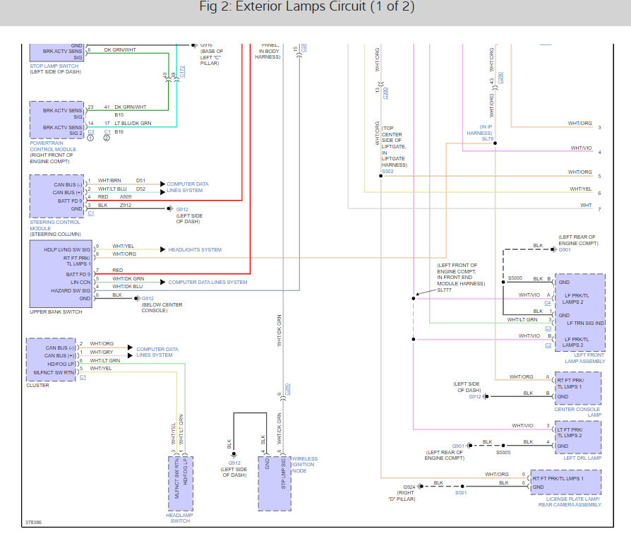

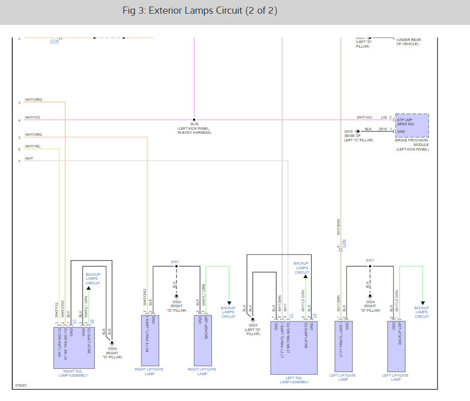

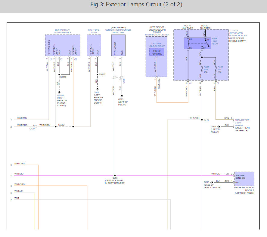

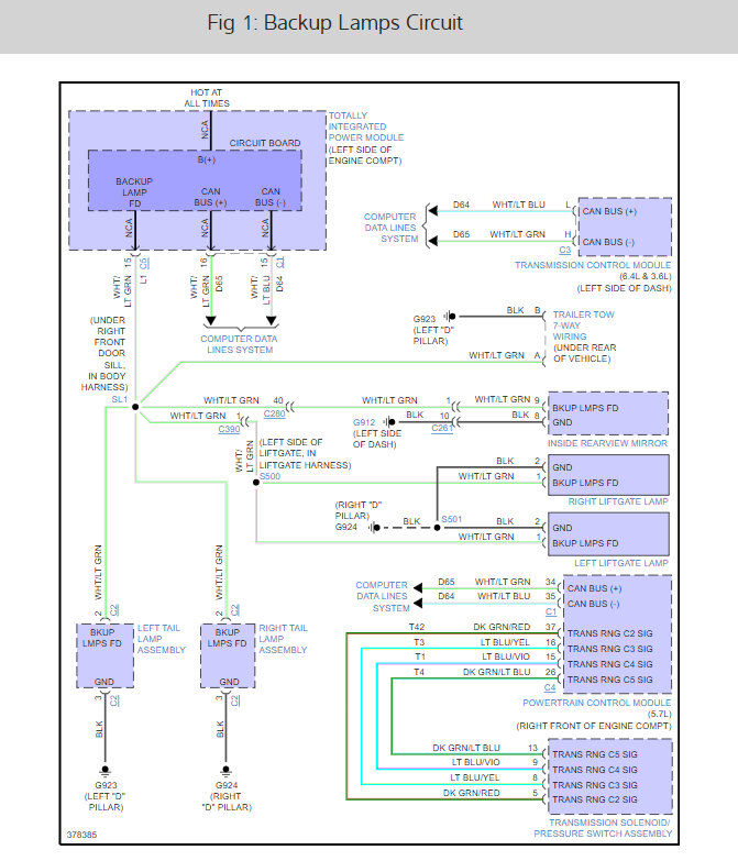

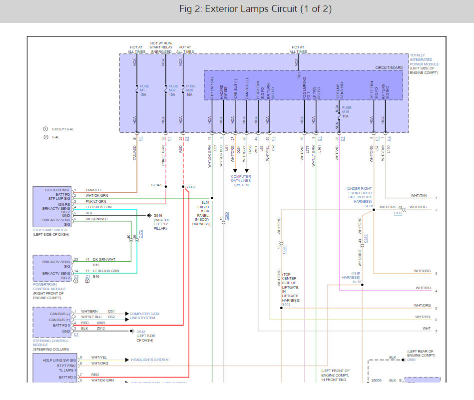

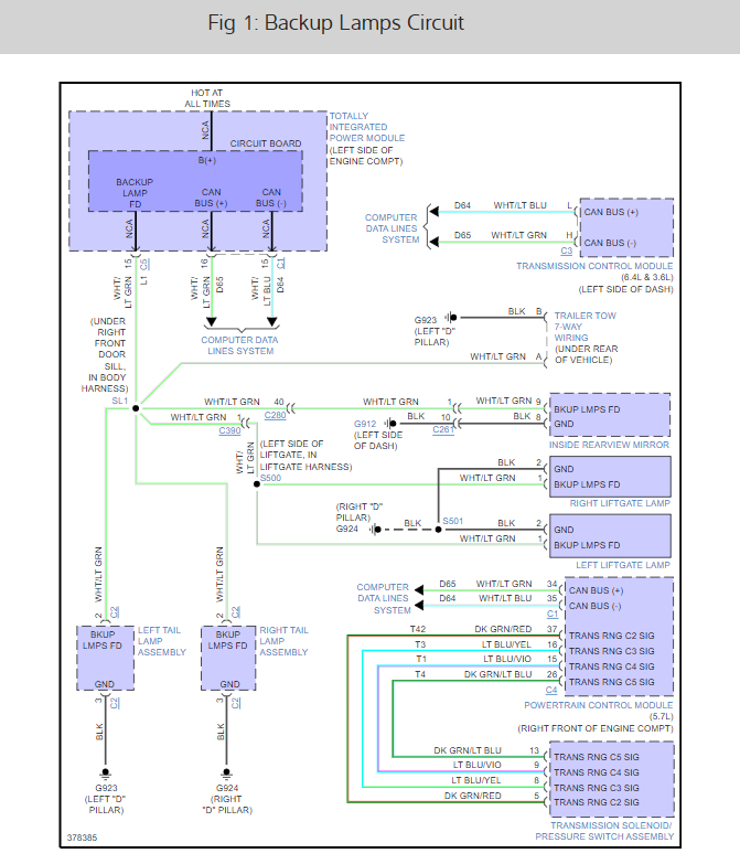

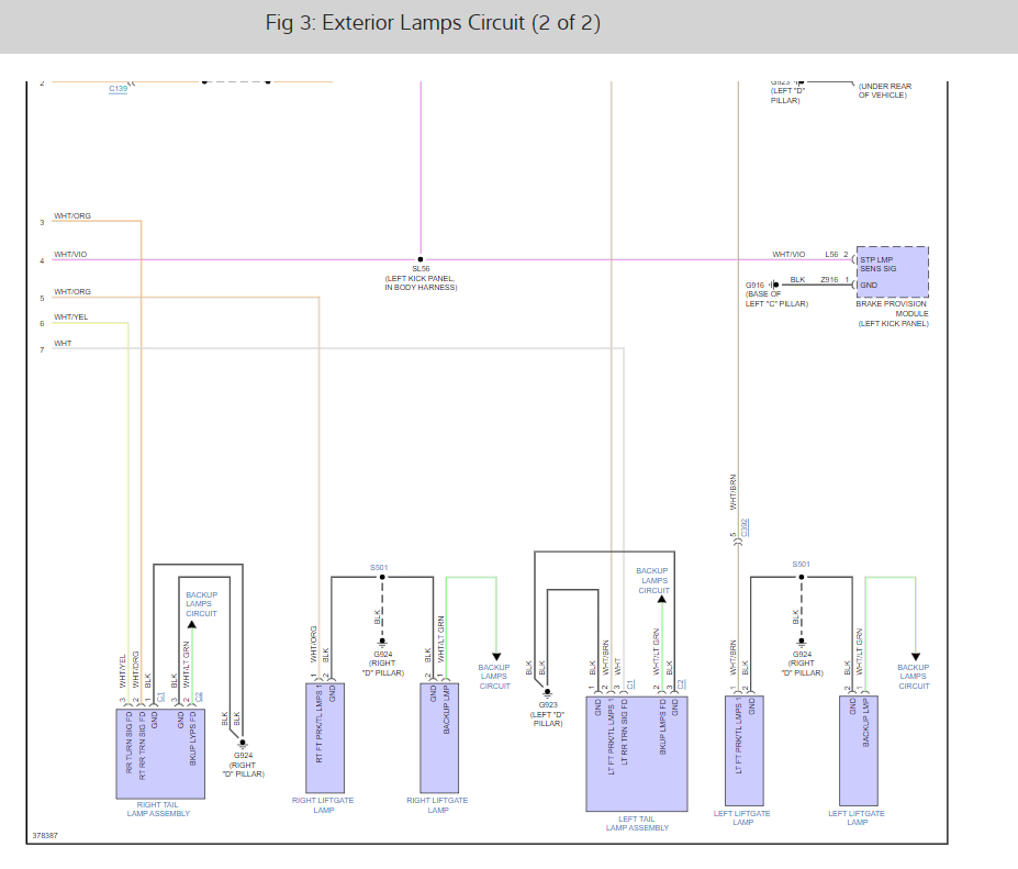

Sorry, I don't need rear window defogger pin, I need rear fog light pin location in TIPM.
Dec 30, 2022 at 4:40 AM
  • 55,694 POSTS
Sure, here are the wiring diagrams for the TIPM and the exterior lighting systems. Check out the images (below). Please let us know if you need anything else to get the problem fixed.
