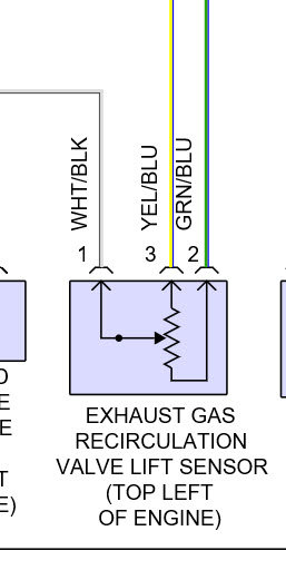

I mistakenly mixed the wiring from the car ECU to the EGR valve connector. I removed wires from the connector to fix a broken part and afterwards I do not remember where each of the wires goes into the connector. The wires are colored white/black stripe, green /blue stripe and yellow /blue stripe. Please help me out so do not put the wires in the wrong place.

see picture and look for numbers on connector to see where they go.

I do not under the image. I need a description of which wire goes into the EGR valve looking at the valve pins or connector facing me.

get another connector and put them to the chart there is a one, two and three in picture where wires go into connector.
