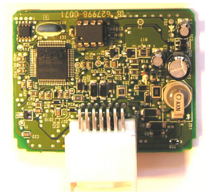

I have a client who has lost the key to his Duet. need help on how to get the chip from his engine control?
Aug 21, 2022 at 10:49 PM
BORIS K
  • 836 POSTS
This vehicle is also called Daihatsu Sirion on the world market
I can only advise you to program in a new key using CarProg
The immobiliser chip is in the immobiliser module under the steering column.
Usually marked "immobilizer" or "134.2khz"
Remove immobilizer box from vehicle and open box.
Locate 93C66 EEPROM. See image below
Remove EEPROM and read with CarProg using A4 or A5 adapter.
Follow instructions and program in new key
Cheers, Boris

As for your initial question I assumed you had experience and equipment to read EEPROMS and to program keys.
You will need to virginise the immobiliser EEPROM and then program key to immobilizer. Once done the ECM will synchronize with the immobilizer again.
My suggestion would be if you have no experience in this to best send it off to a specialist shop.
