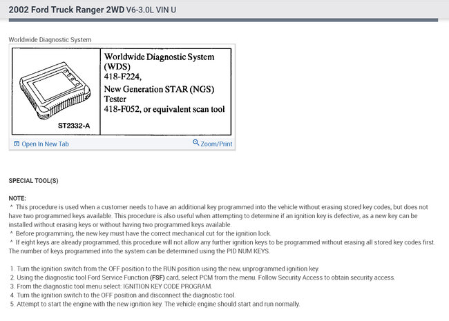

I lost my transporter key I went and buy an ignition lock with a anti-theft module use from a junk yard but in good condition . Do I need to program them?

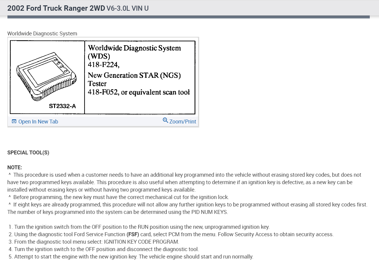

Yes, you do, the PATS will not allow the engine to start. Here are the instructions on how to do so in the images below.

1. Insert a programmed ignition key into the ignition lock cylinder and turn the ignition switch to RUN.
2. Using the diagnostic tool Ford Service Function (FSF) card, select PCM from the menu. Follow SECURITY ACCESS to obtain security access.
3. From the diagnostic tool menu, select SPARE KEY PROGRAMMING SWITCH selection to desired setting:

Check out the images (below). Please let us know if you need anything else to get the problem fixed.
