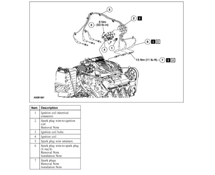

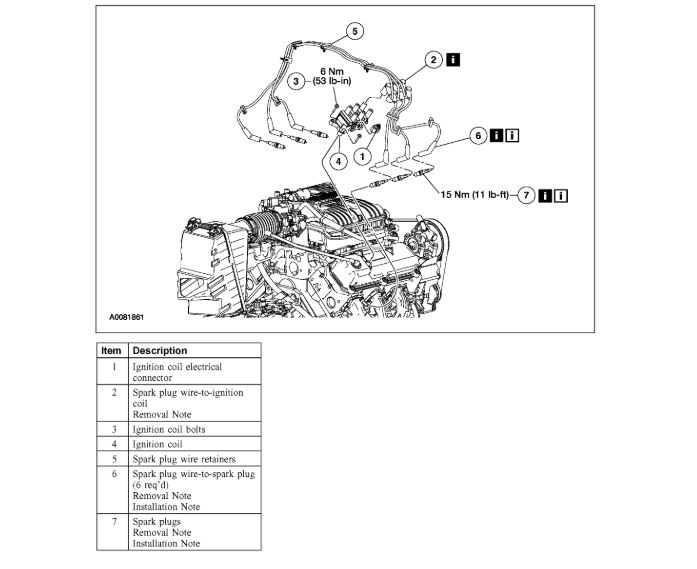

car loses power, spits, bucks, little backfire and just no get up and go. I would like to give it a tune up but 3 spark plugs are in the back. i can't see how to change them. Do you have any suggestions?

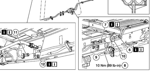

The first thing I would do with low power is filters. Change the fuel and air filter.
https://www.2carpros.com/articles/engine-has-low-power-output
https://www.2carpros.com/articles/how-to-change-a-fuel-filter
I would also check the fuel pressure as well. Low pressure from a bad fuel pump will cause this.

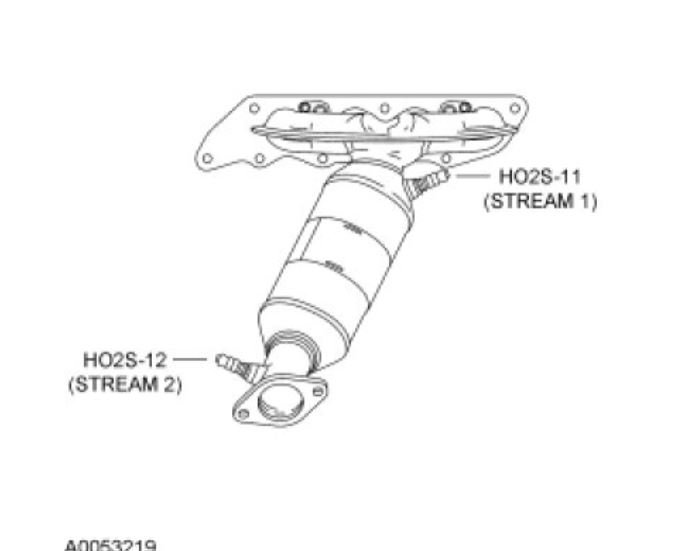

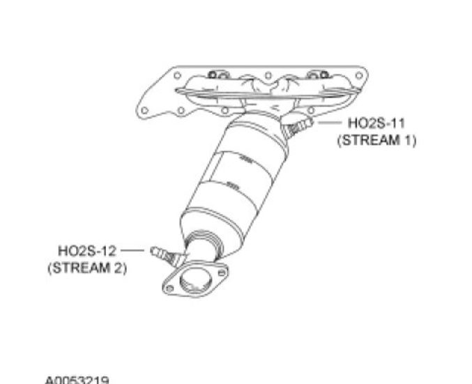

Check the catalytic converter. If is partially clogged,
https://www.2carpros.com/articles/catalytic-converter-replacement

The plugs are tight in the back but you can get them by coming in from the sides.
https://www.2carpros.com/articles/how-to-change-spark-plugs
