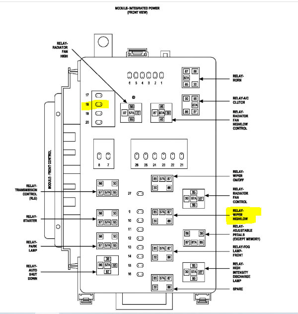

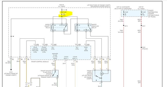

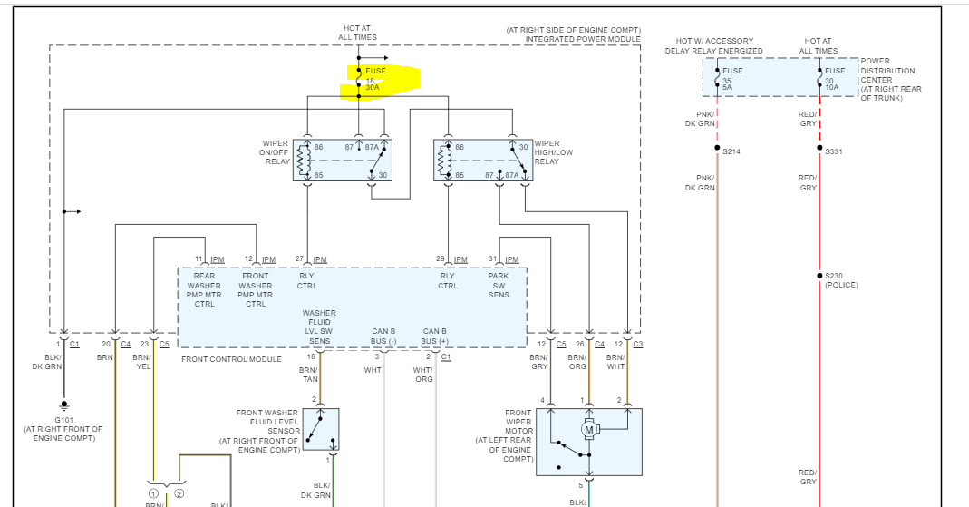

Since the wipers aren't working, locate fuse 18 in the under-hood fuse box. Note, this vehicle has an integrated power module. If you were working around the fuse box under the hood, make sure nothing came disconnected or was damaged as far as wiring.
Pic 2 shows the fuse to check and the wiper relay as well. If the fuse is good and has power to and from it, switch the relay with a different one in the box having the same part number.
Here are two links you may find helpful:
If the fuse is good, it is important to confirm there is power to and from it.
Let me know what you find.
